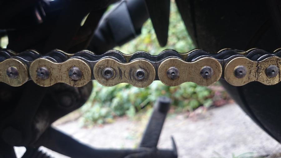

This is what mine looks like, there's a significant difference, but it's a secure rivet. I repeated the process, flaring it further to make sure, so I'm fairly confident in it. (unless someone says otherwise)
Cheers mate.
Mine don't look as wide in the middle but then again in using a 530 heavy duty.
I've flared  out the rivets to the same diameter as the engineered rivets on the rest of the chain

I fitted one of these chains to my Blackbird last year and according to DID's website the diameter of the flare on the soft link should fall between 0.224"-0.236". I used a decent vernier to measure mine....first one I bought was crap and gave inconsistent readings. Hope this helps.
Me again. Ive just looked at the conversation and the 5.8mm youve flared the link at comes in at 0.228" so you're within the range. Seems like jobs a good un fella.
Awwwh.. That's a great help mate. Honest. I binned the chain packaging a week before I fitted it... Got distracted!... So this really helps. I just riveted until it felt enough resistance , to me. Got lucky with 5.8 then.
