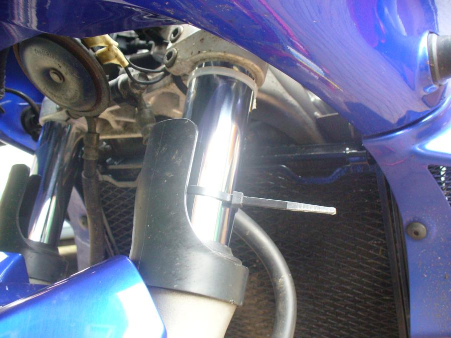

I decided to back off my damping to min and go out and work back to a comfort vs control compromise . I have 2 rings preload, pics with cable ties after ride showing fork travel, which was 98mm with no clearance problems , the sag shown is 25mm. Considering the forks are supposed to have 140mm travel this worries me a bit with only 10mm or so left before contact , but if I didnt know I could fit R1 or R6 legs I would be happy now. Felt no need to touch the damping although it would benefit from a bit more support when really hard on the brakes and after checking that travel I think I shall retreat a bit up the legs and further monitor things. Its the best Ive experienced so far and I dont believe it either with those settings but there you go. :rollin Is the 2cnd site member fitting the 5sl forks as standard or tweaked?
Good work, I had updated my standard front forks with Ravenrider's fork mod
http://www.yamahafz1oa.com/forum/showthr...mod&page=5 & it made some difference to the damping characteristics. Only problem is that it's non-reversible as you cut the lowest inch off the fork springs. Between that mod & raising the forks would prob'ly be a decent front-end improvement for under £20. Failing that, a pair of 9.0kg/mm springs would prob'ly firm the front up to your requirements I meant to say, I re-read the advert for my own ebay R6 forks & it appears my R6 forks are actually standard. I think they'd just had a service from 'Reactive Suspension', possibly fork seals & oil. Regarding the other set of 5SL forks, I think he did swipe them off ebay ;-) Be patient, they do appear regularly..... He's also installing heavier 0.95kg/mm springs before he fits them to the bike; indeed the R6's springs are borderline as although they are heavier than the Fazer's springs they lose that advantage when fitted to a bike some 100lbs heavier. Having said that, the spring / metal spacer combo makes it fairly easy to source different length fork springs from other 43mm forks ;-)

I have upgraded the forks with Blackbird springs, 0.95kg/mm as suggested by Kebab. I also added 10mml of 7.5W oil to each leg. The existing oil looked fine so I didn't see the point of changing it. Forks had only travelled 7k miles. I have set preload to two rings, compression and rebound is on standard settings. I have 20mm of travel left after braking hard from 70mph :b and riding faster than normal over some very uneven road including pot holes etc. The bike is already fitted with after market dogbones which raises the rear by about 20mm. The new forks are 25mm shorter than standard. The bike turns much quicker and appears to follow the turn much tighter than standard forks. I must admit my original forks have travelled 57k miles with two oil changes in that time. I propose to change settings to see if the ride improves but I am already more than happy. I would have paid more for a rebuild than this conversion cost me. Kebab has been fantastic, thanks mate. I would not have even attempted this without his support. He has sent me numerous emails, links and advice over the past week and I owe him a pint or three. I will provide an update after I have had a play.

I have found the handling benefits the same with my forks through 30mm, but have run out of clearance now, no clunk or metal to metal, there is a few mm of rubber seal to go before that . I did a couple of emergency type stops which found another 10 mm of travel so will run for a while at 20mm . Although the damping is noticably better the banging off ridges still gets to me. Has fitting the R6 forks improved or changed that behavior? I will probably do the Ravenrider mod next as its free and should help in the clearance issue.Will try a change to 2.5 wt oil at same time and see what that brings It will also give me opportunity to check how much oil I have in there, I know I increased the amount last time I changed it and that had sorted out the dive on braking but mislaid, forgotten, didnt take notes. Yes, a big thanks to Kebab and the others who post their experiences with mods, its made me enthusiastic about my Fazer again Doing the suspension mods, altering the stance and Ivanising the motor gives you a different bike, I wasnt sure if I would like riding position but after 3hrs of B roads I found it really good , my back appreciates the little cant forward . Looking forward to your update.

With my forks 24mm through yokes there is approx 124mm from top of fork leg, not top of seal, to the underside of bottom yoke. which is a bit short for the yamaha figure of 140mm travel. Doing my best maniac impersonation on some pretty rough roads gave me 98mm, doing an emergency stop saw 110mm and run out of clearance with forks raised 30mm, I just like to know what my bike is going to do in a violent stop under my conditions rather than find out the hard way . The way the nice roads without loads of traffic are now around here its really not too hard to get into the last third of travel What I'm trying to ask is when 5sl fitted to the Fazer do you still have all that 120mm travel available as the Fazer bottom yokes are approx 40mm further down the fork stanchions ? As to the clipping mod I was figuring an inch less spring to compress would gain a few mm or rather reduce travel, didnt really look how tightly the spring was coiled when it was out. Making the equivalent length with spacer would give same ride ht but is it not reducing the compressable length of suspension by whatever that inch of spring used to compress. Was hoping a 2" cut would reduce travel enough to run the forks at 30mm :lol What i do notice with the extra oil is much less weight transfer when rolling off and miss that dive into the corner feeling, the reduced airgap seems to give a lot more support also in the first third of travel. More fiddling, just hope the weather holds. I have managed over 600 sunny miles last couple of weeks, now on 4th tankfull and gritting my teeth every fill up :eek , robbing bastards. |
