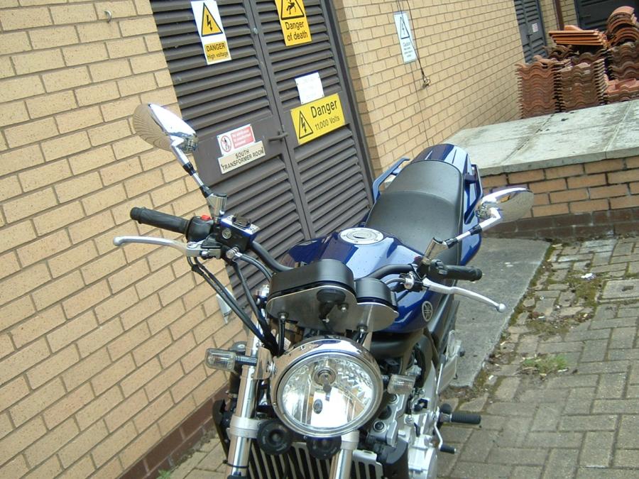

This is what I did. There's just enough room to fit, even on the standard OE bars.
[Image: 13052012191.jpg]

(30-09-13, 11:38 PM)Kosmic Kartman link Wrote: This is what I did. There's just enough room to fit, even on the standard OE bars.
A great lookin bike fucked up by two Neanderthal gt550 crap lookin mirrors. I gotta say thats the main reason "I WONT BE RIDIN YOUR BIKE" :-)
machined a new pivot bolt for the clutch and got a set of fz6 ,i think, mirrors as they have the correct left and right hand threads, but im sure that the street triple ones also fit
Got a Price of £20.00 for an fz8 mount,tried barend mirrors and didn't like them.I have a streetfighter short screen and the original mirrors look odd with it.

The mount from the FZ8 works beautifully.
The OEM part number from the states is - 1B3-82911-00-00
[Image: DSC_0116.jpg]
