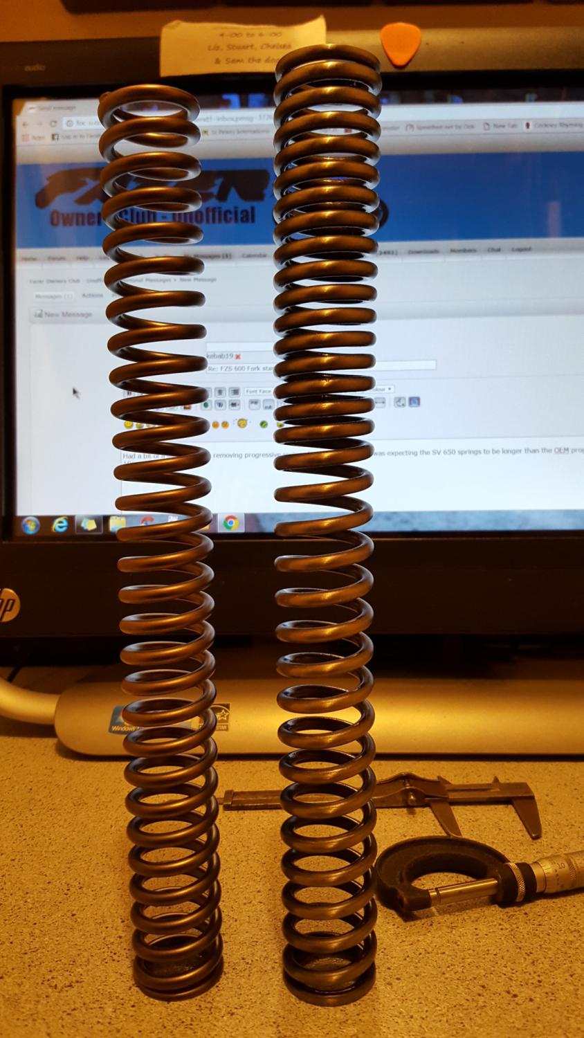

People say that the standard FZS Fazer 600 springs are progressive but in fact they are dual rate, there is a definite step/change in the spring coils, progressives would change spring rate slowly over its total length, hence progressive. The dual rate springs crash your wrists and jar you when compression reaches that point and also make the bikes handling a little unpredictable when riding around bumpy corners if you hit fast bumps because of that change in the spring rate both on compression and rebound.
True progressives would give you a smooth transition.

The picture in this post i have posted before when this sort of topic come up and i make no apologies for posting it again as it shows that the original Yamaha spring on right is not a true progressive spring, to the left of the Yammy spring is an Ohlins linear spring. Chalk and cheese when riding.
To be honest that is the way I would recommend anyone go, do the fork cartridge emulators if you have the finances, time and ability, but they are the extra bit of icing on the cake, the linear springs are the cake and 50% or more of the icing. And it such any easy job to do, the forks stay in the bike, just make sure the front wheel is off the ground (Centre stand with wooden blocking up under the down pipes) just slacken the top yoke pinch allen bolts a tad, make sure the pre-load adjusters are completely unwound then undo the top yoke 17mm cap nuts, go steady, a cloth over the top of the cap nut will help if the cap pops off when its undone, top disk washer out, spacer out hook the old spring out with a bit of wire coat hanger, reverse the procedure and the job is done, honestly its a couple of hours work at the very very most, and if you ever do it again it will take you half the time.

.jpg   7739528519250159496.jpg (Size: 68.46 KB / Downloads: 129)
