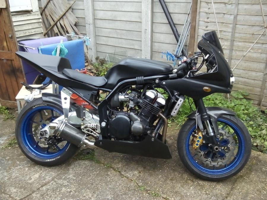

found this pic check the subframe mounting- will be saving this into my bits and pieces folder and pintrest
[Image: DSCF2560.jpg]

lol i put up a pic of wraiths bike -what are the odds

(05-09-17, 12:31 AM)wraith600 link Wrote: had an 03 R1 put on mine by a local bike builder as my welding is shit
There appears to be a good deal more going on there, including the rear Swingarm. Was that R1 also? Straight swap?
The rear now looks almost too "sporty" for the front Fazer (half) fairing? Very nicely finished.  Wink  8)

no MOT issues on mine all the suspension is from  a 2000 RSV MILLE . it  was not an easy job there are spacers on the frame that need removing + top hat spacers to machine for the swingarm and depending on your preference either the top or bottom shock mounts to modify as the MILLE shock is off set not central
