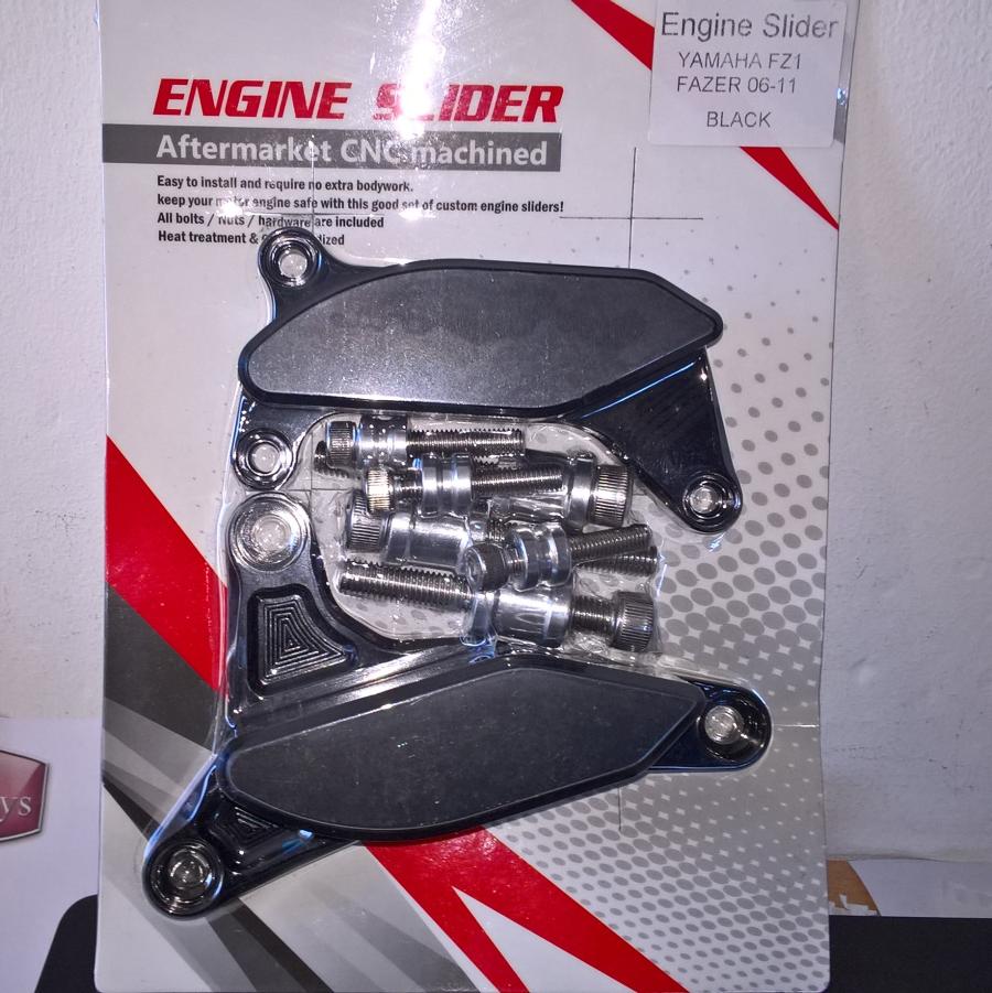

Thought i would try these
some engine case protectors, anyone else had them. ?
Makes sense mate, they look well thought out too
I have fitted them, fit good, just a bit more protection as I now do track days on it ,

These were them
http://www.ebay.co.uk/itm/221796790207?_...EBIDX%3AIT
The China man brought them on his bicycle , well it took about as long, 6 weeks
Certainly not a bad price. You'll have to stick up some pics when you've fitted them so we can see what they look like ?

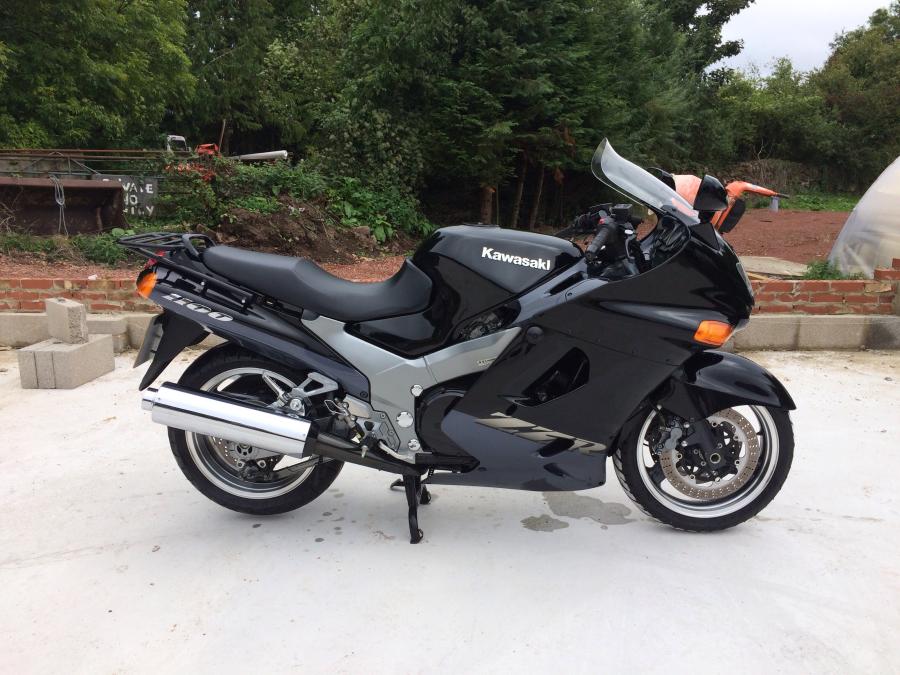

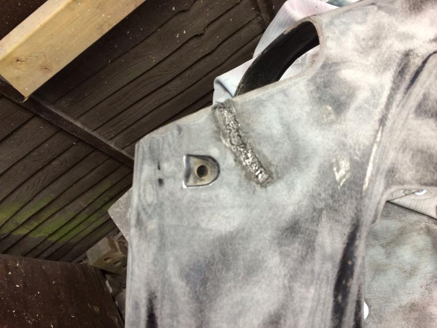

I'm with you Bill, a spill isn't always our fault, sometimes fate decidesit for us, anything that helps protect your pride and joy, especially if it's cheap, makes proper sense. I bought a mint zzr1100 with 6k on the clock that has never been dropped a few months ago as I want a useable modern classic. First thing I did once I'd got it running and cleaned up, serviced, new rubber, carbs overhauled, tank cleaned out etc was buy some cheap damaged bodywork that I sprayed in 2k black along with second hand exhaust cans so I can use it and put the nice bodywork on come summer. Full fairings make great engine protectors ;-)

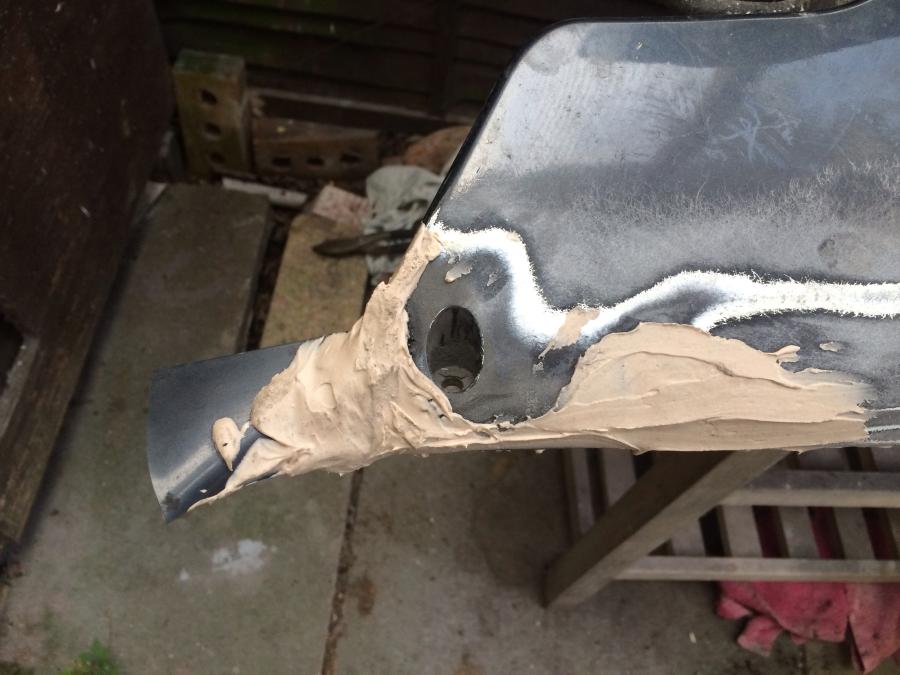

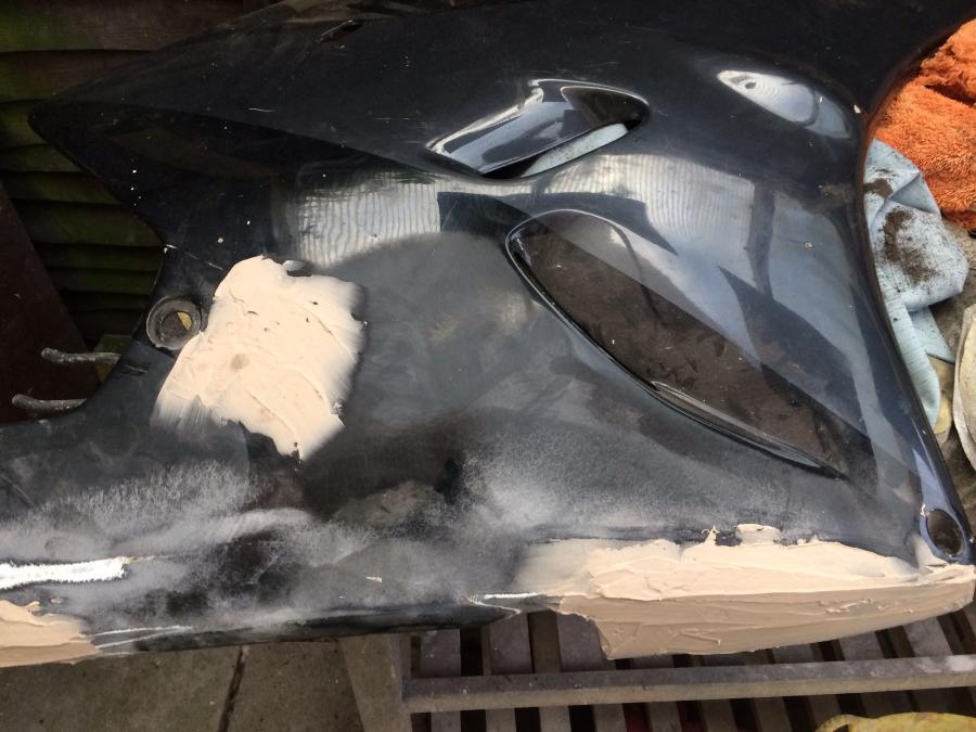

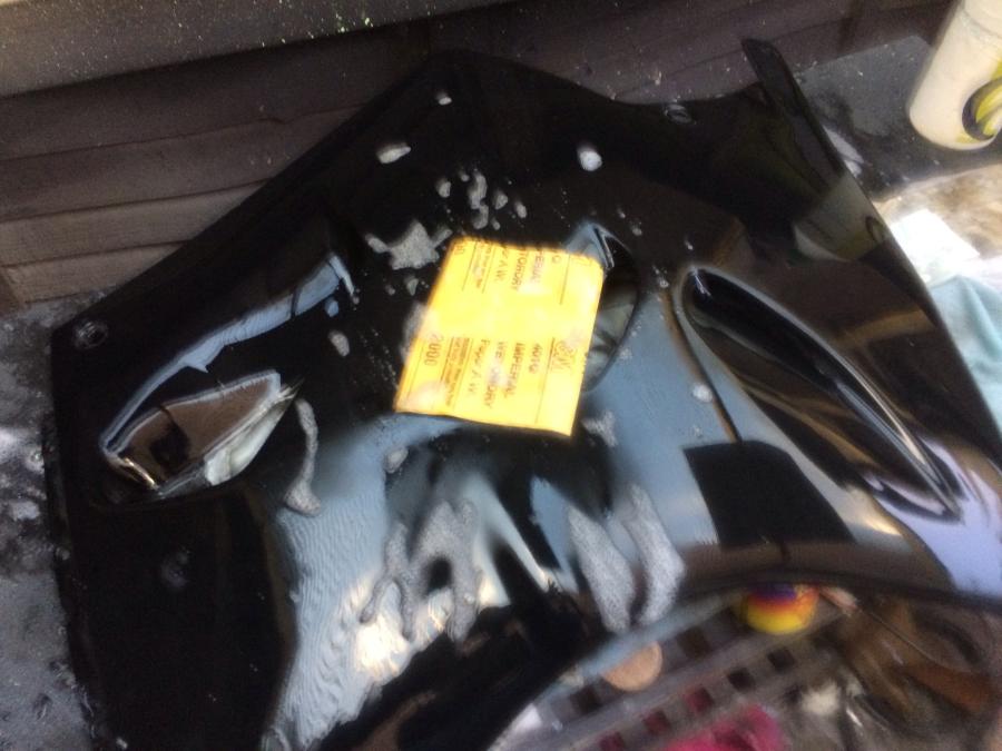

Shite Bodywork and cans came in at under £150 needed lots of filling and plastic welding( with a soldering gun lol)

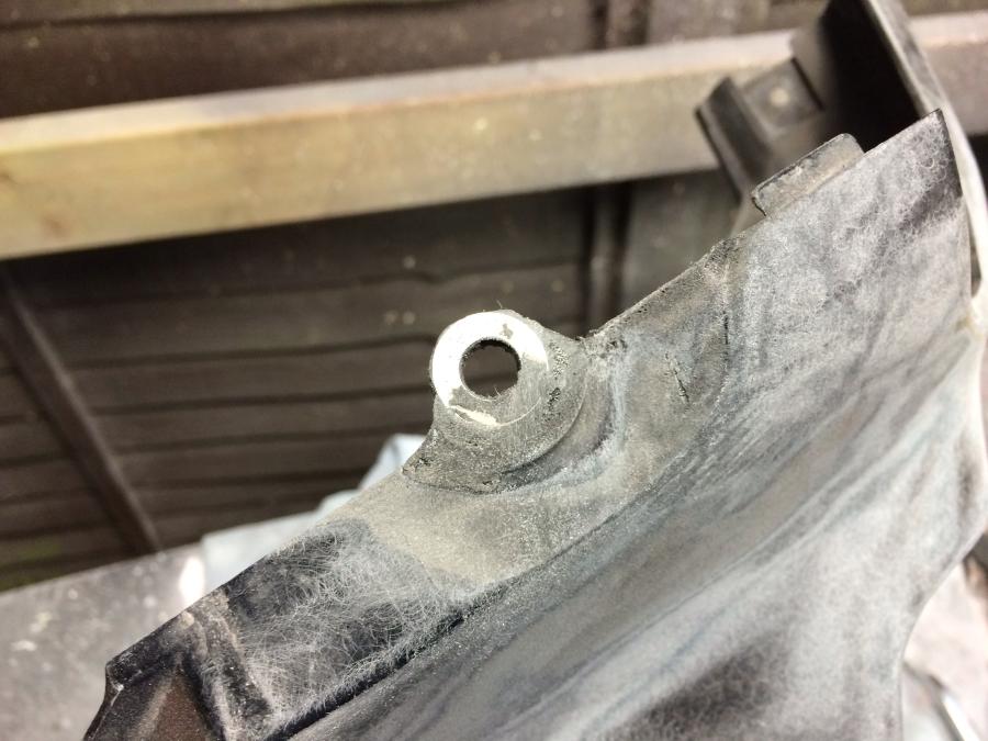

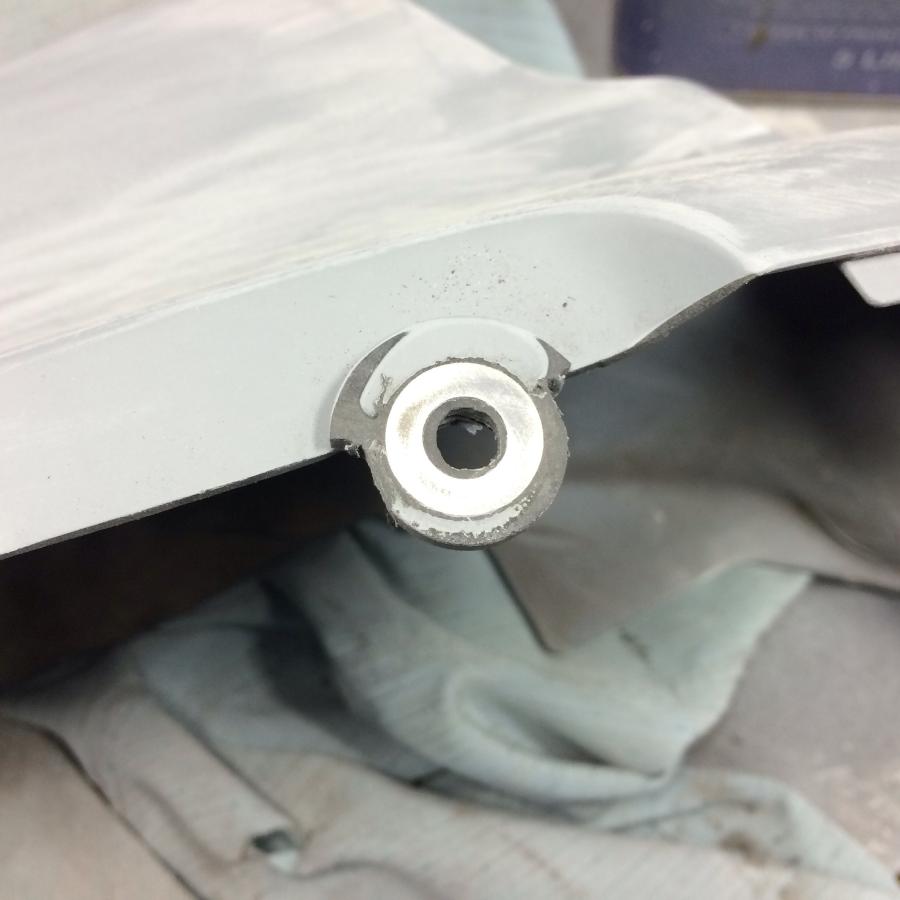

Ready for primer..had to melt washers in to replace broken lugs

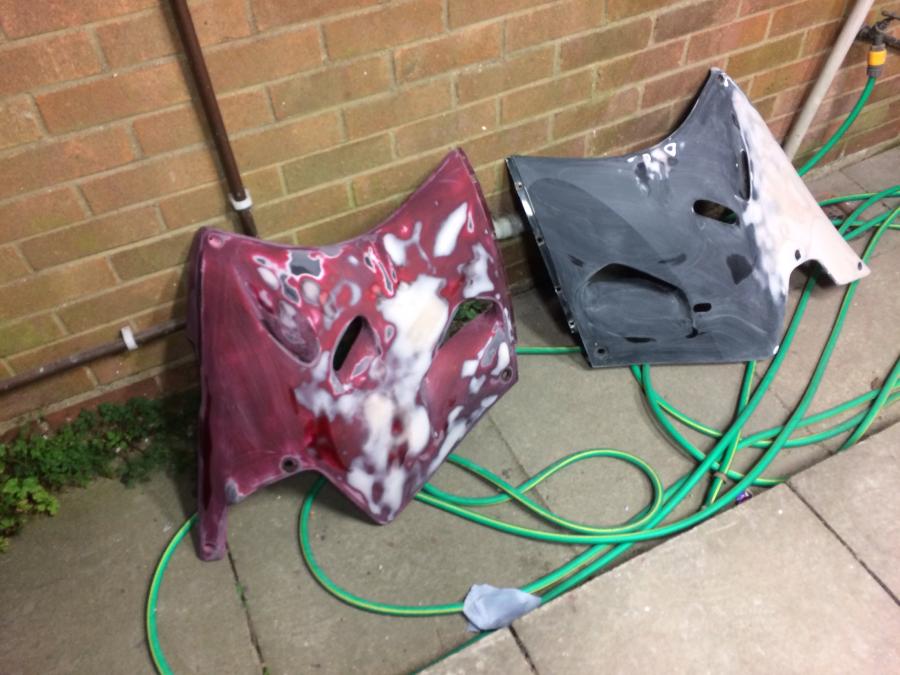

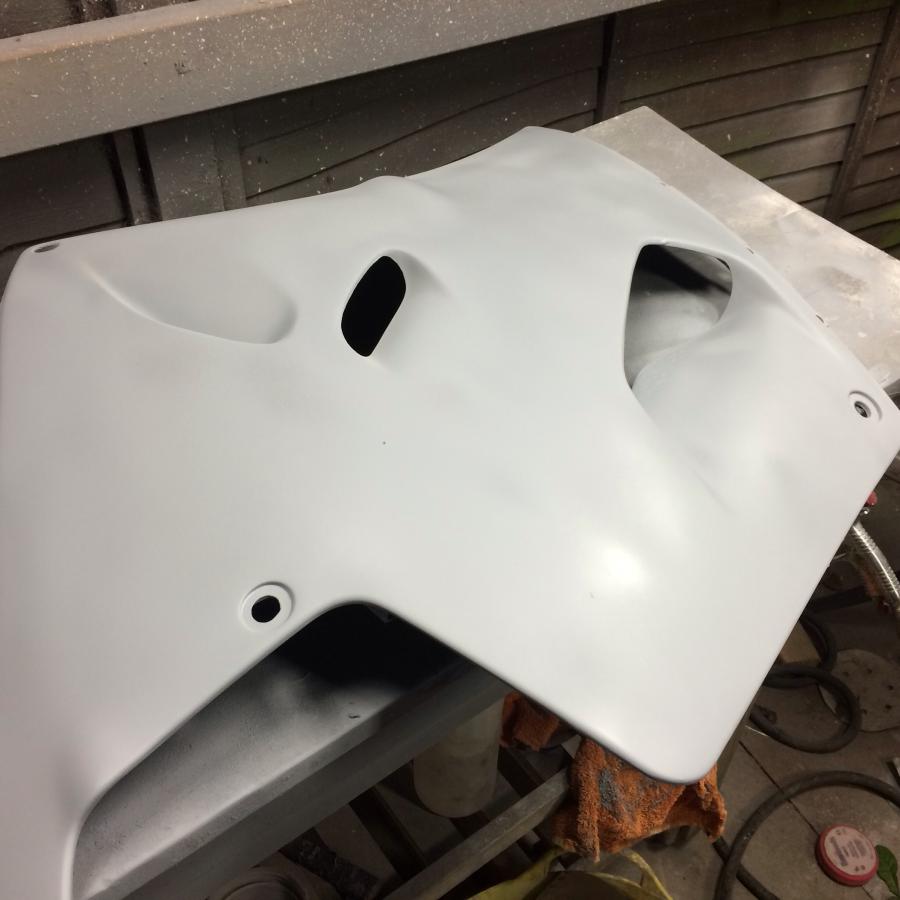

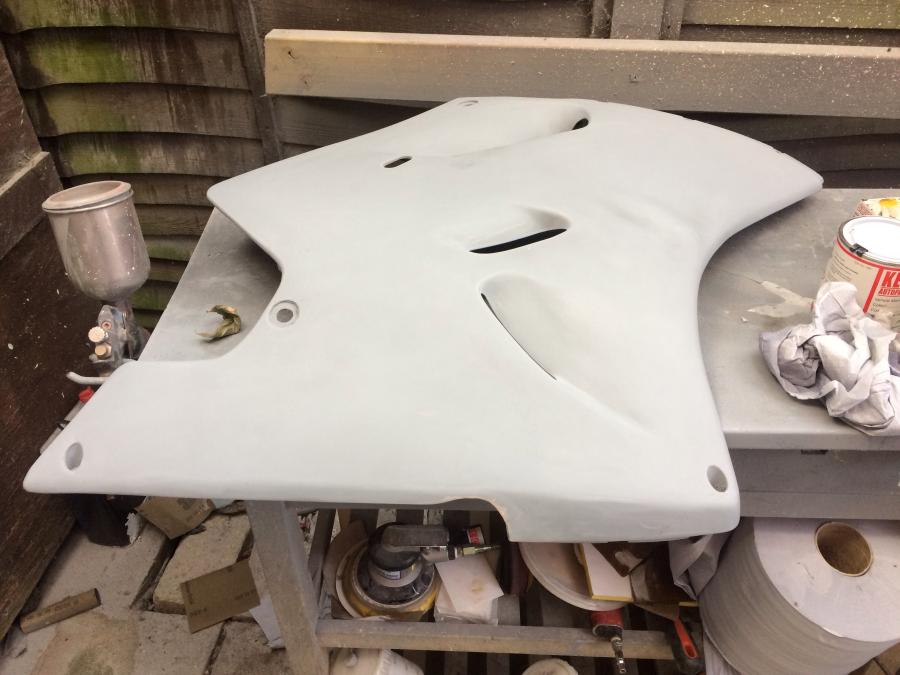

2k primer

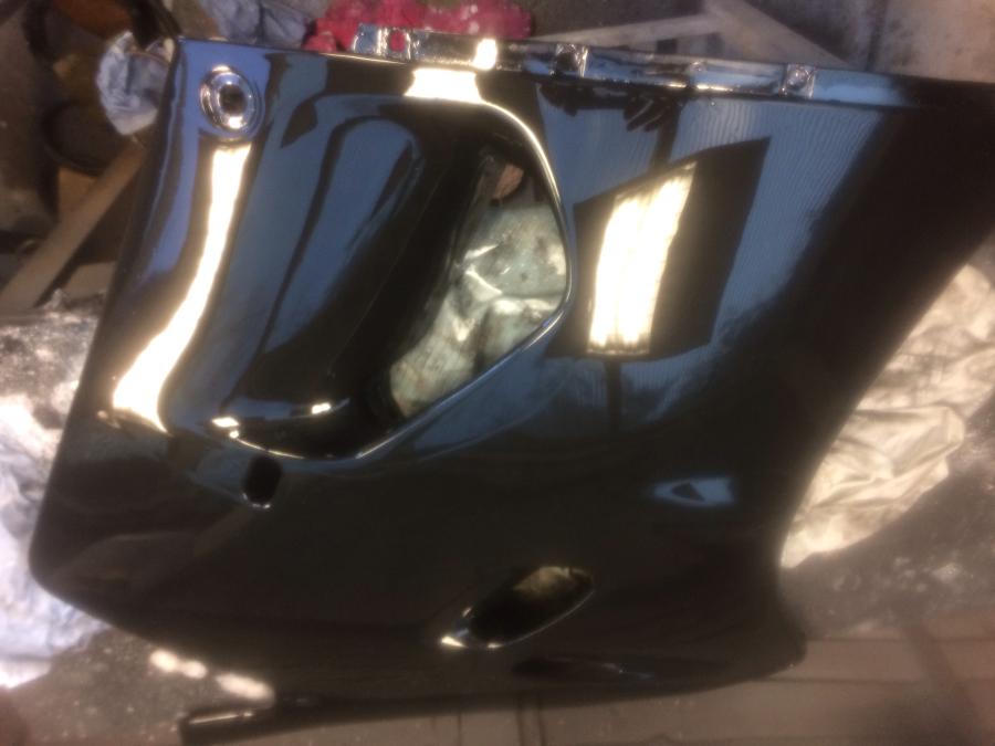

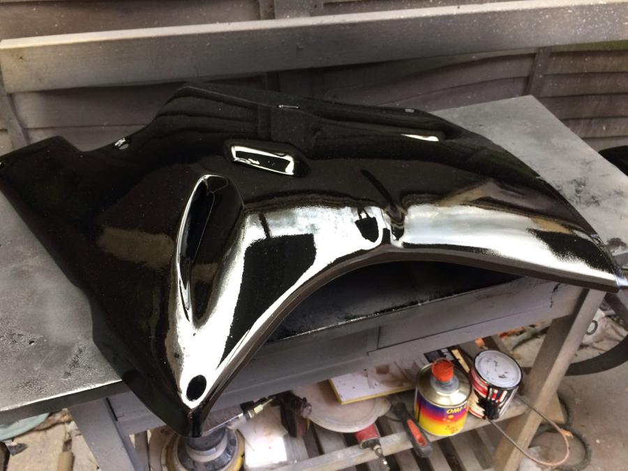

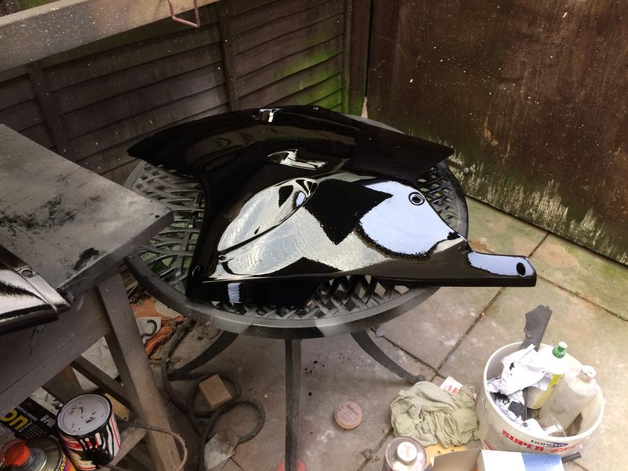

Flatted down then lots of coats of 2k gloss black, piled on deep and heavy, want it so no lacquer and if I get a scratch it will just polish out

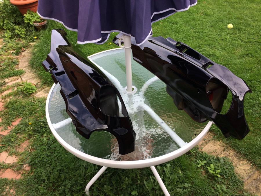

More foccing flat ting working from 240,400,600,800,1000,1200,1500,2000 ,2500 and finally polishing compound and a buffer..
Viva la crash panels..:-)
I actually far prefer the all black look to the original 90's shell suit it was wearing in truth :-)
Good job there Ogri.  :thumbup  Fantastic idea melting a washer to replace a broken lug.
Necessity is the mother of invention as they say mate, I didn't have a clue how to fix the missing lug til I was using the soldering iron to meld the cracked panels and thought" ah...I know what I'll do..";-) once I'd got a washer heated up and pressed into each side I filled it all with melted plastic from a bit of old abs fairing then shaped it with the dremel :-)
