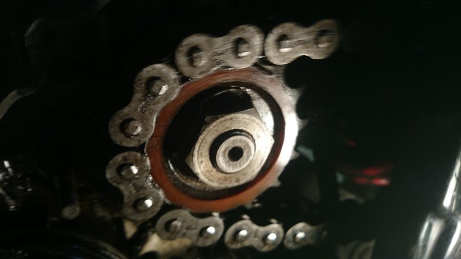

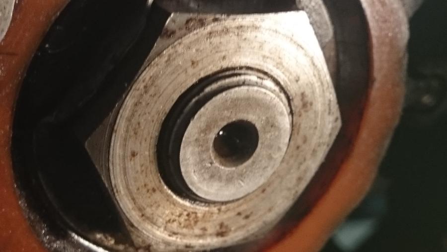

While on the same subject....
Do you think mines is ok?
Was doing a spot of cleaning as weather is rubbish as usual in Glasgow, not sure if this has been upgraded or not?
Cheers.
Colin
It is not upgraded.

It's quite simple, if you can see any threads at all it's the old 9mm nut.
You can see in the photo the new 12mm nut totally covers all of the threads and is flush with the end of the shaft.
