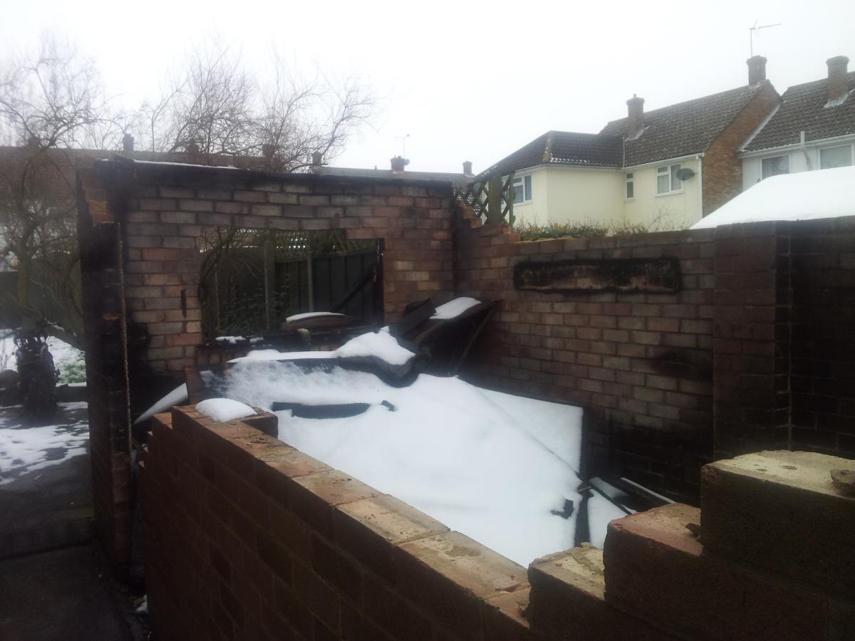

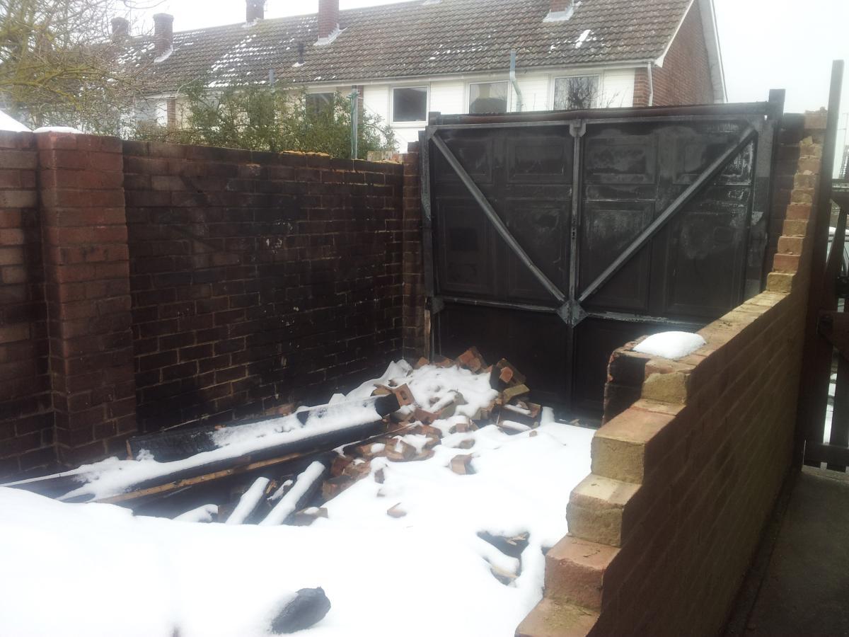

If I'd have tried this, this would have been the result...
