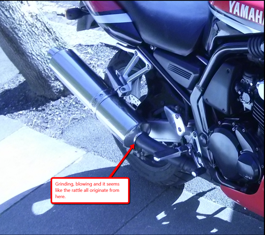

Hi, just a quick questions while were discussing the end can :-)
I seem to have a problem with mine, mine seems to blow where the black pipe goes into the steel end can. obviously there is no way of taking it apart and now parts that can be replaced, so just wondering whether my exhaust has come to the end of its life... or whether this is just the way its supposed to be?
When i start the bike and put my hand around where the gap is i can feel it blowing and when i clamp it shut i can feel slight pressure against my hand.
Hopefully someone can check this, even if its just from starting your own bike up and checking as I want to fix all the niggly little things wrong with mine.
thanks
For me at least - the slight blowing is normal, I would call it more of a leak than a blow with no noticeable noise. No rattle though
no rattle on mine either, when i give it a bit of throttle the blow/leak increases as you can imagine.
It might very well be normal and just me trying to find faults to fix, I did buy another exhaust off ebay but it was exactly the same, but the one i bought off ebay was in worse shape than mine.
Some people said it can be fixed with sealant of some sort, but if its just the way its meant to be then i might not bother.
Although as my engine vibrates a bit i wasnt sure if this would have relevance?
Ive had a couple of end cans go like this, first one I replaced, when that one went the same way I filled the gap with gumgum smoothed it round with my finger and when set rock hard I painted it, looks good and you would never know its been repaired....could be a MOT fail if its blowing...
Is that the same as fire gum?
I looked on halfords and it's made by the same company "holts"
Yeh, thats the stuff...its a bit messy but easy to wipe off before it sets, bit of masking tape around the pipe and can would help but
Remove it as soon as you have finished applying the gum, if you leave it untill it sets you'll never get it off.goes rock hard when set...

Ok just looked and I have TWO holes. The one on the funnel shape part and the one on the tube part furthest away from the seam
@ Silverlegacy. Yes, your can is on the way out.
The only good news is that if money's tight you can bodge it for a fair time. I used high temp silicone sealant to bung up the gap between the inner and outer bits where the pipe enters the can. It did get through a couple of MOTs that way, but the rattle got too irritating in the end.
