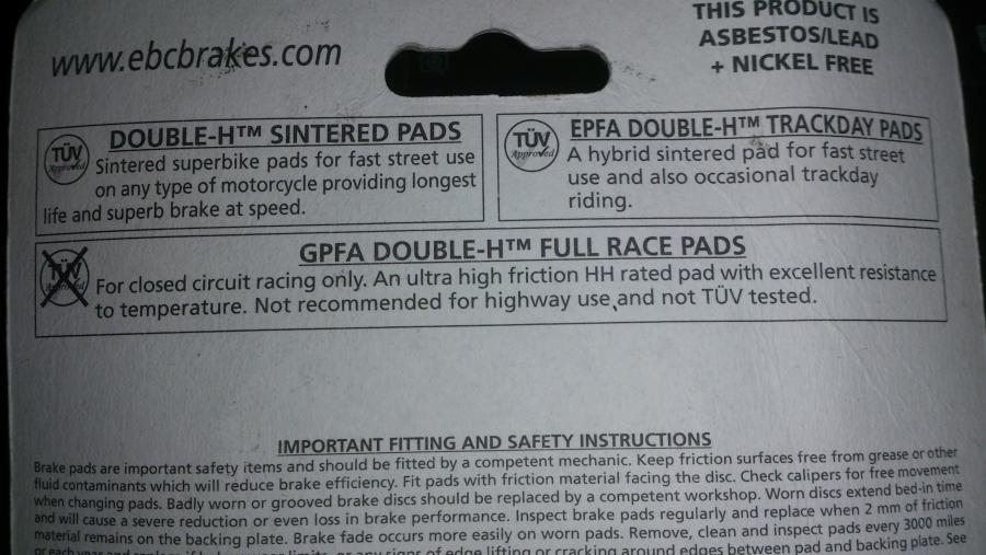

Quick q- pads hh okay for the road???
Hi all, I bought some EBC hh pads for the fazer but the packaging says for track usage - not approved for the road. Anyone who why? Do ya reckon they will be okay?

Paul, I'm looking at the packaging for EBC HH right now - it seems there are 3 types:-
HH Sintered Pads
HH Trackday Pads
HH Full Race Pads
The first two are TUV approved, the last isn't. Which type you have, is shown on the front of the packet. I've used in HH Sintered in both my bikes for years, and now in the charity bikes - no issues at all.

Thanks Andy, this is the eBay listing http://www.ebay.co.uk/itm/361069673757?_...EBIDX%3AIT - no mention if race only. FA252HH is the code.
Hey Rich - not done a thing with the 400 in ages  :o - got stuck getting the carbs off.
From Andy's info the bloody pads need to go back
FA252HH are the ones I have in front of me  - nowt wrong with the ones I have (I hope!!), but the packaging is slightly different from the pic in the ebay link. Where the link pic says "superbike, streetsport and race formula", mine says "Double-H Sintered Brakes". Does look like yours need to go back  :'(
Doh - looked at the packaging again -  I thought there was a handwritten  X across the third option meaning this pack is the option i have bought and it is the option which not for road use.  It's actually a very large printed X meaning if you have bought this option it's not for road use. The pack is the sintered hh so all good.
Ha - yeah that bit is kinda confusing, aint it, I had to look twice! Cool  :guitar
What like this?    :lol.    I only had to look after you mentioned it....  Stop it :b
