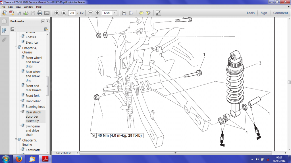

No dogbones on the FZ6. Look at page 249:
http://www.fazerclub.ru/manuals/FZ6/Yama...Manual.pdf
The shock attaches directly to the swingarm, it's direct, not trailing link (like our superior machines  Wink ). The only way to lower the bike to my knowledge would be to mod/replace the shock, or carry out extensive modification to the swingarm.

looks like you need to take the bottom off the shock and swap it for the bit exup linked to:
[Image: shocker_zpse9434da9.png]
I would say you probably need to strip the shock to do that, so you would need a spring compressor tool (or something else you can use as a substitute)
Ah, that makes sense now, thanks. Smile
The Deef's apprentice
that looks like a good solution  Wink .....as mick ,its a replacement, shorter ,bottom mount for the shock.....put the spring on the softest setting and slowly un-screw the bottom mount,i dont think you will need a compressor tool.......how old is the bilke,mileage ,condition etc and is the shock nice and clean ?
