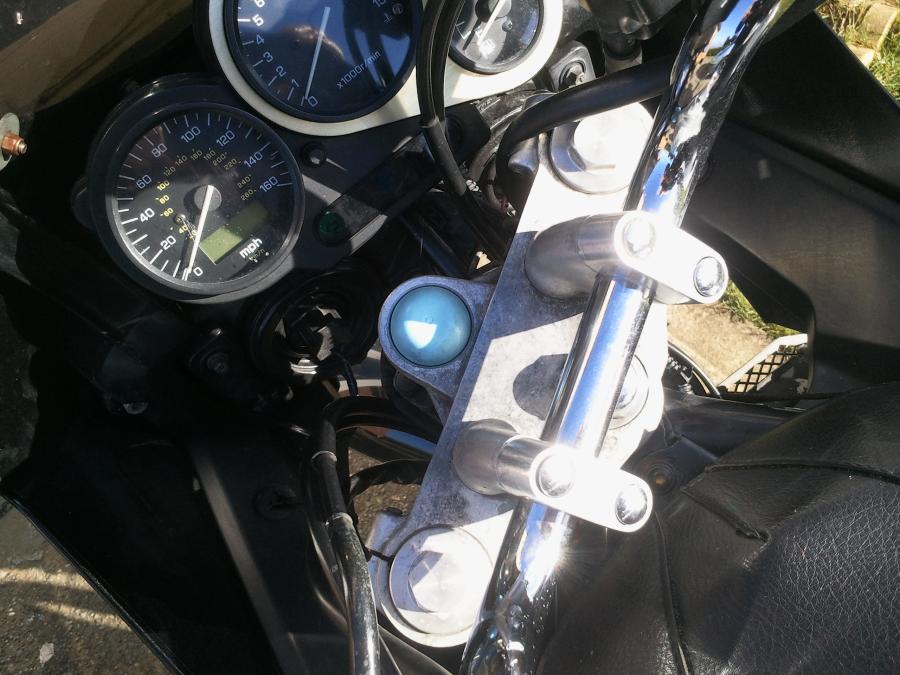

I used this cap of a deoderant cap when my ign switch was acting up. I also used some electric contact cleaner. It helps when washing the bike to keep the water and rain out as the bike is left outside at work most days in the rain. Had no problems for a good while.
