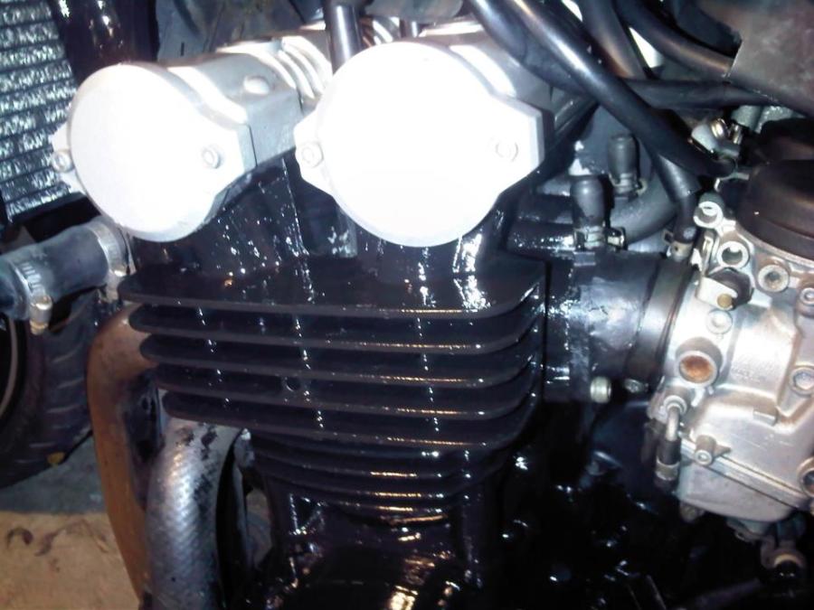

I got my engine painted using this...
http://www.ebay.co.uk/itm/Engine-Enamel-...19cc04f67d

Looks all right for a first attempt... Big Grin
Hope the paint stays put and doesn't turn to crap like all my attempts do!

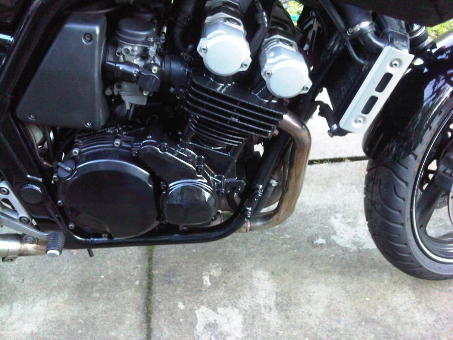

so you did not take the engine out off the frame before u paint it  :eek  and that alarm is sorry but crap i have one last year it in the bin know :lol
No hoist to get the engine out I'm afraid...It is better than it was, belive me. As far as the alarm goes, I have one on my CBF125, and it has worked without fault for 3 years. I have also fitted one to my CBR600, my friends Blade and my neighbours Yam XJ 1300. All working fine  Big Grin . Maybe you got a duff one, or fitted it incorrectly? What specific issue did you have with it?

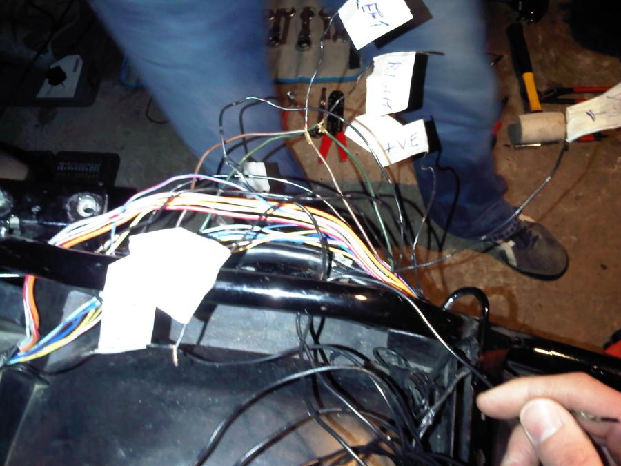

The old system is out now anyway, and I put the new one in yesterday, although I can only get the remote start working with the key in. Did the Fazer come with a factory fitted immobiliser as standard?
Fazerider - I have never painted an engine before, but my neighbour is in the powder coating type industry and gave me some pointers. The prep took a good 4 hours to get rid of all the crap. I then jet washed the engine with it running and let it dry. I used a hairdryer to finish it off then gave it a first coat after letting the engine cool down a bit (hold your hand on the fins for around 10 seconds, if you can do that without pain, its good  Wink . I let it dry for 24 hours as instructed, then ran the engine for 10 minutes to get rid of any condensation on the engine. Let it cool down...and gave it another coat. The paint is nice and thick and freshens the engine up. I would have liked to remove it to do the job, but there is only so much time/money to invest in a 12 y/o bike. Over all I am happy with the outcome, although maybe some people may not be. Glad you, like me, enjoy the benefit of a little head on the hands during the winter. I found on my CBF that the addition of hand guards, it is even better. The guards break the wind and keep the worst of the rain and snow off, allowing a litter vortex of heated goodnes for my hands to get a proper sweat going, which is always nice  Big Grin

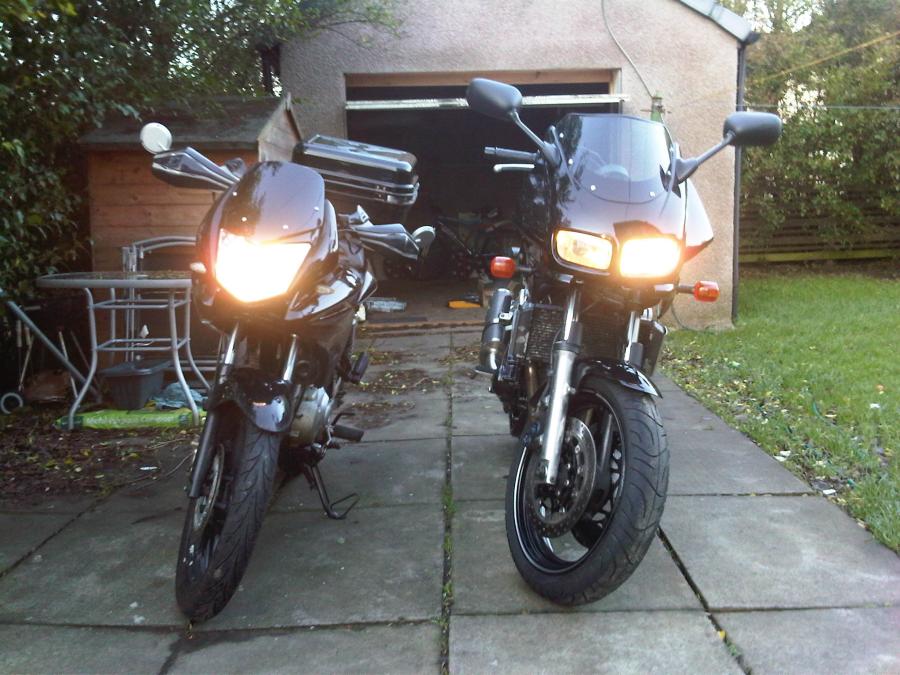

CBF, With said hand guards.
Must admit I've not tried painting the engine, but my efforts at halting the rust on the frame have had no success. :'(
I've been thinking of fitting handguards to stop the worst of the windblast on the motorway, which ones did you get?
