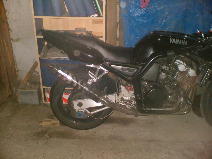

The FZS1000 Gen1 rear caliper is the the only one that fits the FZS600.
Like stated its only a small amount of filling to the hanger and it fits fine.
Works great, looks great especially with the FZS1000 torque arm.
all i got now are some photos as ive changed the hole back end to a mille set up  Wink [img]http://www.foc-u.co.uk/smf/<a href="http://s1124.photobucket.com/albums/l568/wraith600/?action-view&amp;current=DSC00003.jpg" target="_blank"><img src="http://i1124.photobucket.com/albums/l568/wraith600/DSC00003.jpg" border="0" alt="stock swinger performance racing parts pipe"></a>[/img][img]http://www.foc-u.co.uk/smf/<a href="http://s1124.photobucket.com/albums/l568/wraith600/?action-view&amp;current=Absol000.jpg" target="_blank"><img src="http://i1124.photobucket.com/albums/l568/wraith600/Absol000.jpg" border="0" alt="stock swinger micron"></a>[/img]
.jpg   DSC00003.JPG (Size: 16.13 KB / Downloads: 31)
