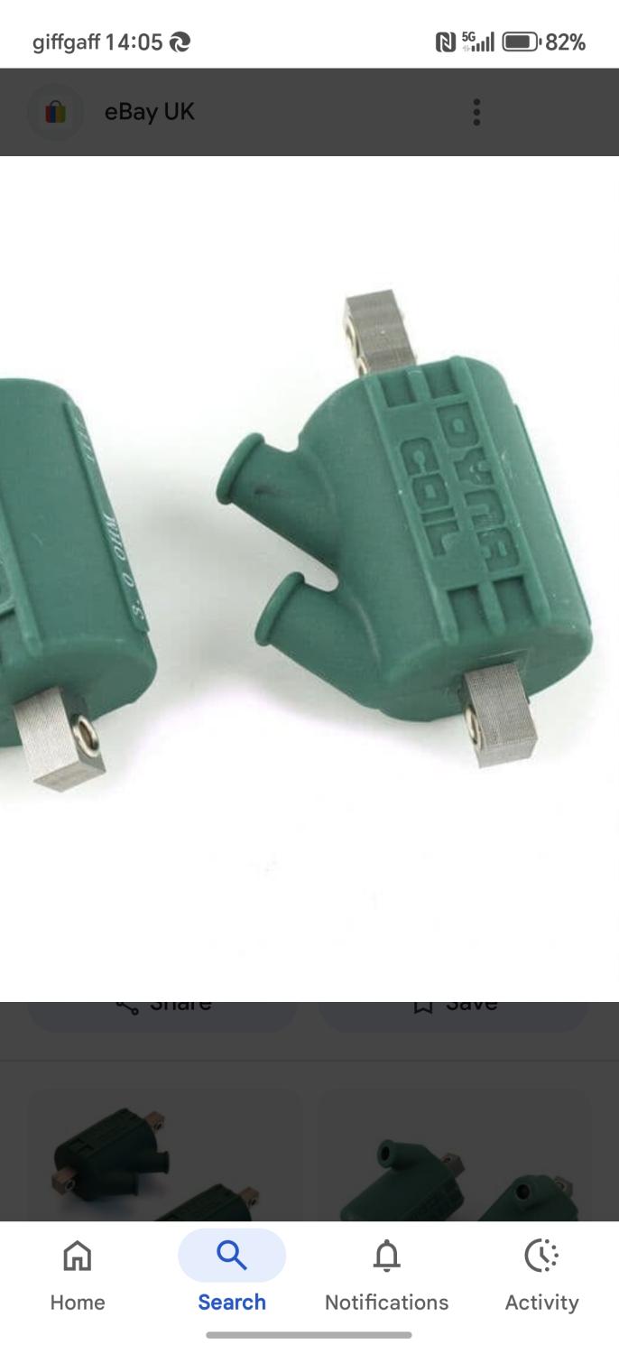

Hi Does anyone know if it's ok to use 3ohm dynatek coils on an fzs1000 ? TIA
I assume those Dyna coils are single "coil-on-plug" types?
Well, it becomes marginal. The original coils have 2.2 ohms and are dual/wasted-spark type. You would have to take 2 Dynas in parallel as replacement. That lowers the effective ohmic value down to 1.5 ohm and gives about 30% increase in current. That's a lot of additional load to the output driver..

They are twin coils Dyna Dc1-1 ?
Ah okay, even better. The ECU-box is electrically save with those.
Next questiosn (for neerds) would be the inductance value. That also defines how much energy can be stored for the spark. I assume it's in the same ballpark as the original.
Is it to replace a bad original coil? Or do you aim for a better spark with more energy?
If the later then you should also consider to improve the overall power cabeling. Some significant voltage gets lost there.
(9 hours ago)schlumpf Wrote: Ah okay, even better. The ECU-box is electrically save with those.
Yeah to replace faulty originals, second hand ones are obviously showing there age now & don't want to take a chance. The new Chinese ones seem even worse !! I will look into the inductance value, my main concern with them being 3ohm would they be ok with the cdi unit.
