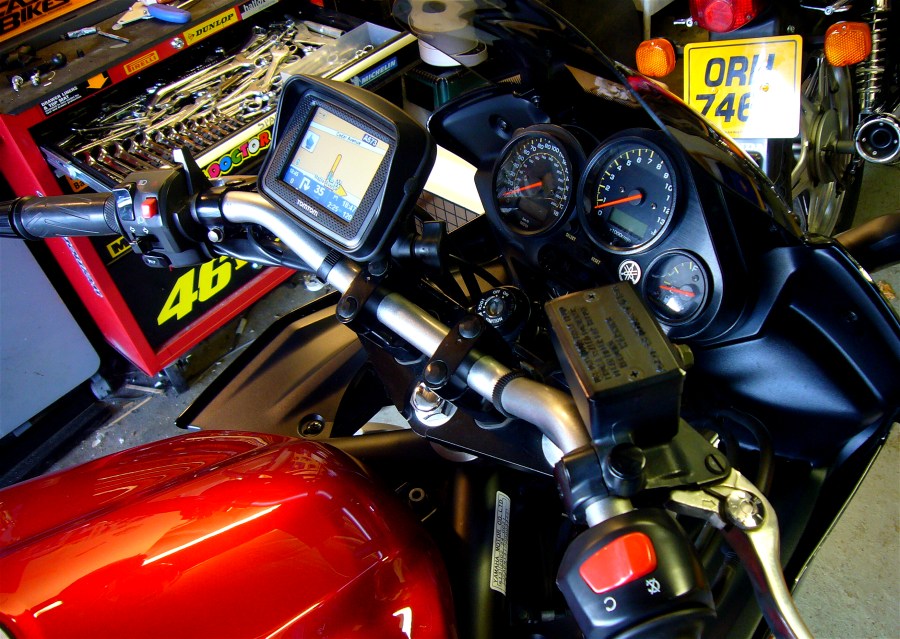

Fitted my SatNav mount tonight. Simply drilled a hole in the yoke and fitted the ramball mount shown below. With the SatNav fitted, 0-20mph is obscured by the device, but there's a true speedo reading on the TomTom anyway.

Looks allright McQ, my Zumo 550 fits with the ram mount u-clamped to the bars in nearly the same position, but it covers even more of the speedo. Tend to read the Sat Nav speed more anyway.  I only use the sat nav when I'm touring which means I use a tank bag too.  My Sat Nav's okay for a tank bag in situ - you happy the Tom will clear a bag okay?

I used the bar mount,  where you clamp it to the handlebars.
I put it centrally on the bars, and it looked okay, had to go around the mount to get to the keys, but no major drama. Only thing I found was that it was too low without obscuring the clocks, and as such I would have to physically move my head to look at the screen.
I have now positioned it so that the arm etc comes up behind the clocks and the sat nav actaully sits above the clocks. This has only been possible after buying a bubble type screen to give the extra room. It now saves me physically moving my head to see it, just a downward glance now gives me full vision of the screen and the clocks.
