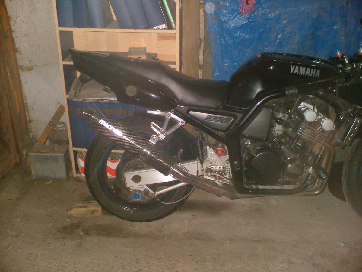

it's wrong they will fit you just need to file a small section of the mount bracket off and i mean a small amount it will not affect the strength of the bracket i ran one on the back of my fazer for over 6 years  Wink

I depends which blue spot caliper it has to be from a fazer thou, which again is not the same as the R1 R6 or XJR so as you say it needs a slight amout removing, but care must be taken on which blue spot you buy

Deefer says my post should give the right info, so people dont assume that "blue dot" will fit regardless

The FZS1000 Gen1 rear caliper is the the only one that fits the FZS600.
Like stated its only a small amount of filling to the hanger and it fits fine.
Works great, looks great especially with the FZS1000 torque arm.
all i got now are some photos as ive changed the hole back end to a mille set up  Wink [img]http://www.foc-u.co.uk/smf/<a href="http://s1124.photobucket.com/albums/l568/wraith600/?action-view&amp;current=DSC00003.jpg" target="_blank"><img src="http://i1124.photobucket.com/albums/l568/wraith600/DSC00003.jpg" border="0" alt="stock swinger performance racing parts pipe"></a>[/img][img]http://www.foc-u.co.uk/smf/<a href="http://s1124.photobucket.com/albums/l568/wraith600/?action-view&amp;current=Absol000.jpg" target="_blank"><img src="http://i1124.photobucket.com/albums/l568/wraith600/Absol000.jpg" border="0" alt="stock swinger micron"></a>[/img]
