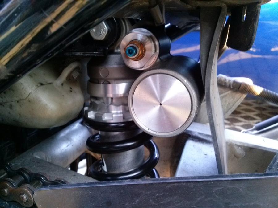

Ok, so I went with the proper version of shock with the adjusters together. Managed to get one with 3600 kms on the clock from german ebay for only €70. Great price, huh?
Shocks swapped yesterday night. All is well except that I can't seem to find an affordable replacement spring here in Hungary. Hyperpro, Wilbers and Öhlins are available but with extreme prices. Faulkners' is £31 which would be ok, but postage is £39... :rollin
I am 85 kg without gear and often carry passenger and sidecases. At preload pos 5 rear sag is 13 mm higher than the original one with the same preload (both without gear etc). I am considering buying a 750 lbs/in (131 N/mm) spring. What do you think?
Thank you all for sharing your experiences. Especially thanks kebab for the original post and DCurzon for the top-hat spacer idea and measurements. Exact fit.

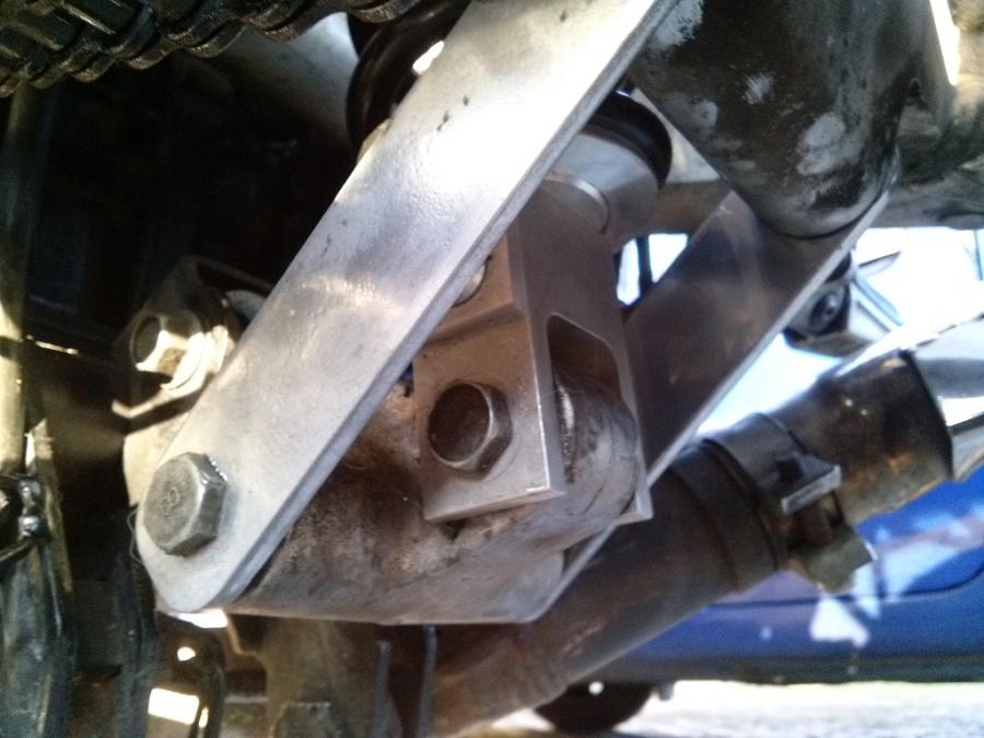

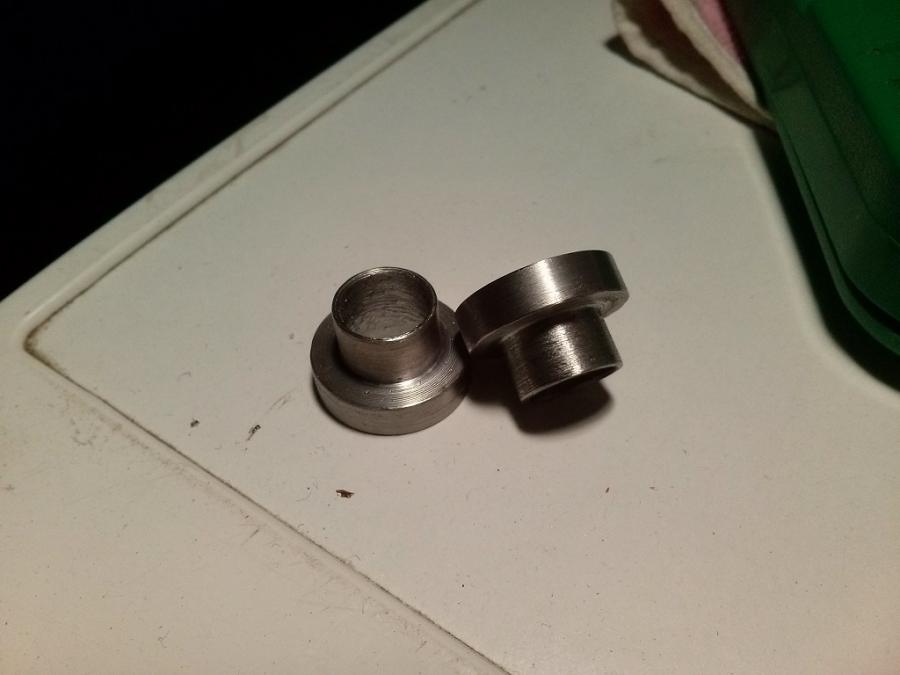

Spacers done by my brother, waiting for dogbones and spring spacer. And the spring Smile
[Image: rOoVpun.png]
[Image: 613563.png]

Also for getting some top hats fabricated.
Also cheers to Kebab as he has managed to find his original alloy preload spacer plus some suitable top bolts.So all i need now is some custom dog bones and i have a full fzs600 to R6 shock conversion kit.If anyone fancies buying the other shock we can probably figure something out with getting a copy of the spacer made up. 8)
Im not entirely sure how all the bits work but im sure itll make sense once i have them all together. Theres allot of info on this thread ill go through.
