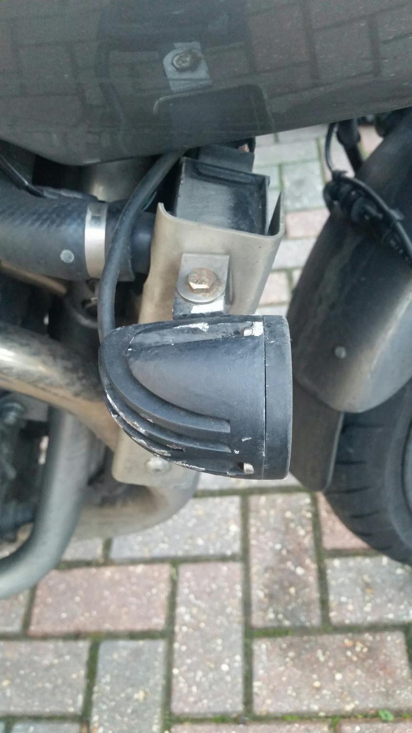

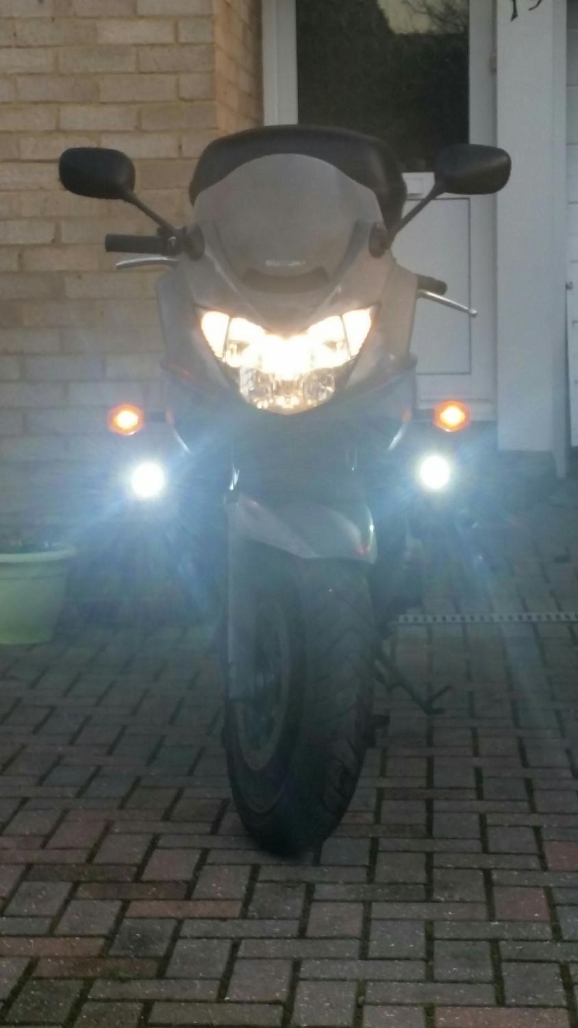

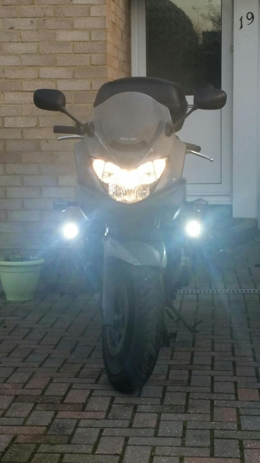

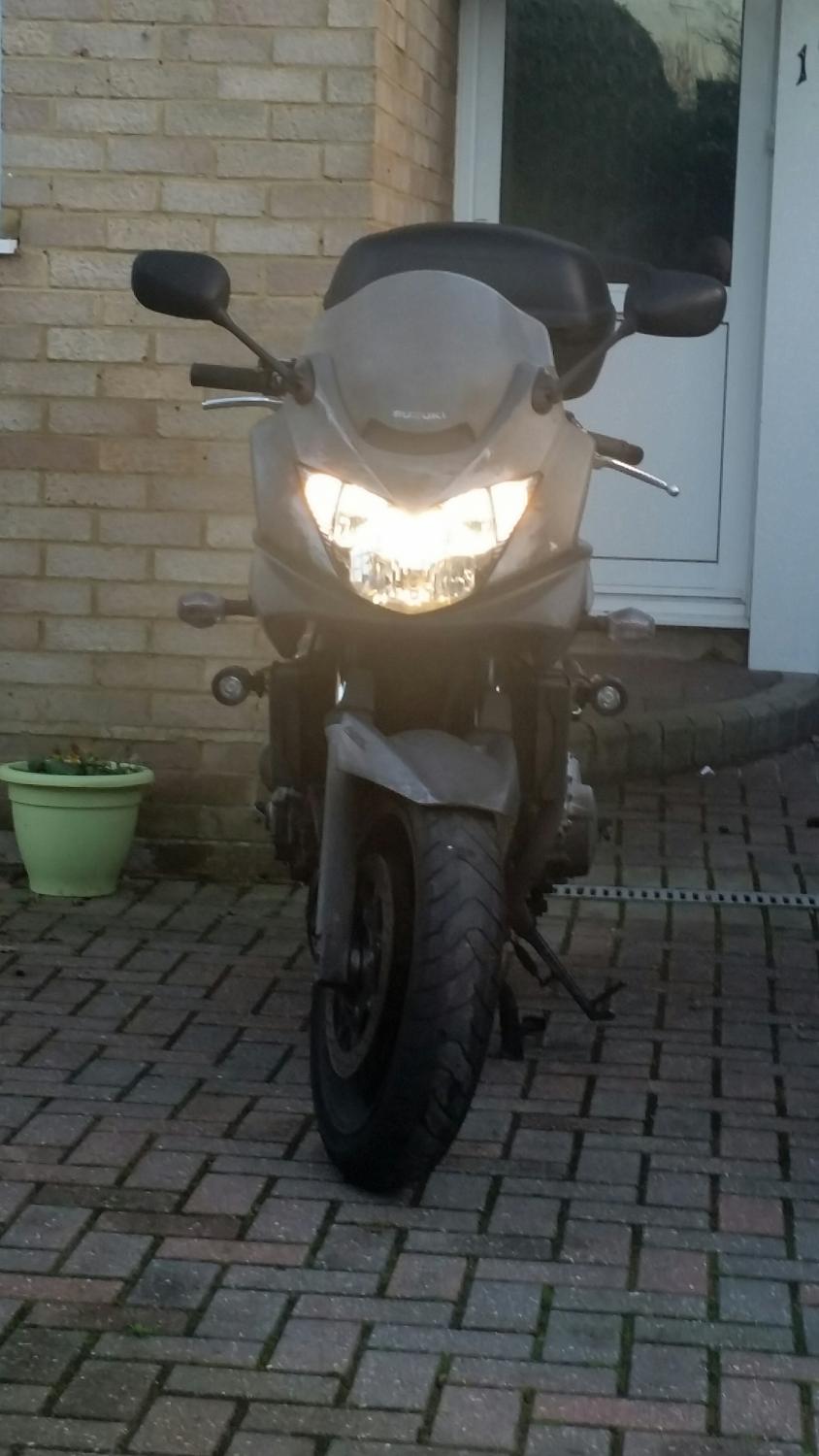

Hiya fella, sorry for the delay........booze etc  :lol . Wired these the same as Slappy - Quote "I tapped into sidelight circuit , put an inline 3 amp fuse, not sure if it was necessary then a switch  to turn them on separately, But if I forget to switch them off they go off  when I switch ignition off anyway."
1st pic is mount the same as Fazer on the top side mount of rad side plate. 2nd pic headlight only. 3rd with spots and 4th with spots and hazards on so you can see how much the indicators are not affected.
]As said before, the pics really don'y do them any justice - especially as it wasn't dark at the time of taking pics.

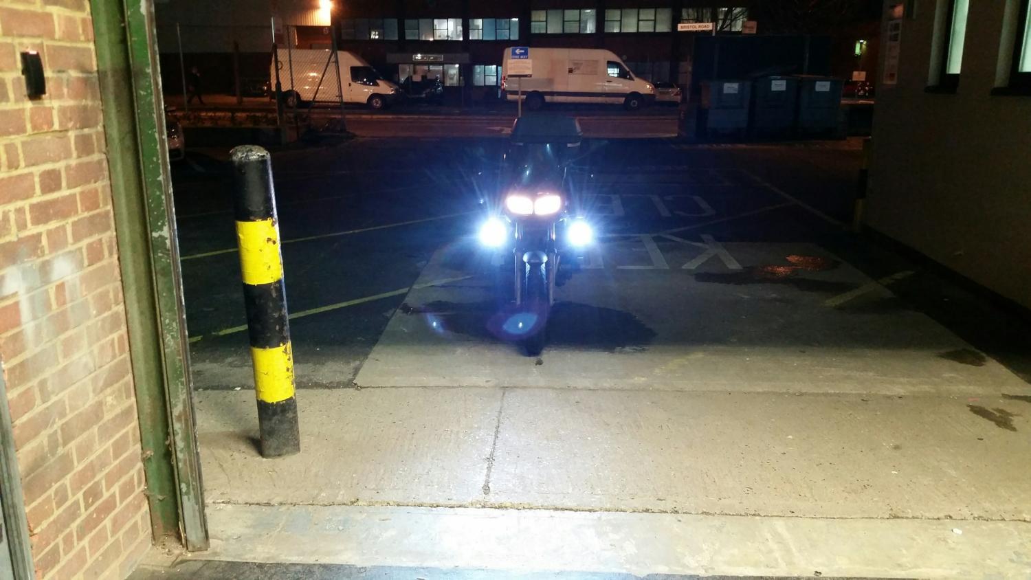

First time out tonight in the dark with the new lights.
Makes a big difference, i've got them aiming right down, giving me about 35 feet of extra light on the floor but they're not in anyone's eyes at all in oncoming vehicles.
I went down a few dark side roads and switched them off then on again and the difference was very noticeable compared to just the headlights, even though i've got Phillips Xtreme bulbs in the headlights the new sidelights gave off a much whiter and brighter light on the floor. But even in daylight they are really bright as well.
Well worth doing, job's a good'un.  :thumbup
