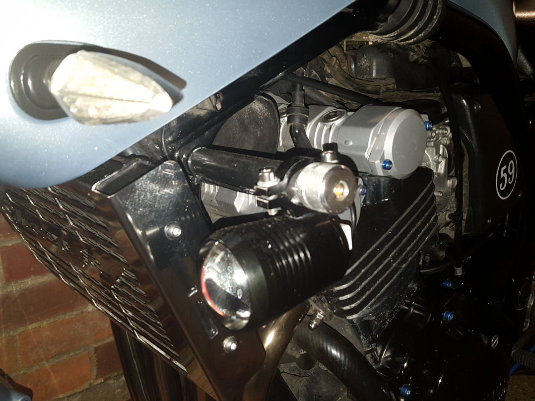

I've bought and fitted these to my boxeye and they make a hell of a diffence. Will get a pic up asap.
http://www.ebay.co.uk/itm/2X-10W-Cree-LE...SwbYZXf0sF
Used a fuse tap to link into a switched circuit on the bike http://www.ebay.co.uk/itm/2pc-Add-A-Circ...Sw3ydV5lbw
I've bolted them straight to the top bolt of the radiator side plate. I know what you're thinking but a damaged rad is the least of my worries if the bike goes down hard.

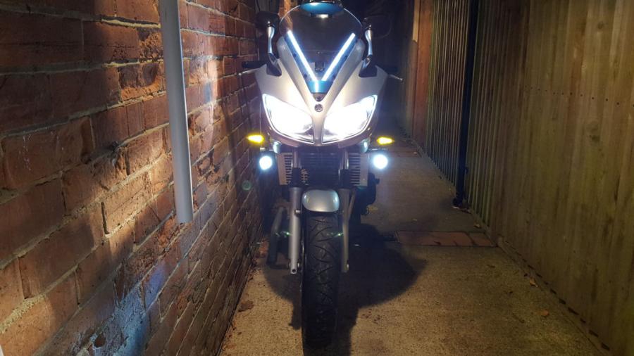

Spots make a huge difference to night riding and also add another layer of safety for day time riding also.
I fitted a couple on my Fazer a year or so ago, I feel more confident by being able to see better at night and also being seen in the daytime.
The spots I fitted are 30watt Projector Crees, they are amazingly bright and double the light out put at night, I have them focused on the low side so as not to cause issues for oncoming drivers and they really light up the area 30 feet in front of the bike, kerbs and road edges are also illuminated well.

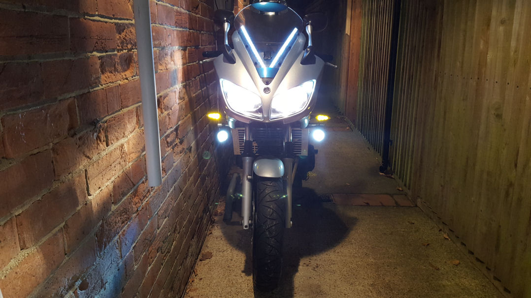

Is the effectiveness of the indicators not compromised  by the close proximity and high brightness of the spot lights?
(11-12-16, 02:05 PM)Dan Gliballs link Wrote: Is the effectiveness of the indicators not compromised  by the close proximity and high brightness of the spot lights?
No. They dazzle more in the pics than real life.

No! the way I have mine, and its sounds as if Tiger (Frosties) has his pointed in the same direction and height, they do not overpower the wandercaters at all, there seems to be very little spurious light emission from these LED Projector lamps, it is a definite spot beam with very little breakaway light, so indicators not effected.
I I [size=1em]have tried mine at different height levels and the level that the cars stopped flashing  :eek  me is around, at the top of beam 30 foot in front of front tyre.
And as Frosties said, that it really helps when filtering and I have also noticed that cars do not pull out of side roads in front of me like they did when I just had dipped lamps on. No guarantees on that one though.

I have my Hazard warning indicators on and it took me 5 shots to catch it with them on, :'(  the other four pics were caught between the flashes.
That looks decent mate! Not convinced on the white V on the screen though.

Yeah mixed feelings from people about the [size=1.45em]V [/size][size=1em]on the screen, they are professional quality ribbon of 18 LEDs each side of the [/size]V [size=1em]about 24 watts in tota[/size][size=1em]l, they are fitted to the inside of the screen. [/size][size=1em]Again these are also wired into the sidelight system so they are on with the other lights as you can see in the picture, but I have a switch fitted to the fairing infill panel to the live supply to the LEDs so I can turn them off at night when riding as they throw a bit of light back in my face, plus I wear glasses that doesn't help with the glare, but I guess it would be the same with just the visor.[/size]
