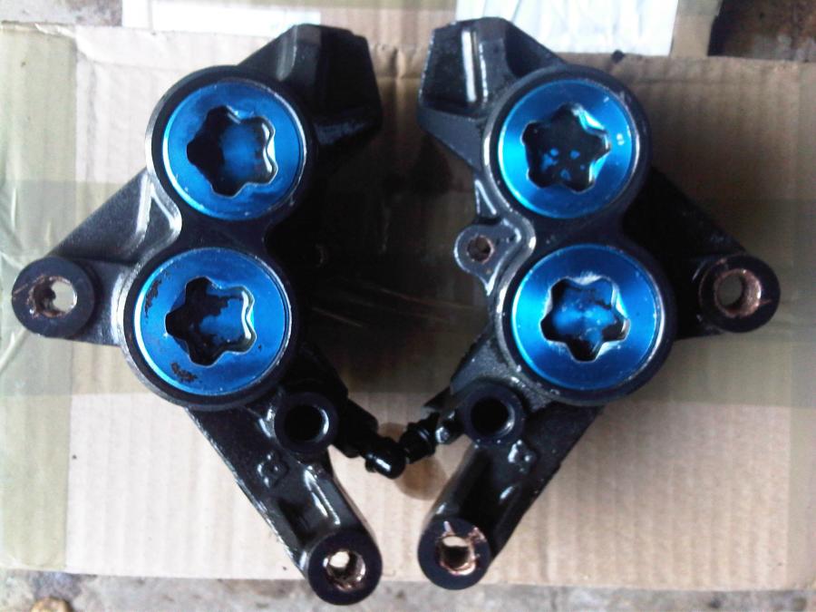

Brake calipers cleaned and ready for refitting...

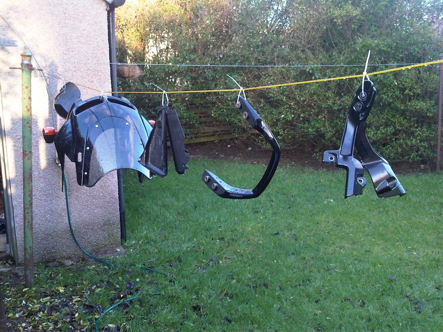

Hanging out to dry... :lol

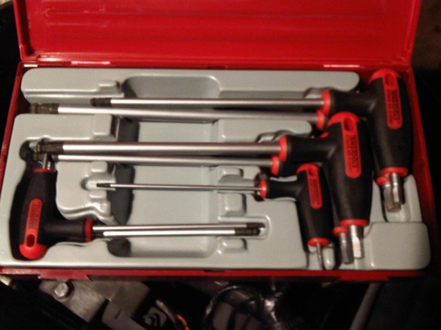

Got the front wheel off today, with the intention of doing the fork oil. Then I realised some smart arse designer decided it would be a good idea to have a LARGE allen bolt, bigger than the others and bigger than my kit's largest, on the black yolk. WTF...
Have to get some bigger allan keys then

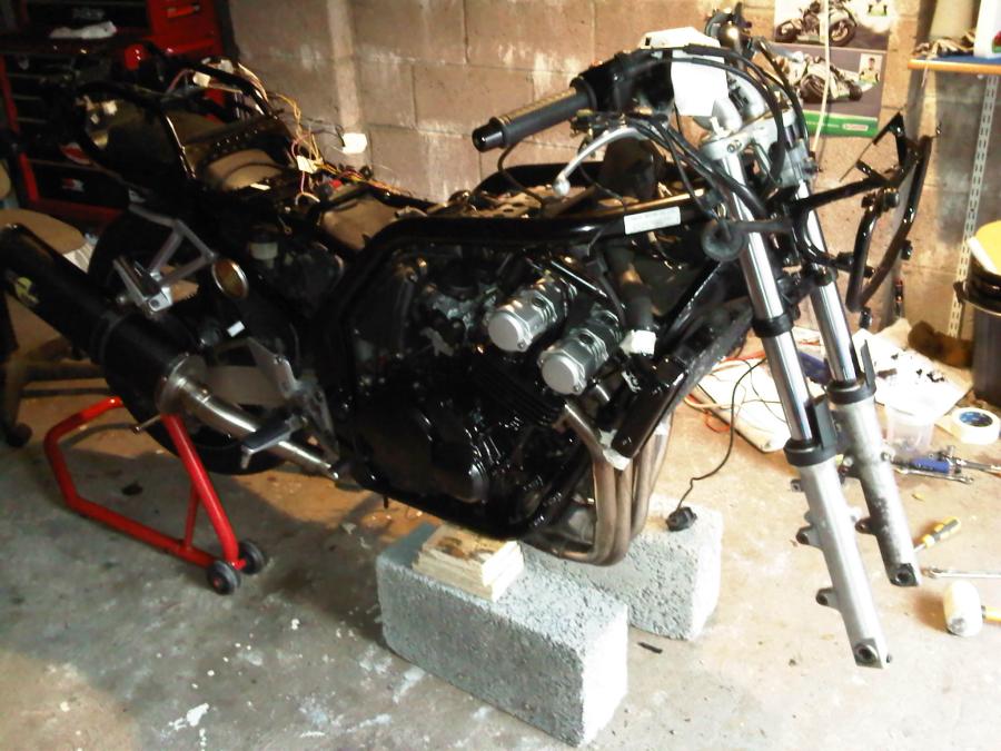

(28-01-12, 12:24 AM)Diablo link Wrote: bit nervous with raising petrol tank but ill be carefull.
Don't raise the tank, take it off. Give yourself some room to work. It is only one more bolt and a hose. One man job too, unlike my Honda.

(29-01-12, 08:29 PM)adeejaysdelight link Wrote: Have to get some bigger allan keys then
Talking Pish. I forgot I got these last year as my "gift" when I subscribed to Bike Magazine  :lol , just never used them...Well, I have now and got those bolts out  Big Grin .

Thats probably better, then you've only got to disturb everything once!  Smile

(23-01-12, 06:06 PM)adeejaysdelight link Wrote: Brake calipers cleaned and ready for refitting...
Exactly what I was doing at the week end!! Even robbed the sonic toothbrush to get in the nooks and crannies... our lass couldnt help notice her tooth brush tasted a little funny that evening  Wink , but it did an excellent job especially in those blue spots and around the pistons... Did you have any trouble cleaning around the pistons?  :lol

(30-01-12, 05:35 PM)CharlieDee link Wrote: [quote author=adeejaysdelight link=topic=1017.msg10686#msg10686 date=1327338391]
I done it in 4 staps, no problems at all. Quite theraputic actually.
1. Engine de-geaser foam and toothbrush, rinse, do it again.
2. Brake cleaner, spray.
3. A right good skoosh of proclean oil or another rust inhibiter oil, like WD40 or duck oil. Let it soften any remaining dirt and get the tootbrush in again.
4. Rins off and oil again.
Job done.
(30-01-12, 08:38 PM)Diablo link Wrote: Think ill do that might as well,makes life easier. thanx adeejaysdelight. Smile
I cleaned the calipers in a 4 stage process.
Yeah, take it off mate. Takes 5 minutes and you won't scratch it. Well worth it  Wink

(30-01-12, 09:42 PM)adeejaysdelight link Wrote: [quote author=CharlieDee link=topic=1017.msg11417#msg11417 date=1327941318]
Job done.
My method was:
1 - Spray down calipers with brake cleaner solvent (removes excess brake dust)
2 - Scrub with warm soapy water
3 - fine tough nylon brush to clean off pistons (ensuring free movement) and the continued detailed cleaning with our lass's sonic toothbrish
4 - Red grease(water based) the pistons to lube the piston seals then push back in(removed excess grease)
5 - Re wash and scrubbed the caliper and cleaned the brake pads and caliper spring/plate off
6 - copper slipped the retaining pin & back of pads
7 - Re-assembled and refitted onto the bike
Maybe a bit anal... im now more confident in the state of the calipers... he says!!  :lol
