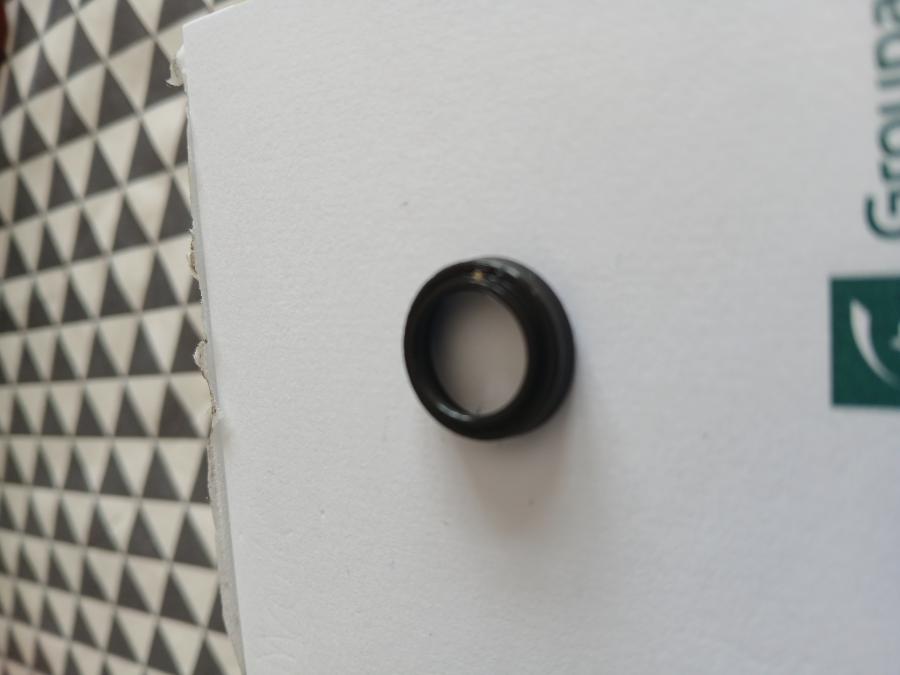

Hi Gnasher,thanks for the indepth reply ,my TPS problem was down to the fact that there was no readings at all ,this gave a reading of 10000 that was not adjustable using the turning method,I've just received and tested the new mikuni one with a multi meter and have a standing reading of just under 5,this is when using the pins at either end and if you use one end and the middle pin the reading increases as it should,I took a photo of the old TPS position before removing and put the new one in the exact same place and got the wonderful 5000,that'll do for me .

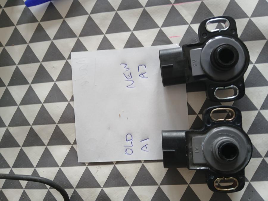

Hi ,thanks to all the members for their help and advice quick update,received the new mikuni TPS for the fazer 600 year 2000,tested it with multimeter before fitting ,got a standing reading of 5ohms using the top and bottom pins ,when using the end pin and the center pin it gave a reading which increased when the center was turned ,like the butterfly flap opening,fitted and tested and got the 5000 OK, the new part has A3 on it whereas the original had A1 ,it came from a reputable motorcycle shop here in france not a dodgy chinese knock off ,should have just paid the €129 the day it packed in and saved the stress and constant testing,haven't had a test run yet so will post after,one thing I did notice is that it came with a small rubber ring ,impossible to fit with this on,my original didn't have one so I've fitted the new one without,maybe it's for a newer model as mine is the first edition FZS600 I don't know ,maybe someone can shed a bit of light on this
One thing I did notice is that the new TPS when in the setting mode (unplugged then plugged in )creates a slight humm whereas the original had no sound whatsoever, might be helpful to someone testing their's ?
Coeurdelion

Just a newer upgraded version, usually referred to by yamaha as Superceded.
