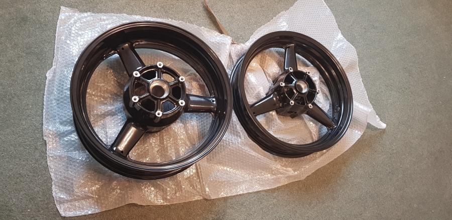

Got my wheels back from Triple S. So much better than the previous cowboys. Apparently when the previous powder coat was removed the original wheel paint was still on the wheels so they hadn’t even been blasted before they were coated. That probably explains why it was such a poor finish.
The finish from Triple S is flawless and the masking absolutely spot-on, nothing for me to do except put them back together. Have invested in a new set of Brembo Serie Oro discs and titanium disc bolts.

Nice :thumbup . Glad you're happy with the result after the drama you'd had. Wow, new discs and bolts too, nice one. My budget is a tad smaller :lol , so originals going back on, but have read several accounts of 100,000 miles plus on original discs providing genuine pads are used, which I do. Have you got a method in mind for replacing the roller bearing?.
#39
To be fair, my existing discs are absolutely fine for wear. I always use Yamaha pads as well. Just the bolts and inner mounting section are getting a bit scabby so decided to leave them on my existing wheels and treat the new wheels to some nice shiny new discs and bolts. I've heard good reports about the Brembo discs being a good upgrade.
