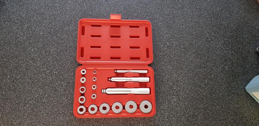

Hi ogri, The kit you suggested, is this the one with a set of various sized discs with a lip on them, and 2 or 3 handles that fit to the discs. That's the type I was thinking of, even if just to use the large 42mm diameter disc and some studding. The roller cage seems quite delicate so want to press it in rather than tap it in. The cage lip broke very easily when I removed the old bearing. Thanks for the suggestion :thumbup

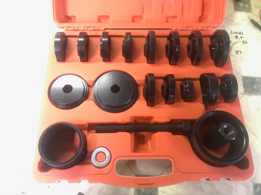

sounds like it...im out in the garage in a bit mate, i'll take a photo, put it up later tonight. feels so much better winding the buggers in than knocking them with a socket or summat, and you aint gotta worry about damaging the dust seal on a normal bearing or the this cage of the needle roller bearing. studding/long threaded bar is cheap enough ..got mine from travis perkins, means you can do swingarm bearings too

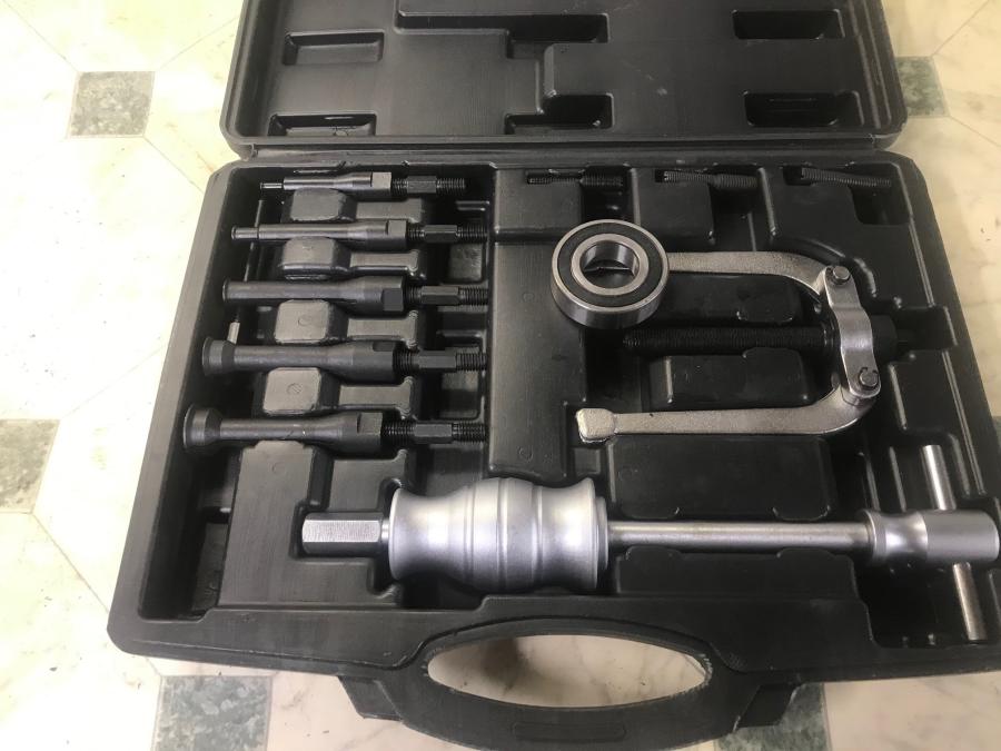

true enough coffee. I guess you gotta weigh up how much use youll get out of what you spend, and see if its worth it. the big bearing set, plus blind bearing pullers and a length of threaded bar cost me sixty quid all in, and between them you can cobble summat up for anything
Have ordered as set similar to the discs in the red box pic. It only contains 14 various sized discs and the necessary handles, but only cost a tenner though. It would have cost me more than that to have a 42mm disc cut at a local fabricators. Thanks for posting the pics ogri. :thumbup

nicely done robbo. once youve got the basics you can cobble summat up for most jobs. the blind bearing puller set wasn't quite such a bargain but its all a hell of a lot cheaper than stuff like this used to be, and quality is pretty bloody good, its certainly sturdy which is all you need. If you need to borrow the blind bearing puller to do em all ill post it out mate, you can send it back when youve done. its satisfying doing it yourself Anyhoo.

(20-01-20, 11:12 AM)robbo link Wrote: Have ordered as set similar to the discs in the red box pic. It only contains 14 various sized discs and the necessary handles, but only cost a tenner though. It would have cost me more than that to have a 42mm disc cut at a local fabricators. Thanks for posting the pics ogri. :thumbup

Arrived today, £10.99. If I use it once and have to throw it away, which I don't think I'll have to, I'd be happy. Just need the phonecall from the powder coater guy to say the wheels are ready, and for the bearings to arrive. Then I should be cookin'. Thanks again all for your hints, tips and suggestions, much appreciated as always :thumbup .
