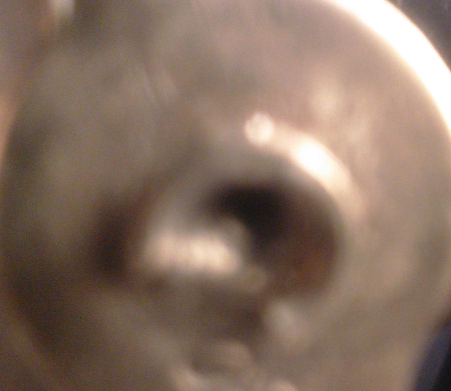

Well nothing is going right today. :'( . The pic should have been in the post, but instead you get two pics , no post. So as you can see I have broke one of the pins. :eek . All was going well until I decided to give that one another quarter of a turn,,,,,,, and I don't know why. So now waiting on new joining link. Hope this works.  :rolleyes

What tool are you using to flare the rivet? From the picture, you went off centre which is usually caused by the riveter not being set up incorrectly. General the flare should be not be less than .3mm or more than .6mm of the thickness of the rivet. I generally go for .5mm measured with a vernier to be sure.
#36
Sorry the pic isn't the best. Ive got just a basic flaring tool of ebay. But the flare part of the set didn't seem to good so I made a part which gave a little bit more of a spread to the pin. The part that came with the set seemed as if it would have been apply direct pressure without any flare. I do have a Vernier but the display is working properly so I cant say how much im flaring the pin but it wasn't a lot. If I had have stopped and not gone that little bit more it looked ok. But I do have a habit of just a wee touch more, and this is the usual result. Not as bad as when I was younger but is still snap things every now and again. But ill know the next time, which will probably be next weekend.

What was the tool.
I used this one youtube.com/watch?v=skX2GhrB2Oc
STUPID VID WONT LINK, copy and paste this youtube.com/watch?v=skX2GhrB2Oc and add the www.Its by Afam Although I did think afterwards that the pin that does the pressing into the hole looked a little worn after I had done the two link pins. Not sure if it would do such the same good job if used again.

It was the same as unfazed. But, as in unfazed pic , the flare pin , you can see clearly the point that would enter the pin on link to be flared.
The set I got  , if you had taken pic at same angle as in unfazed pic , you would not have seen as much of the point. When I held it up to the link to be flared , the point was in the hollow and flush with the face, this to me  would not have done any flaring.
So, after a bit of head scratching and looking through old tools I found a small punch , similar to tool one in the picture. A little bit of work and it looked ok. The point was same size as the hollow in link , but has more of an angle to flare.
The thing I got wrong was just the pressure, because you are flaring to such a small degree,  it would have been ok if I had not gone for the last wee tweek on it. My fault  :\
But the tool in unfazed pic looks a lot better than the one I got.
