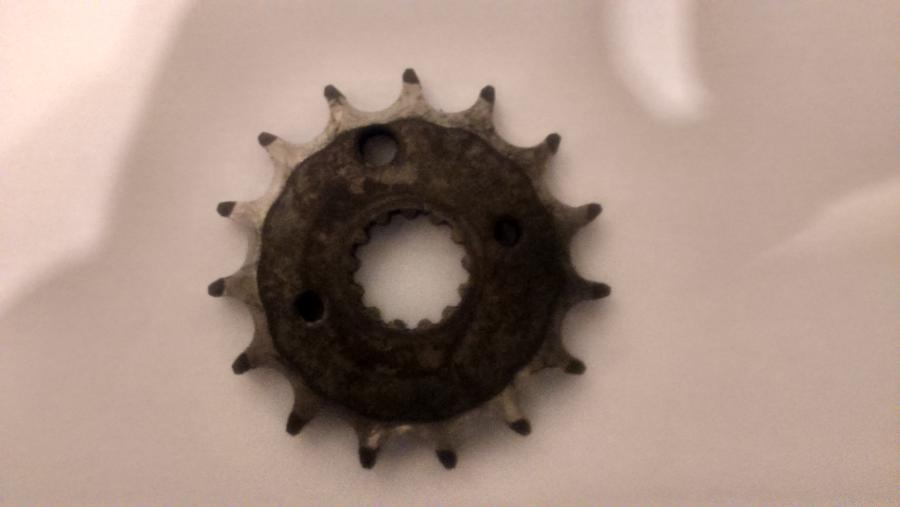

Well I tried to reply but something went wrong. I had a look and took pic of sprocket. Will try and attach before I go on.
That looks quite hooked and needs to be replaced.
Opps :rolleyes something went wrong again. Ive heard about pulling chain at the rear sprocket but never tried it. Will give that a try tomorrow and see what happens. Ive put old sprocket on again and the chain seemed to run over it a bit smoother. Again see how that goes tomorrow.

Sprocket is a bit worn, but not that bad.
Look at the lower level of the chain, a sticky link will be at an angle, rather than horizontal.
That sprocket is focced.
All needs changing whatever way you look at it  :lol
Smile Well as I said I put old sprocket on last night and,,,,, no Clunk today  Smile . But the old sprocket has signs of hooking on it too.
