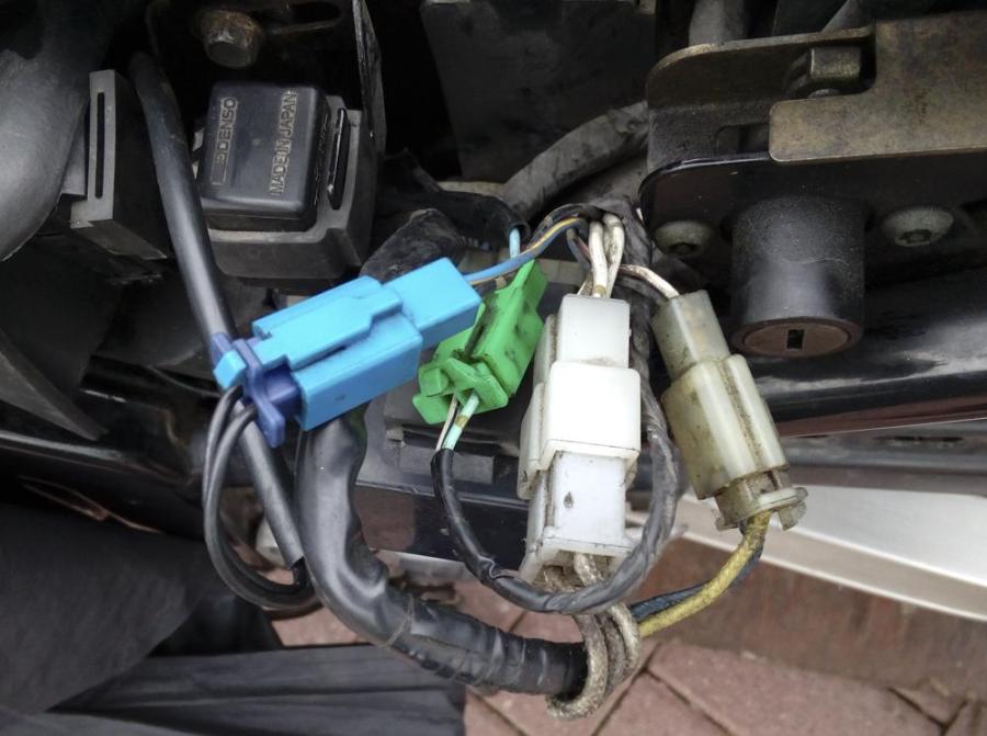

ER yes...the bike is registered 2002 but its a 5DMC 070C... the 2001 model I think...I,m not going any further with the sidestand switch issue... too complicated for me.
Just fer the craic...this is wot i am looking at....the blue connector is the sidestand switch earth circuit... :evil
#22
(12-06-19, 01:05 PM)Steve3351 link Wrote: This for UNFAZED...
the switch is definitely working. The two wires from the connector (black and blue/yellow) disappear into the loom.
I see under the seat someone has opened the loom, there is a lump of taped off wiring...and two red/blue wires going to a 10amp fuse labelled PARK.
I,m inclined to leave all as is...sidestand switch not operating is not too important,,,, Sad
Therein lies your problem, looks like someone disconnected an alarm and taped up all the wires, but earthed the side stand switch wire.
Untape the wires and see how good the connections are inside. Post a picture, it is not the most difficult thing in the world to check the wiring if you can use a meter to check for continunity.
You only need to leave the sidestand down once  :eek :'(

Most likely when the alarm was being removed they connected the wire that normally goes to the side stand earth to a permanent earth to get it to run.
There must be two sets of two wires connected further in to the loom as you do not have all the wires for the alarm exposed.

I presume the blue plug under the side cover was connected  Big Grin The black wires with the yellow marks are the standard loom wires.
On the black plug socket in you pics there is a an NR number on the wire what is the number and are there any other NR numbers on the wires or a colour band?
#36
Yes the blue connector is plugged in...the black connector is actually a 15a fuse...one of the wires going to it is marked 6NR...the other wire didn't go anywhere so i cut it out. All the black wires have similar yellow bands but no numbers or other markings...
#37
So i check to see if i have continuity between the black side of the sidestand (blue) connector and any of the black wire i have exposed...and indeed i do...on Nos. 5 & 6....confusing....??? Sad
#38
(14-06-19, 05:15 PM)Steve3351 link Wrote: Yes the blue connector is plugged in...the black connector is actually a 15a fuse...one of the wires going to it is marked 6NR...the other wire didn't go anywhere so i cut it out. All the black wires have similar yellow bands but no numbers or other markings...
That wire on a meta alarm is never connected on the Fazer as it is for Magneto ignition type bikes, which the Fazer most definitely is not.
(14-06-19, 05:37 PM)Steve3351 link Wrote: So i check to see if i have continuity between the black side of the sidestand (blue) connector and any of the black wire i have exposed...and indeed i do...on Nos. 5 & 6....confusing....??? Sad
That would be correct as the black wire in the side stand blue connector goes directly to a permanent earth in the loom
You will need to delve further into the loom to find the extra connections
