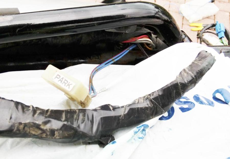

I see under the seat someone has opened the loom, there is a lump of taped off wiring...and two red/blue wires going to a 10amp fuse labelled PARK.
I,m inclined to leave all as is...sidestand switch not operating is not too important,,,, Sad
That's the circuit for when you turn the key to park. It has nothing to do with the problem. You're looking for two connectors together, under the seat with only black wires going to them. They are the connectors for the alarm.
