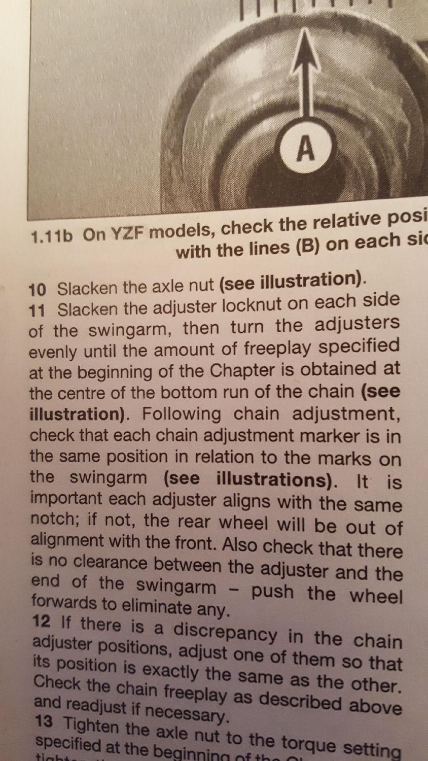

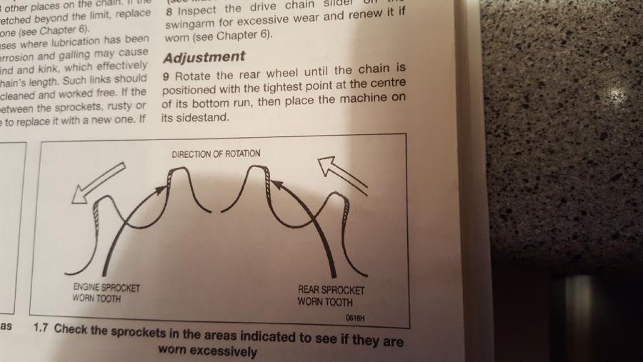

This what the manual says (See Pics) pic 2 is the continuation of first pic but on the next page. I agree with some of the remarks in here, Centre Stand tightest spot on the lower chain run, push the chain up without excessive force, and, if the chain just touches the rear of the chain guide on the bottom of the swinging arm you are about right.
#37
Also these chain tightening instructions cover YZF & FZS, the YZF only had a side stand. Smile
