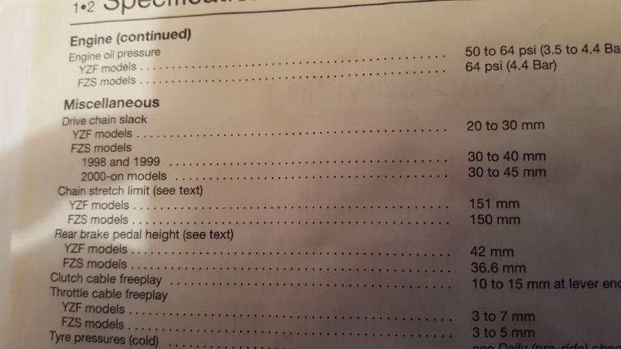

Re: Std exhaust silencer weight - tommyardin - 18-10-18
:agree
My Fazer FZS600 hardly makes
any noise, or clunk going from 1st to 2nd, but, I do get a clunk when going into first from neutral, especially when going into fist with a cold lump, I find slightly easing the bike forward with my tootsies helps to alleviate this.
Chain tension is important, this is one of the reasons you need a centre stand, spin the rear wheel by hand checking the chain tension on the lower chain run directly under the black swinging arm chain guide that is on the top at the front of swinging arm, and make sure you have 1.5 inchs of movement pushing the chain up without excessive force. I understand this is the accepted measurement for a 2003 FZS600 Foxeye.
See photo of manual.
Although I have read somewhere that the chain adjustment should be made with the motorcycle on the side stand, so that some/most of the bikes weight is on the suspension.
I have always done mine on the centre as its easier to adjust it with the rear wheel off the ground.

Re: Std exhaust silencer weight - His Dudeness - 18-10-18
The manual says to keep both wheels on the ground. I think the chain gets tighter when the bike is on both wheels compared to when it's on the centre stand so if you adjust the slack to the specified amount while it's on the centre stand, when you put it back down onto two wheels the chain will tighten up so it will be tighter than spec whereas if you tighten it to spec on the side stand that's where it stays. I've always adjusted it on the side stand anyway

Just done some measuring....
On centre stand- 30mm chain movement at the rubber thingy.
On side stand-26mm chain movement at the same place.
Re: Std exhaust silencer weight - YamFazFan - 19-10-18
Just been out for a ride around petrol fill up and it's changing gear silently now :rolleyes .
Maybe got enough slack now.
