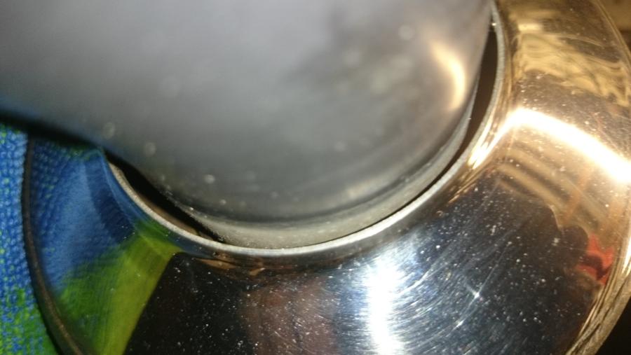

A mate suggested it's maybe because I have a hole in my exhaust, where the pipe goes into the silencer, see pics, so I was wondering what your thoughts on it being that?

15-05-15, 01:31 PM
If you shoogle that bit does it rattle or move very much. I doubt it is that but I would want to sort that anyway just to be sure

(15-05-15, 01:31 PM)mickvp link Wrote: If you shoogle that bit does it rattle or move very much. I doubt it is that but I would want to sort that anyway just to be sure No mickvp, doesn't rattle at all but it is leaking, was just curious if that was anything to do with it. I'll pm you in a couple of weeks and we can sort something out re the carb balance?

15-05-15, 07:16 PM
all fzs 600 exhausts are like that.
15-05-15, 07:38 PM
(15-05-15, 07:16 PM)Paulfzs link Wrote: all fzs 600 exhausts are like that.Surely they shouldn't have a leak before the silencer?? In fact, I don't think exhausts should have a leak anywhere.

Yeah, they're all like that to look at as far as i know, but mine's blown within that gap
![]() So I'll get it welded / braised round the whole lot and that should improve the exhaust even if it doesn't resolve the vibration.
