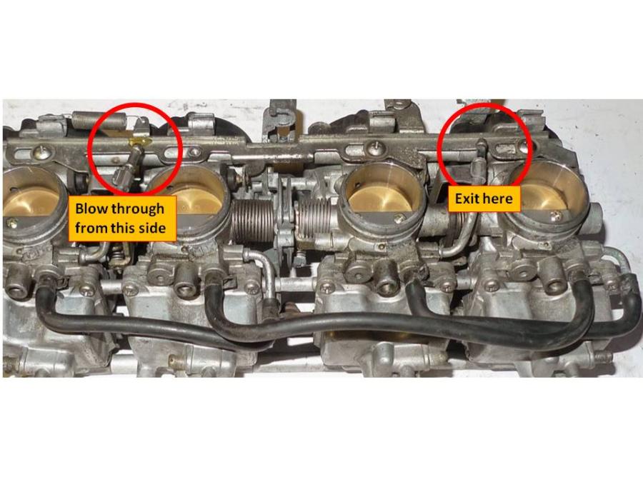

In exceptionally cold conditions it could need the choke to idle for up to 5 miles, depending on your driving conditions, in town or out of town, it will obviously take longer to heat up in start stop traffic or if like me your first 3 miles is mostly down hill.
Some of the later Foxeye models had a blockages caused by Swarf stuck in the heater circuit which was documented by Yamaha. It was usually the left hand carburettor and just required removal of the pipe and some poking with a piece of stiff wire to dislodge it and blow it through from the right hand side.

(13-01-15, 09:48 PM)unfazed link Wrote: Some of the later Foxeye models had a blockages caused by Swarf stuck in the heater circuit which was documented by Yamaha. It was usually the left hand carburettor and just required removal of the pipe and some poking with a piece of stiff wire to dislodge it and blow it through from the right hand side.
Did you check the pilot jets before you refitted the carburettors?
Thanks for this Smile
The left had carb was the one with the blocked pilot jet the mechanic who cleaned them unblocked it for me and checked the others. He said the others were not too bad but cleaned them up too.
Mine is a 2002 Foxeye
Any chance you've got a pic of the pipe? or do you mean the left hand coolant hose that runs to the carb?

See attached, the few I have come across was always this carb remove the two rubber pipes and poke the stiff wire through from both sides.
Blow it through, when I did my own originally it was difficult to blow through, once cleared it blew cleanly and the icing issues disappeared.
When finished blow it through right to left and it should be ok. If not repeat the process for each carb.
