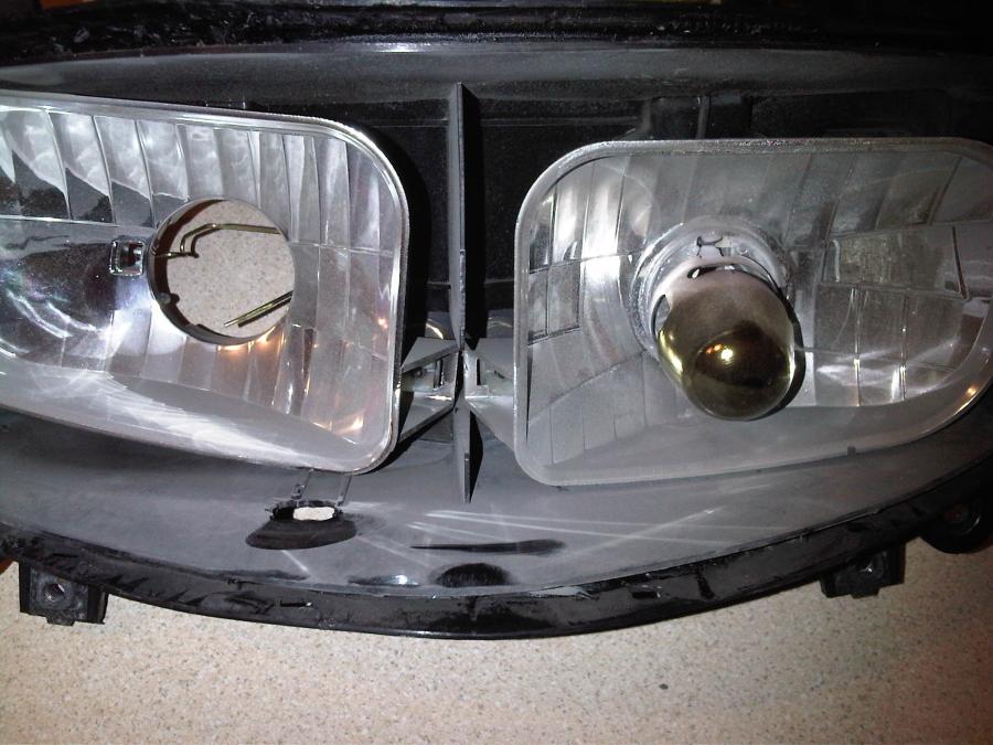

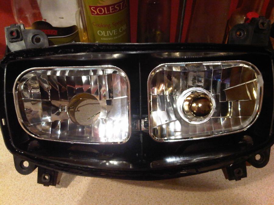

Lamp reflector done. A free and well worthwhile job, if you have a couple of hours to kill  Big Grin
I split it with the method below. When it was split I took the reflectors out. I then cleaned the main body and face in the sink with water and a soft cloth. The reflectors I cleaned first with a make-up brush, then rinsed with water and wiped with a clean, wet, soft cloth. Then dry with paper towel and a hair dryer. Finaly, I used glass cleaner on the face, greased the screws and reassembled. Back in the oven to set the glue.
http://fazerowners.yuku.com/topic/30568#.TwtYoqUwvNU
#27
Headlamp done. It has came up great and is a worthwhile job if you have a couple of hours to kill. I used the method below to split the unit. Be careful not to damage the reflector lining.
#28
Sorry about the double post, just getting used to this forum stuff.
Here is the lamp cleaned. Job done, well please  Big Grin

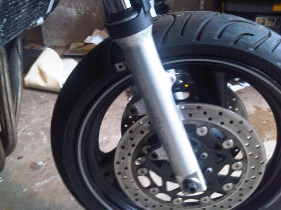

Got the front brake hoses and calipers off now. After a good clean of the calipers I will start to think about fitting the new HEL braided hoses.

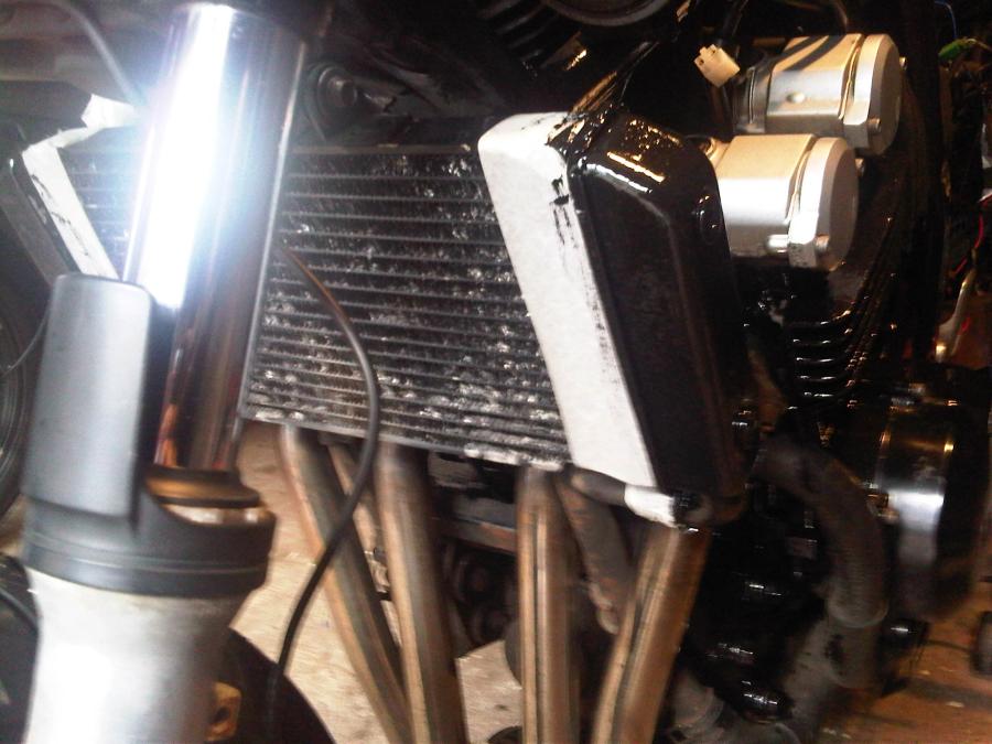

Radiator painted too. I will spray the fins when I get a chance. But for now, this is a massive improvement.  Big Grin

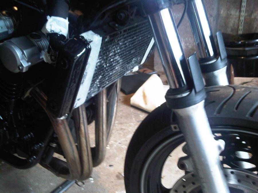

And the other side...

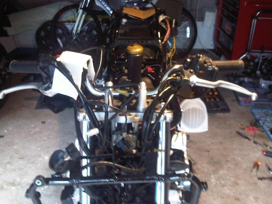

And I got the grips fitted and working. I rigged the Live feed up to an ignition feed so that the circuit is broken when the engine is turned off. I got the Alarm on and working too, Remote start and all...
