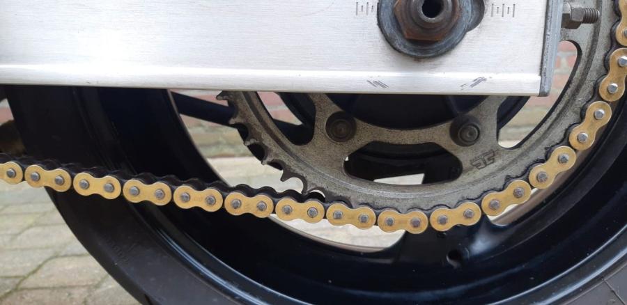

The chain and the rear sprocket:
It look to tight.On the centre stand place you finger on under the chain directly bleow the plastic swinging arm guard. Push it up and it should just touch the plastin guard, if not its too tight.
It look too tight. Put the bike on the centre stand place you finger under the chain directly below the end of the plastic swinging arm guard. Push the chain up and it should just touch the plastic guard, if it doesn'ttouch it then the chain is too tight.

I would say looking at the worn off anodising on the sprocket teeth then the chain and sprockets are not that old, I have the exact same set about 6,000 miles ago and mine looks about the same, here it is new[Image: index.php?action=dlattach;topic=25205.0;...5260;image]

The chain looks very tight, and once loosened to the correct movement you really have to make sure very gradually that the wheel is straight once tightened back up If you spin the wheel backwards on the centre stand it should purr very smoothly with no clunking or biting noises from the chain. The two combined if incorrect, which is likely i reckon, could cause problems mentioned, or at least be a part of it.

Quick summary of the weekend:
- Chain was too tight
- Chain was streched too much and needed to be changed, the manual says max 150mm between 10 links, i had 162mm
