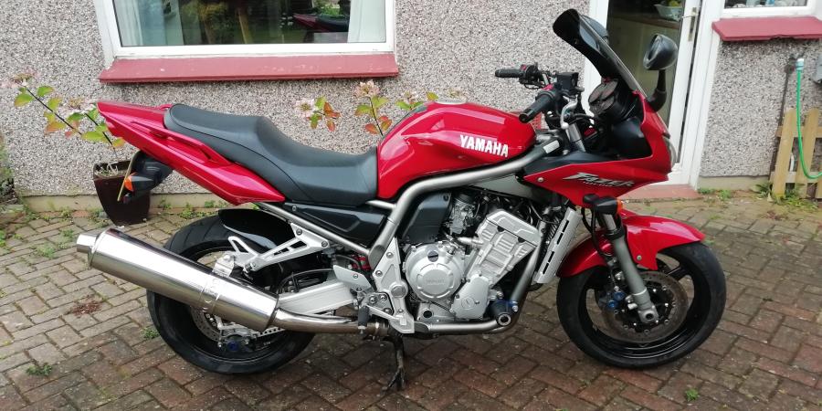

Hi, first post after just getting my first Fazer 1000. Got it for a fairly good price but I've now found it has no Exup valve fitted.

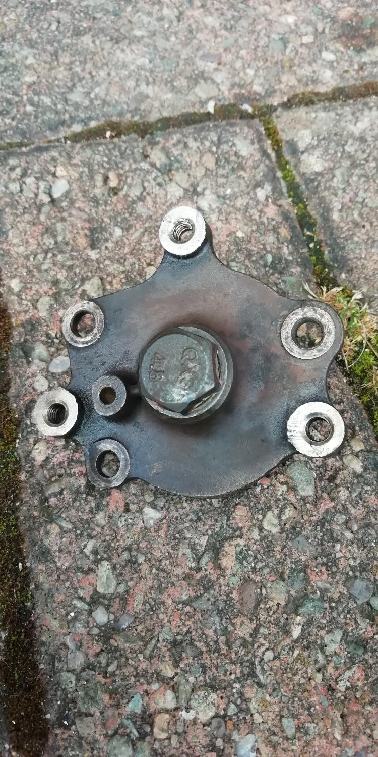

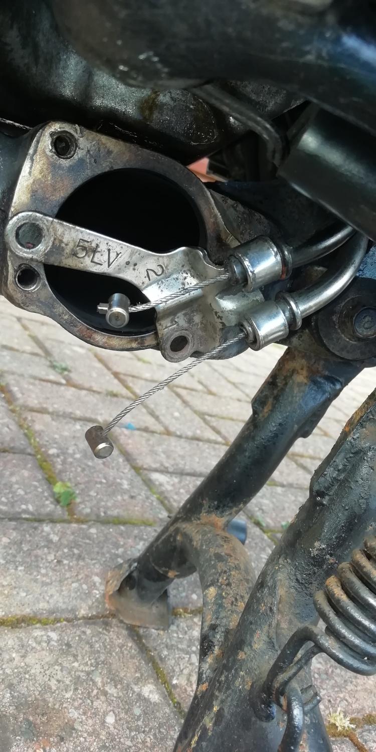

I have the cables but no pulley, removed Exup plate from manifold and no valve fitted.
The bike is standard and goes OK but would like to have a working Exup system.

Either replace the missing valve with a used set of headers, or as I just learned get a exup valve of a set of 1998-2000 R1 headers (see post below)

Take your time and scour ebay/breakers etc for the EXUP valve components.  Early model R1 valves are identical, so search for old R1 exhausts and scavenge what you need from one of them.
Out of curiosity, just done a bit of online research.
Fowler's parts fiche shows same part number for EXUP shaft (the actual valve part) 4SV-14821-00 at an eye-watering £445!  But you already knew that ...
Same part number appears for late 90s FZR1000 Thunderace and the 98 - 01 model R1s, in addition to the Fazer 1000.
Try a Google search using the part number.  I found this today:  https://www.mpricambi.com/request-quote/  May be out of date but worth trying and this is the kind of thing that you'll come across if you're patient and keep looking.

Removed and tested the servo, it nulls itself on applying 12v to the plug. Good news!
Bit of a bugger getting it in and out but hopefully won't need to do that again.
There was no eliminator fitted, just normal loom plug.
I guess as long as servo sits at null, regardless if cables are not connected, then it won't throw up the 7k rpm code.
I did try ignition on with plug disconnected and did get 7k rpm code.
I think I've managed to source a working valve assy with pulley at a reasonable price just need to order it.
So hopefully in the next for weeks I may have a functional exup ?

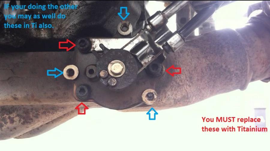

So regarding your exup vale, the 2 things that EVERYONE will say on here regarding the valve and the cover are -
  • replace all 6 exup cover bolts with Titainium, the mild steel ones in there rust and can snap-off in-place.
  • apply copper grease to ALL bearing serfaces of the cover & valve, every 3-6 months depending on use.
