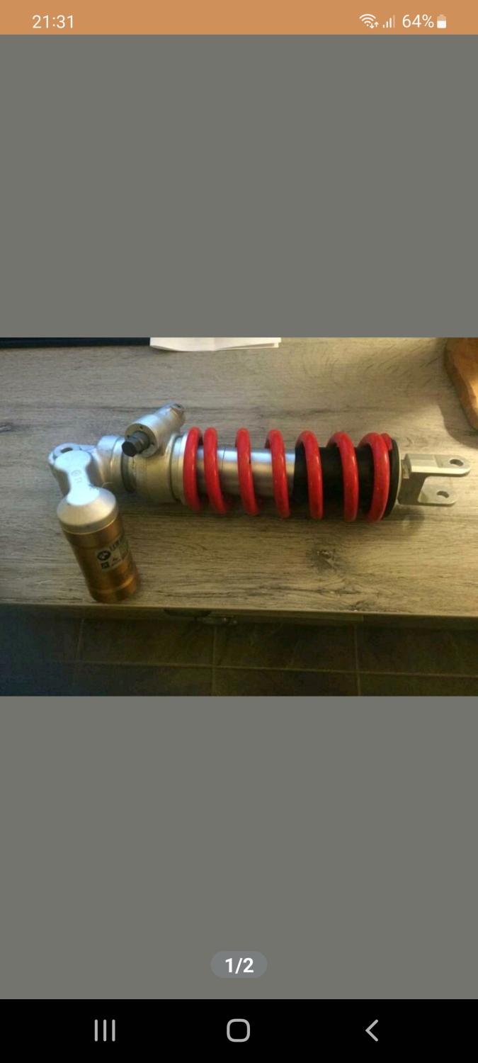

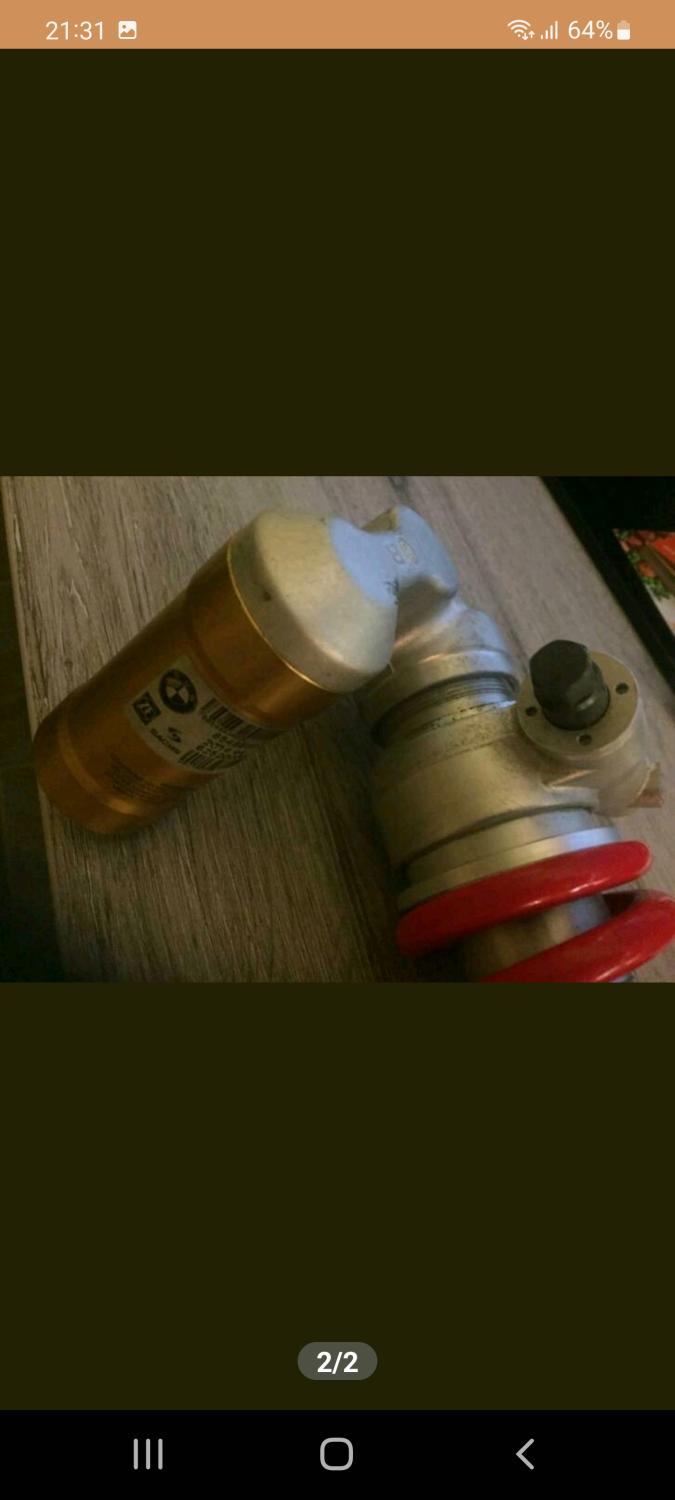

Is this the correct one to upgrade my thou?
It looks similar to the one's with electronics on it but the seller says it does not have wiring on it. I'm not sure, maybe the wires are cut off, or maybe it's the right one.

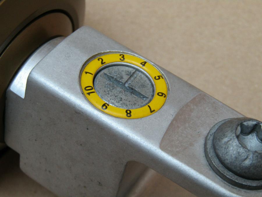

Does it have any damping adjusters on it?
The pictures are all i have for now, but it doesn't look like it.

(18-01-22, 07:08 AM)Jays83 link Wrote: The pictures are all i have for now, but it doesn't look like it.
If it hasn't got the adjusters shown  it's of no use to you

I've asked the seller and unfortunately it's not the one i need.
Thank's for the help.

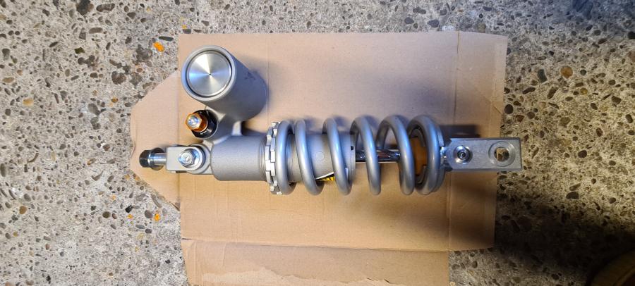

This is the one i picked up today.
It's a near new 2017 R6 shock.

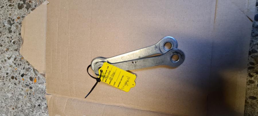

Also found some dogbones with the holes at 125mm center to center.
Do you know if i have to grind the top of the shock a bit on this one and do you know what the differece in hight will be with this 5mm shorter dogbones?
This guy i picked up this shock has alot of them and also has a lot of the s1000rr shocks.
The dogbones are oem ones from a yamaha bt1100
The shock
The 2006-07 2cO version (with separate compression adjusters at the top of the shock) won't fit the FZS1000, but the 2008 onwards 13s version with combined compression adjusters does fit.  That shock looks like the same overall design as the 13s version with combined compression adjusters, it's just the the spring preload mechanism that is different.
Just fitted the shock, it was really easy to do.
Drilled out the top to 12mm and with two 2mm spacers it fits perfect.
With the oem dogbones from a Yamaha bt1100 the rear is just 1.5cm higher so the rearwheel wont touch the ground when the bike is on the centrestand.
