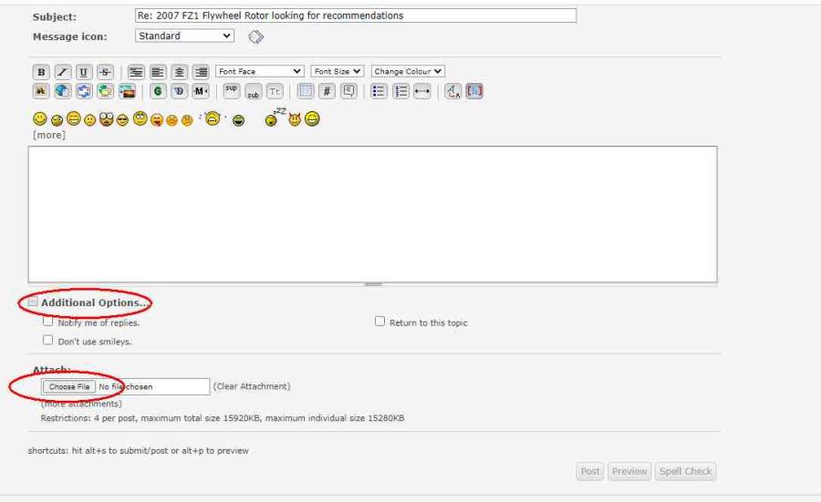

(20-10-21, 10:17 PM)Chris 50+ link Wrote: It arrived and is well packaged, just trying to work out if and how I could upload pictures.
[Image: 7ea863bf-f596-4f7b-8ec5-66f330da5533]
[Image: cd033bed-a9a6-48bd-9628-d232762b6443]
/quote]
Click on the "Additional Options...." link below the text window. I received a replacement generator cover gasket today so will pull the cover on mine to check that it is indeed the original version rotor.
Aha, thank you!

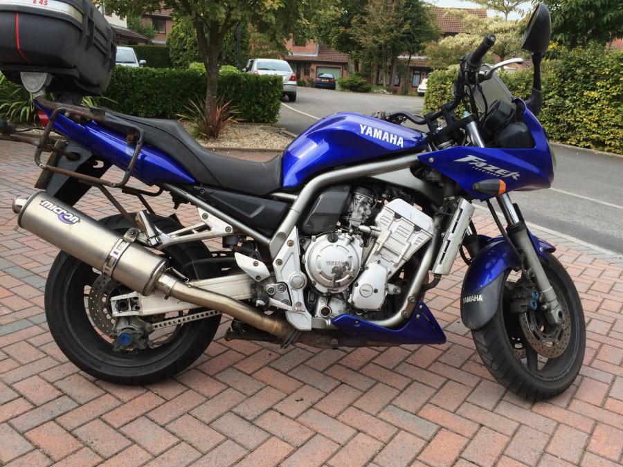

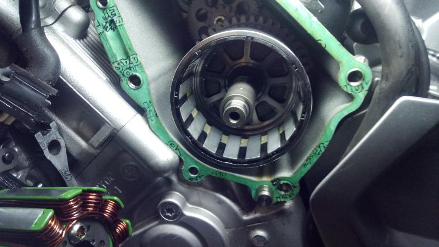

Bike and original rotor when I examined it.
.jpg   cf08582a302348b581866e95aade20eb.jpg (Size: 115.61 KB / Downloads: 78)
.jpeg   IMG_4047.jpeg (Size: 35.76 KB / Downloads: 73)
.jpg   f296b08ed8964c13bfd5bd2cc5090a5a.jpg (Size: 101.52 KB / Downloads: 74)

Very noice mista, I have the exact same colour FZ1.
on a different note, Id be wary of those frame mounted frame sliders, hit them the wrong way in a drop and they will snap the frame mount clean off...!
Hey Chris I had the unfortunate task of having to replace mine last year after the original decided to give up its hold of the magnets ? I too used the RMStator one and was perfect.
The only additional thing I would add is keep an ear out for a high pitched whiney noise. I had it develop after around 600 miles and it turned out to be the bearing in the engine case giving in. The weird thing was it sounded and worked fine when spinning the rotor by hand and gave no indication that it was failing at all but once it was removed my mechanic spun it up to full speed using an air gun and it sounded awful
Now I might have been unlucky or it could have been that the new Rotor was a few 1000ths thinner but it needed to be changed out. Was relatively cheap to replace and wasn't causing any issues at the time other than a high pitched whine when the engine was revved (think of a crap sounding turbo whine haha) anyway just something to look out for mate ??

Re the frame sliders, in my defence it came with them, and one has been scraped... I mostly avoided dropping my previous Fazer so will see how it goes; they might come off.
Previous bike below.
Thanks for the point about the bearings, currently they seem ok so will just do the rotor; but will keep an ear open for that whine.
