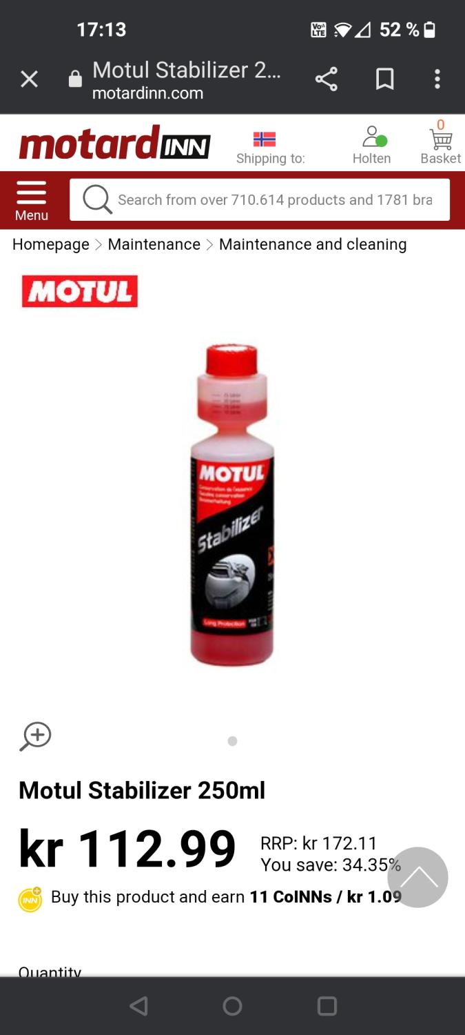

Do you use any type of fuel stabiliser during your winter layup. My Fazer gets used until the end of October, then my winter bike gets pressed into service. Before the Fazer gets put away,I add a dose of Sta-bil before brimming the tank with 98/99 octane petrol, then it‘a straight home and into the back of the garage. Plug in the Optimate, throw a sheet over her, and that’s it until next Spring.
Yes i use this from Motul and 98 octan

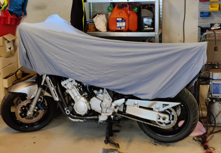

[color=rgb(32, 33, 36)]Bought me Bagster tank cover and tank bag so then i am at least ready for a little longer trips next year[/color]
.jpg   244472387_10159447779801061_3771769322898358617_n.jpg (Size: 85.76 KB / Downloads: 110)
