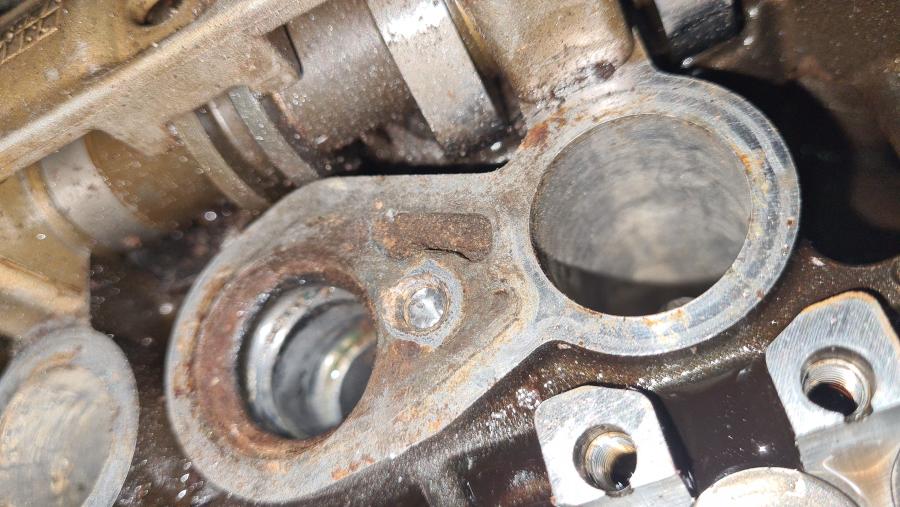

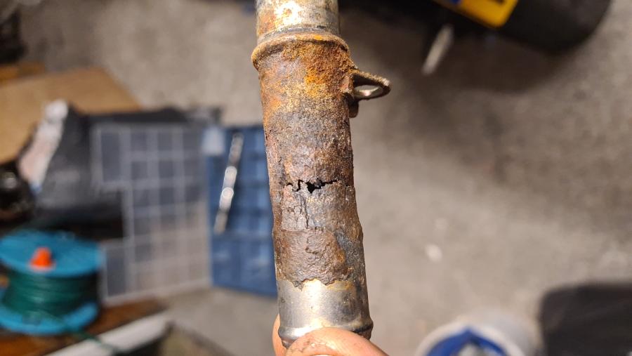

I thought it would be a good idea to check the valve clearances and they were all within specs. I discovered that the coolant pipes on top of the engine were in bad shape so ordered 2 new ones. Well... one came loose pretty easy but the bolt on the other one was so rusted it snapped. I guess i have to take out the entire engine now.
Looks like i'm not riding any time soon.

(01-03-21, 08:58 PM)Jays83 link Wrote: I guess i have to take out the entire engine now
Not necessarily, check with your local engineering shop or a good mechanic. If there is enough clearance around the top of the engine and the frame, that will give them a good chance of them getting it out for you. Worst case yes the engine will need to come out, but on the FZS1000 that easy due to one of the frame rails being removable.
In the photo I can see lots of dirt on the camshaft and its lobes (from pressumably when took the cover off), you really don't want this going into the engine.

Thank's for the advice, i will definitly clean it all up, there was nothing i could do to prevent it from getting there. The pipes were rusted so bad they almost fell apart.
Looks like salt corrosion and as pointed out the cams and head look to be in poor condition.  Looking at the water gallery, it suggest the bikes been running with little or no antifreeze for sometime.  While you're doing all this work it would be a good idea to check the water pump, thermostat and the rad for sediment.

When i bought the bike the waterpump was broken, it threw out the coolant trough the wheephole on the bottom of the engine. Is that the reason for the brownish color? When i'm taking the motor out, are there any smart things to do once it's out. I will have easy acces to all the components.
Yes the brown is corrosion from the water pump and components like the steel water pipe.  I suggest you need to flush the whole cooling system with proper system flushing agent, you may need to do that a few times, especially the rad.

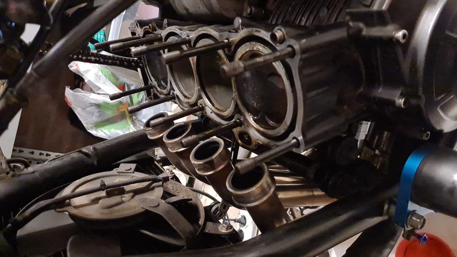

I've decided that i'm taking the cilinderhead off to drill out the snapped bolt and also to clean it. All this work and still not busy with solving the starting/driving issue.
Is there any way to set/control the timing if i mess it up? I now made sure that the cam lobes on cilinder one are pointing away from eachother.
Your starting and running issues, are I'm pretty sure rust sediment in the crabs.  You need to sort out the tank, either treat the rust properly, cut it out or replace the tank, reclean the fuel system, carbs and properly treat and flush the whole cooling system.  That should sort out the starting/running problems you've got.
As for timing not really, you could clamp the cams but is a fuff and not required.  All you need do is ensure the crank and camshaft marks are correctly positioned as per the manual.

Thank you for your advice, i've just taken the head off.
Now i'm waiting for my wife to leave the house so i can put it in the dishwasher Wink
