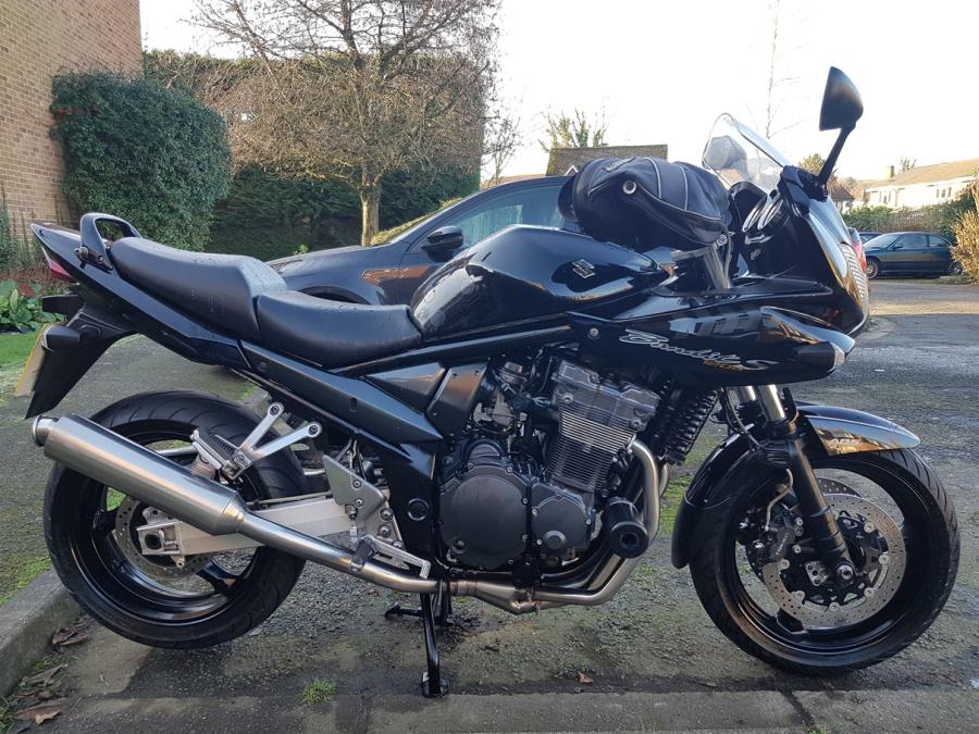

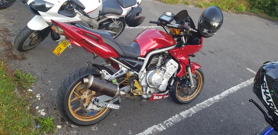

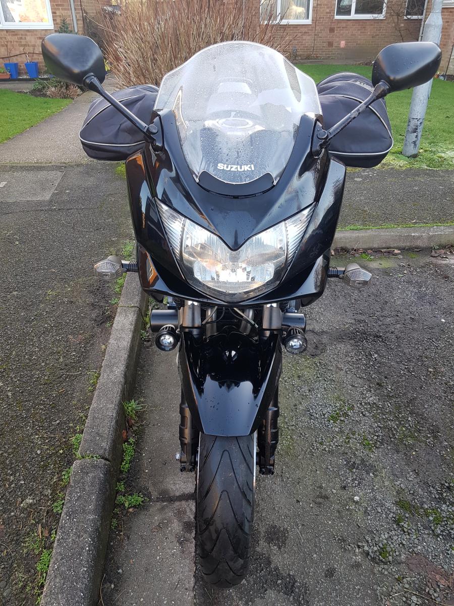

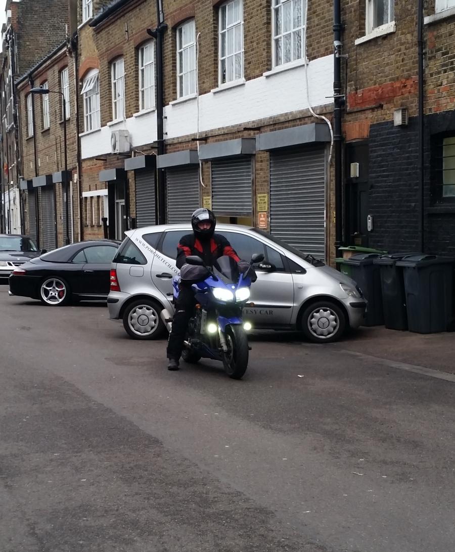

I have fitted various spots and lighting upgrades to a fair few of my bikes, but here are some pics of my 2005 FZS1000 that had both LED spots and LED bulbs in the main lights and a video in a dark underground car park in London. Also also my old GSF1200 that had LED spots and HID dip beam.

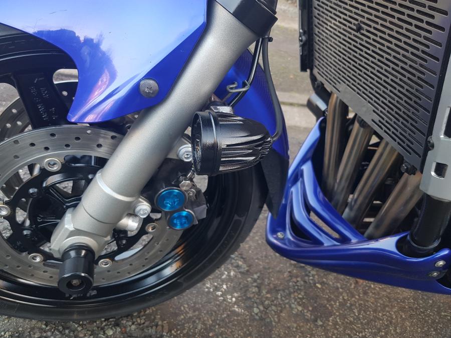

(26-08-20, 10:05 PM)dazza link Wrote: So where did you mount them on the FZS ?  Looks like the mudguard fixings.
No, I mounted them to the brake hose clamp lugs, with a spacer and a nylock nut on the backside.

(27-08-20, 10:21 AM)WayneUK link Wrote: Hi, how are the lights fixed is there a bracket on the lights?
I just mounted the spotlight with the braket it came with to the fork with a M6 bolt, spacer and nylock nut. The potlights were from -
