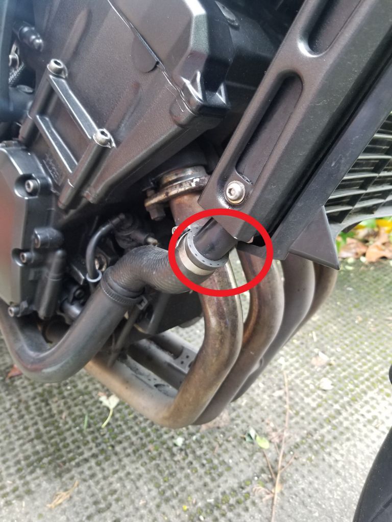

Where is the coolant coming from? The overflow hoses from the rad cap and coolant bottle or somewhere else?
Pretty sure I saw some spurting out of here, it was also spilling out from somewhere below. I didn't manage to jump off in time to see exactly where

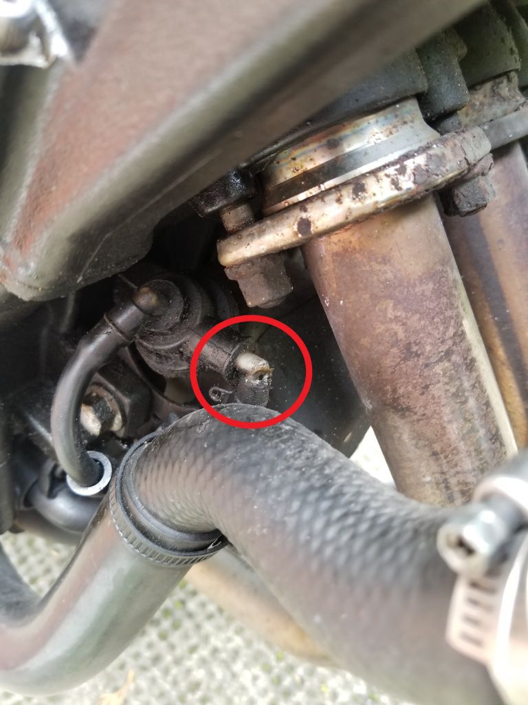

Also this overflow looks melted ?

From the pictures it's almost impossible to tell you what's going on.  The second picture shows a hole the drain elbow for the coolant reservoir (expansion tank) cap, which could have sprayed coolant onto the bottom rad hose union you've circled in the first picture.
It's unlikely it's been leaking from the hose union as there's no discolouration I would expect to see on a leaking hose union.  My money is on the water pump, collapsed rad core or a leak somewhere in the system, which has caused the bike to over heat and dump water into the expansion tank.
You need to get the pump, rad and system leak checked.
