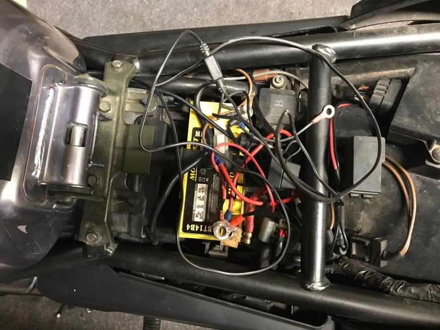

The issue of connecting lots of electrical items to the bike has effected all of us at one point other another, and when there is more than 2 its becomes a mess of ring terminals around the battery. Enter the Healtch Thunderbox, and here is a video explaining in detail -

Interesting, but, given the lack of space under the seat of the FZ6, there's no room to actually fit one...!

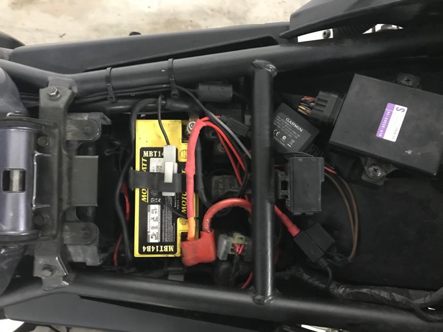

That's interesting. It looks good.    I recently converted from stacks of ring terminals to 'Wago connectors'.  I attach one 5 port wago to each battery terminal using six inches of 1mm single core and then attach up to four peripheral items to the wago's.  The snap connectors are pretty safe but just in case, I wrap them with electrical tape to ensure the orange levers never get pulled open.  They take up very little room and on the Fazer they drop down into the recess just in front of the battery. I'm never running anything like 20amps so they're fine. Also, Amazon will sell you a pack of five for £4.  Next time i'm at my bike i'll take a few pics.

I made my own with a 12 way chocolate block. Cost me about 50p.
What a really great idea. Used a few in a wiring job at home. Never even thought about using on the bike. Much cheaper in Screwfix though!

Yeah, I bought a rake of different sizes/ports from AliExpress but not as many as one needs to buy from Screwfix to get the good price.
