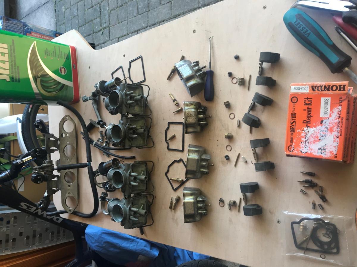

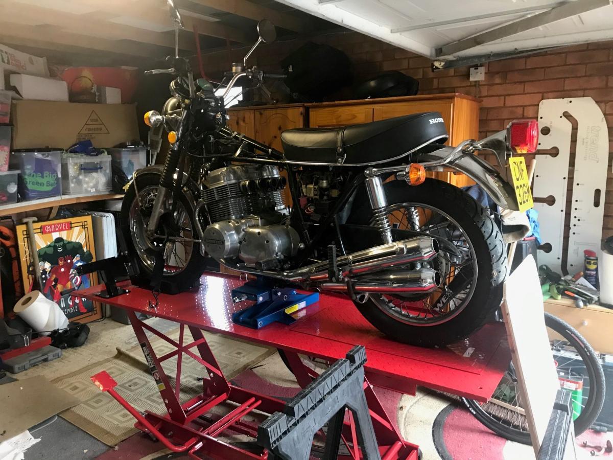

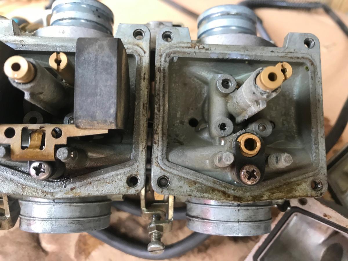

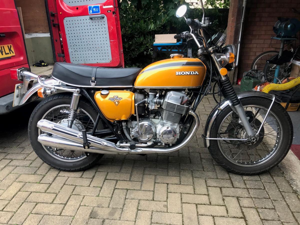

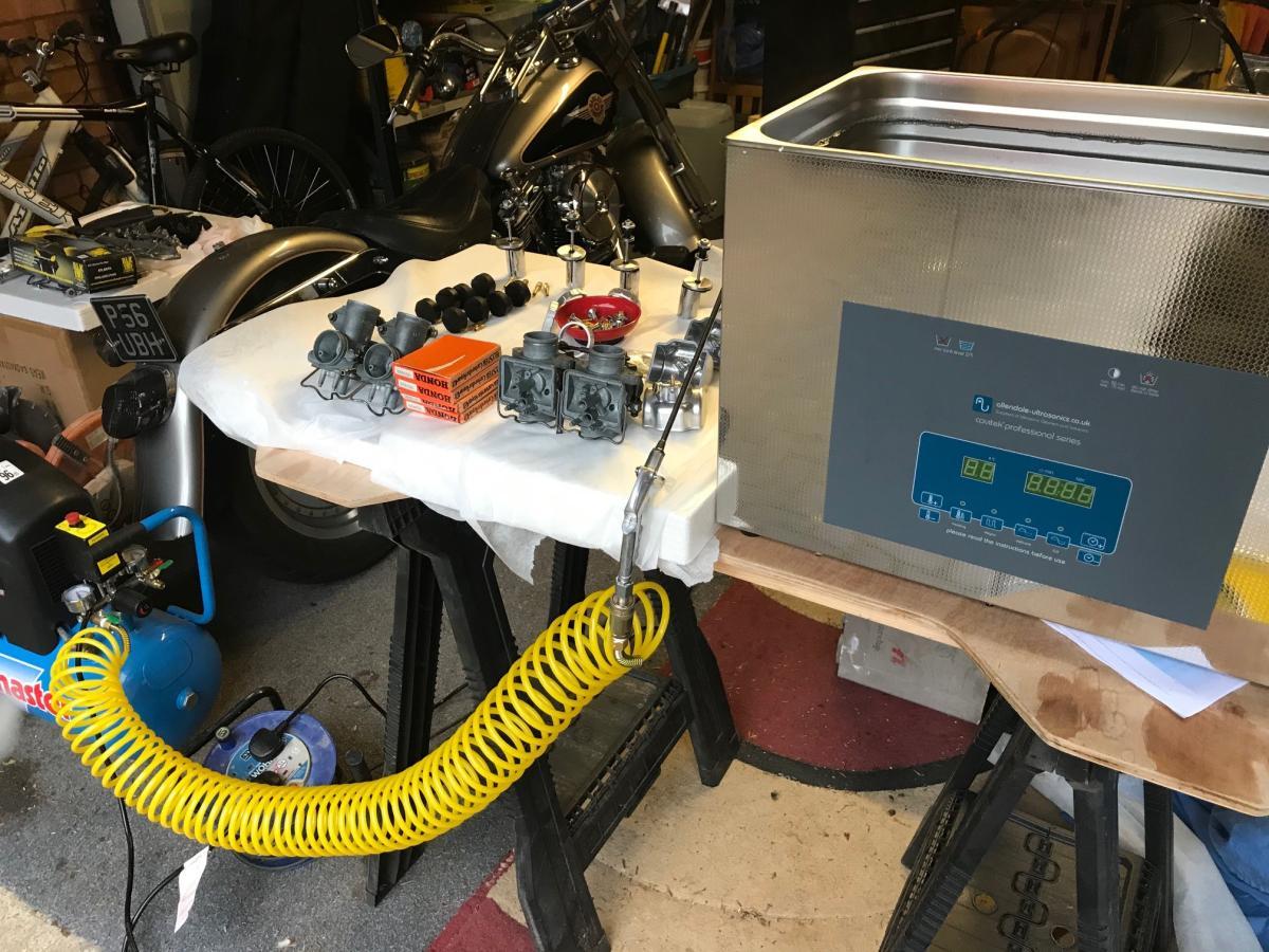

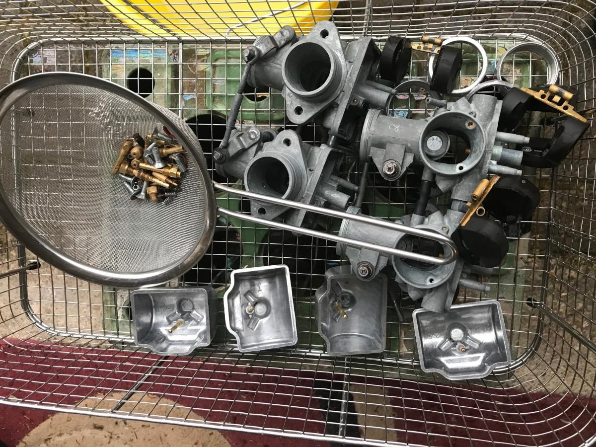

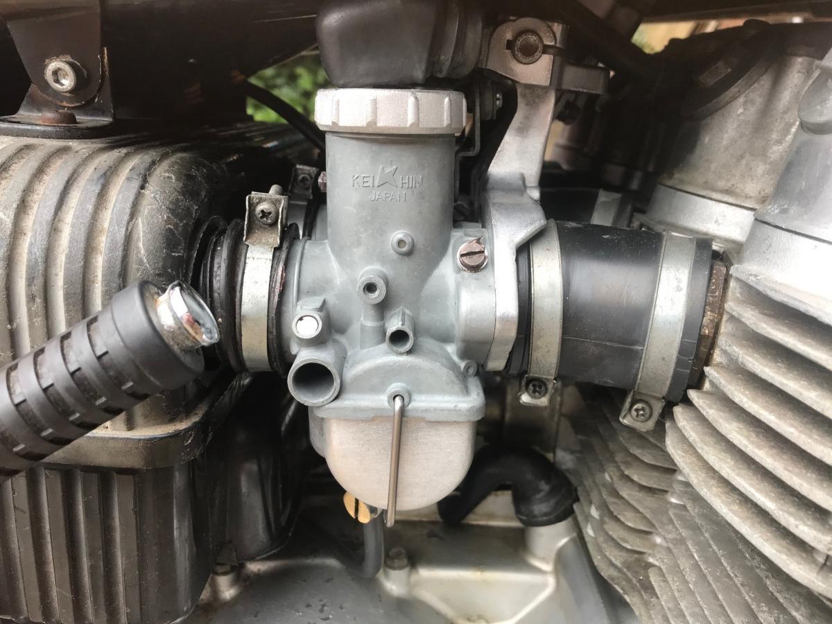

Getting to grips with it all okely dokely. stripped the Honda 750 carbs down. Got meself a  bike ramp in the end btw, dont half make things easier...Parts cleaned up lovely and blown dry

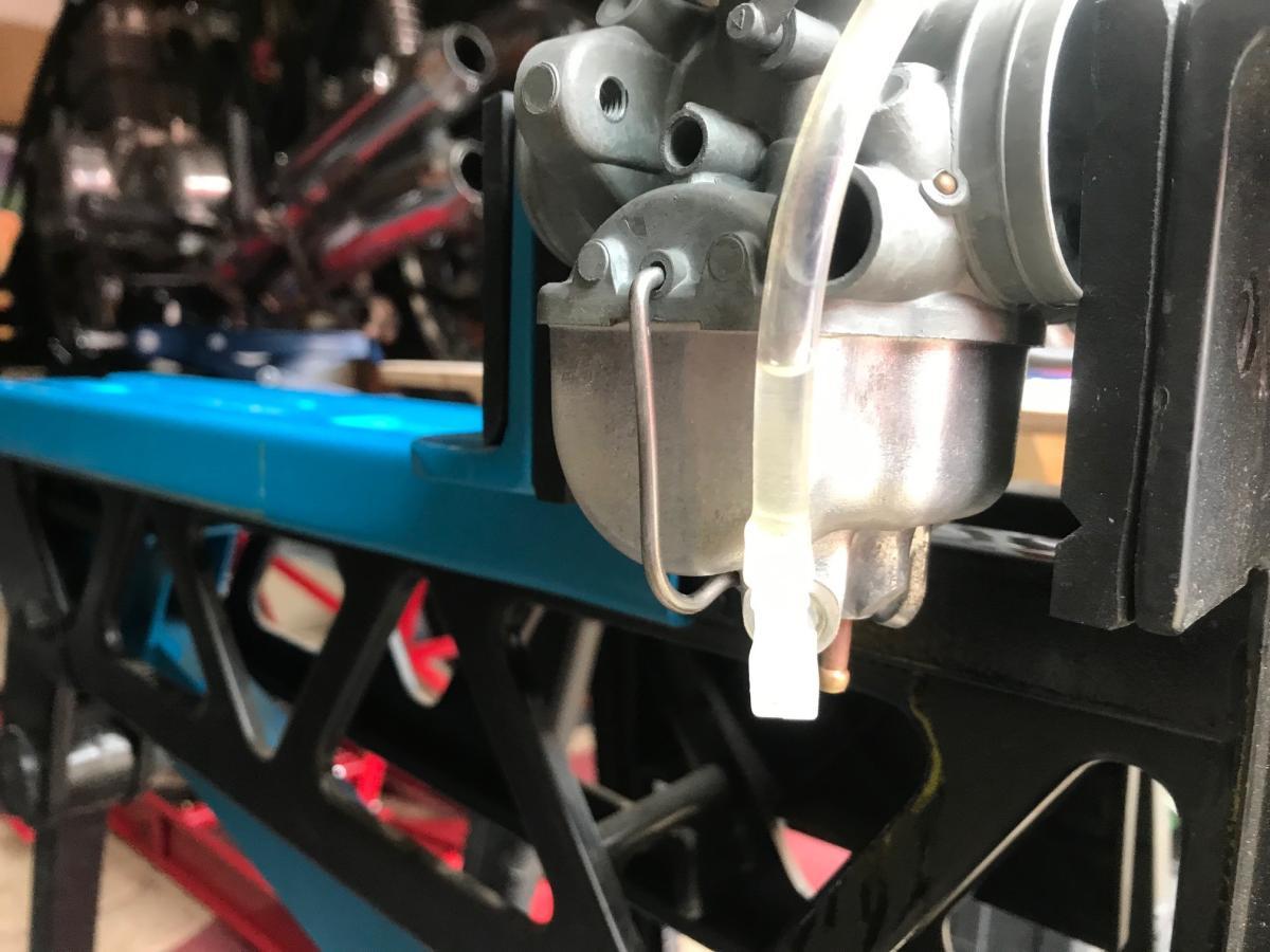

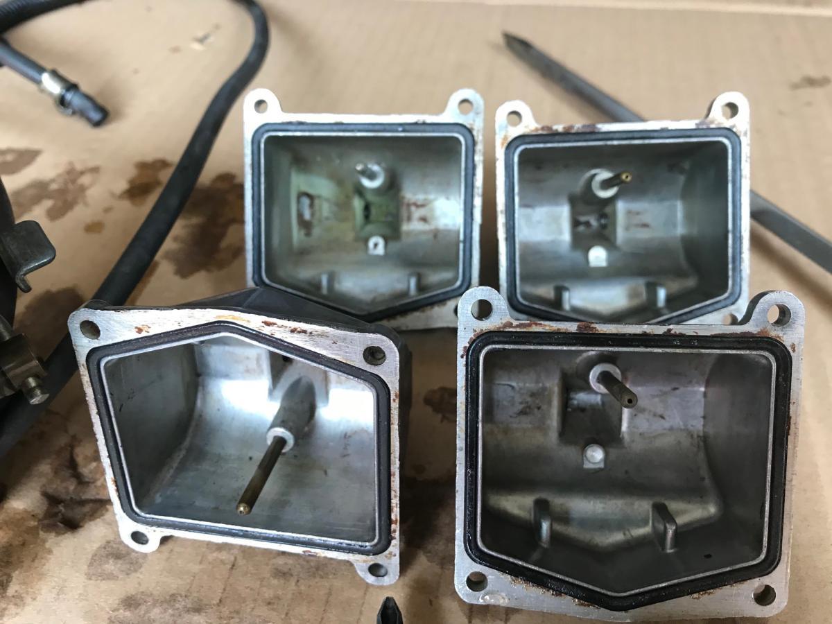

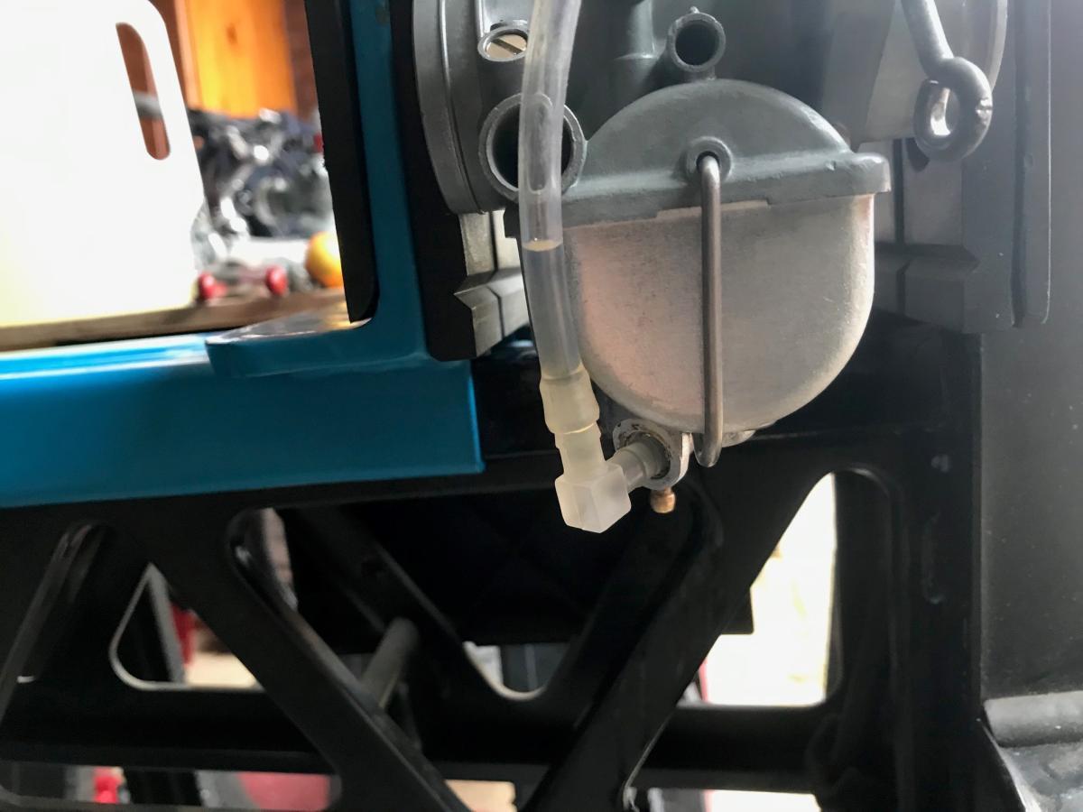

checked float heights both manually (carb at sixty degrees with tab just touching valve and then float height of 25mm set) and visually with clear tube before assembly. Do they look better or foccing what Smile

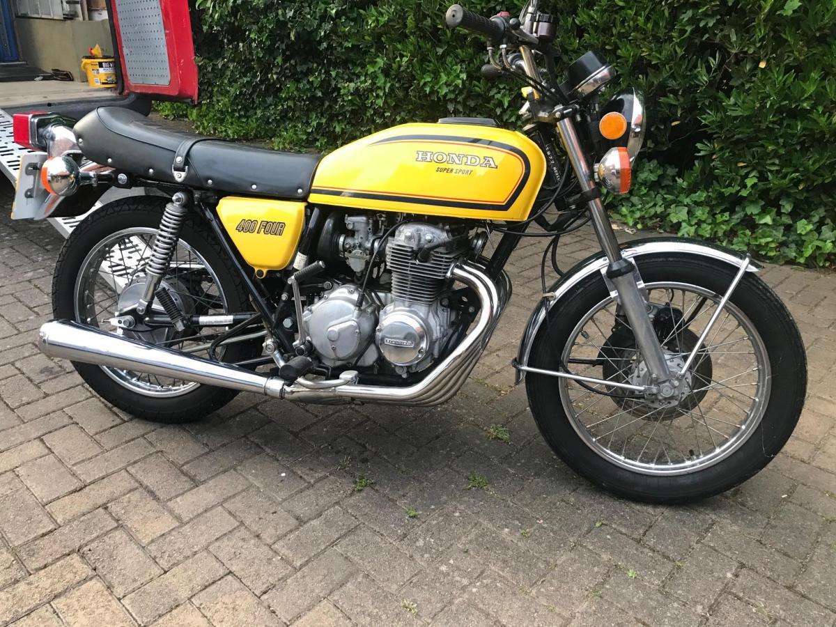

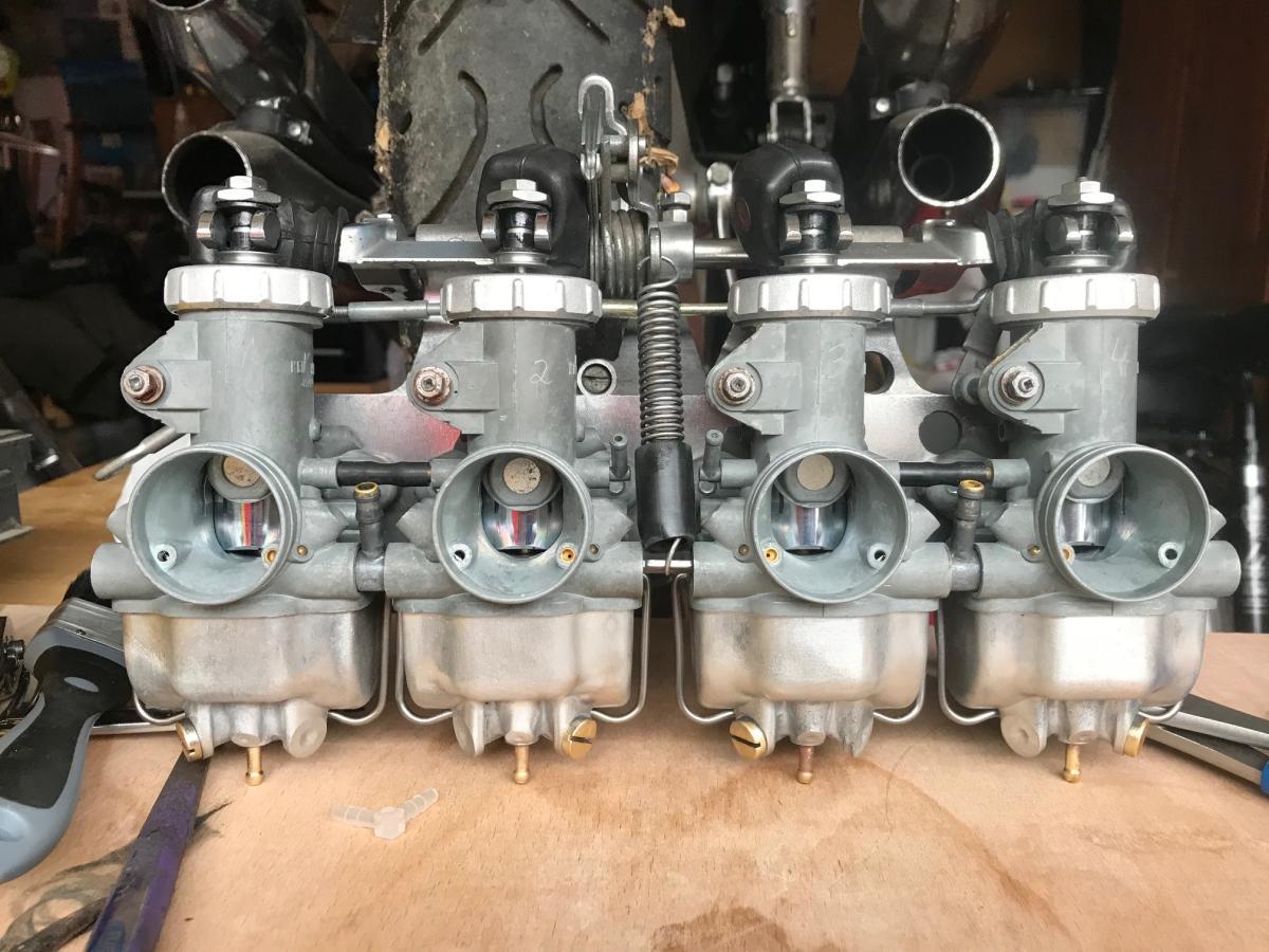

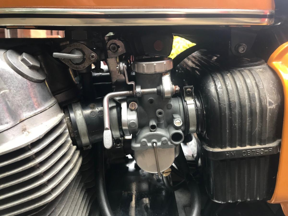

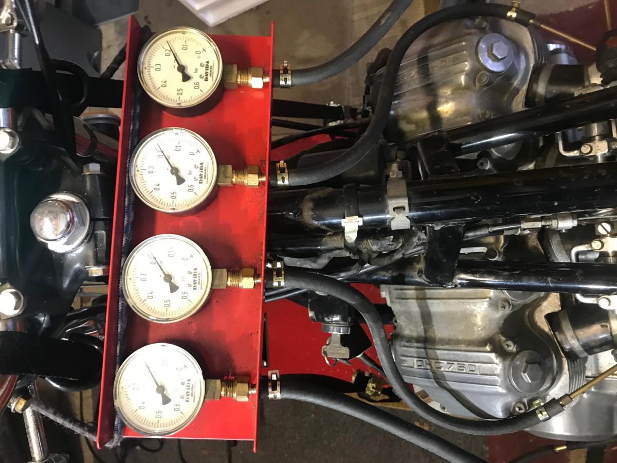

carbs back on and balanced. Bike hadnt run for eight years and now purrs like a kitten :thumbup

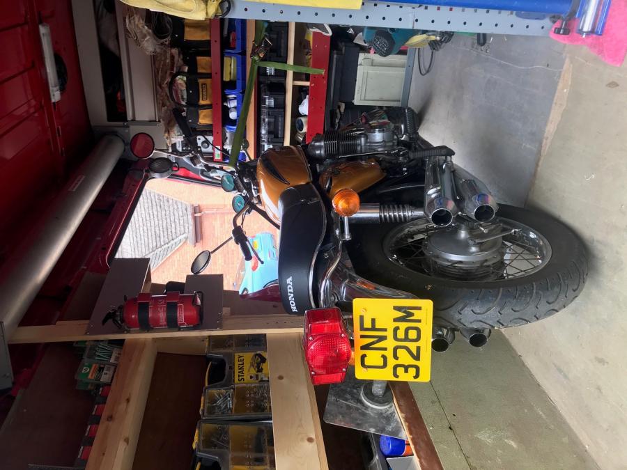

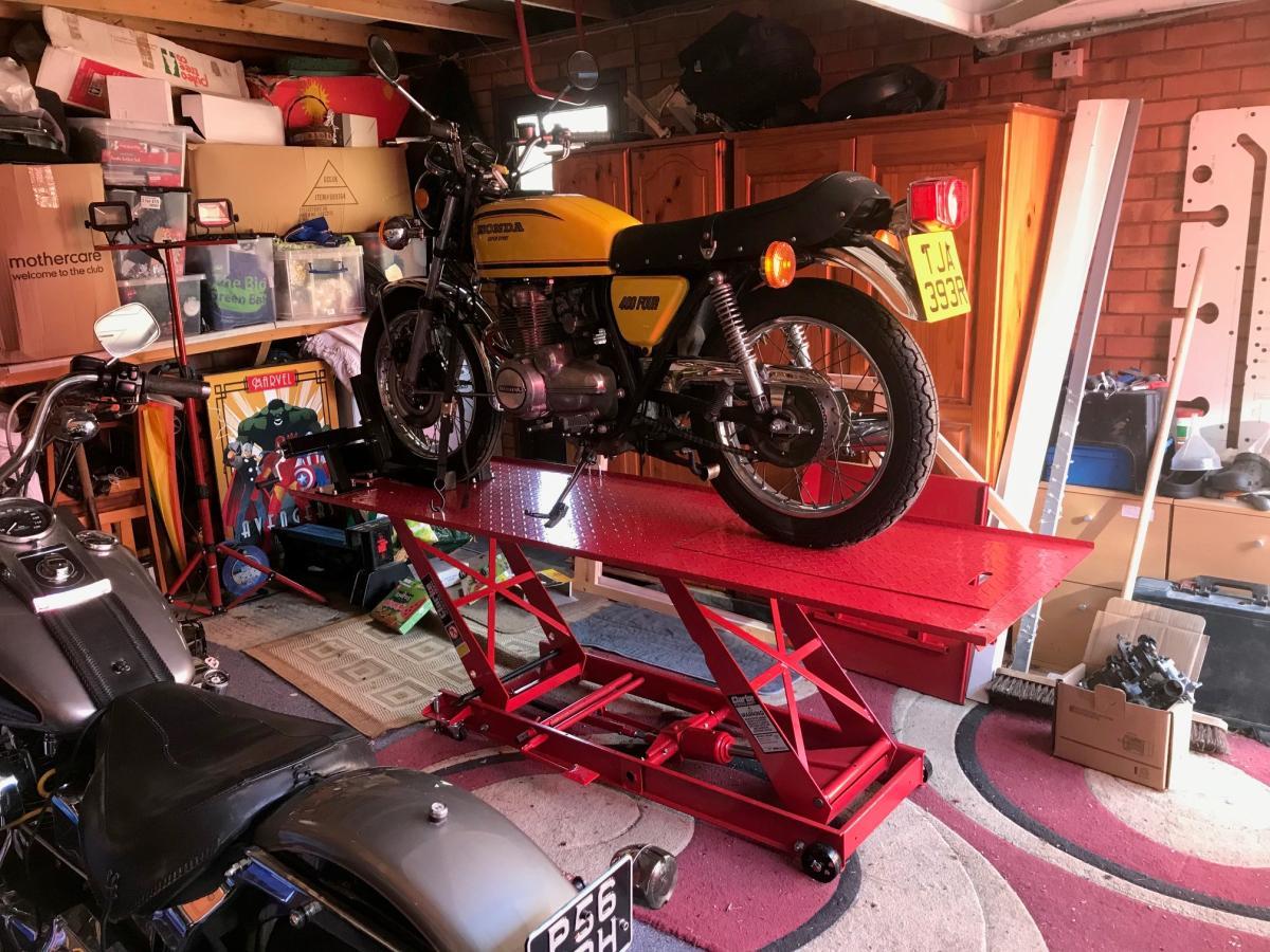

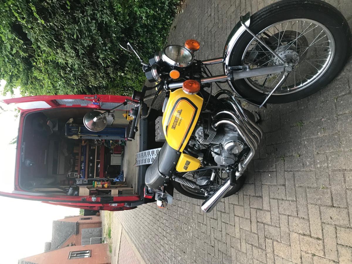

in the van and back to one very happy owner and pick up the next one. Im really looking forward to getting the 400 going again. I last rode this bike several years ago, and it was just like the ex owners all said...a mechanical little marvel, much nicer to ride than the 750.. Then the local bike shop fucked about with  the carbs (just before they went bust)and it hasnt run since. apparently he didnt even take them off so whatever he did wrong cant be too drastic. theres some gt380 carbs in the box to clean too

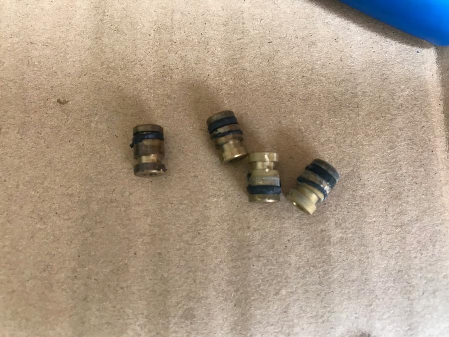

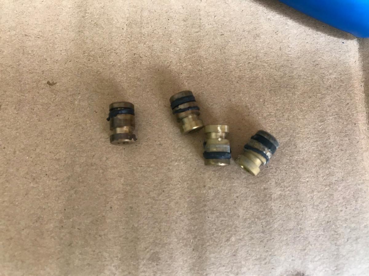

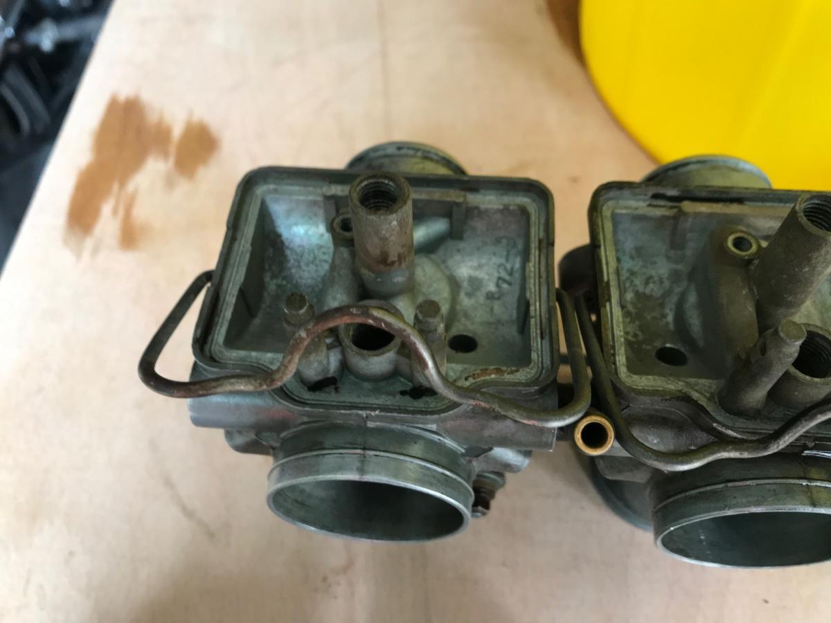

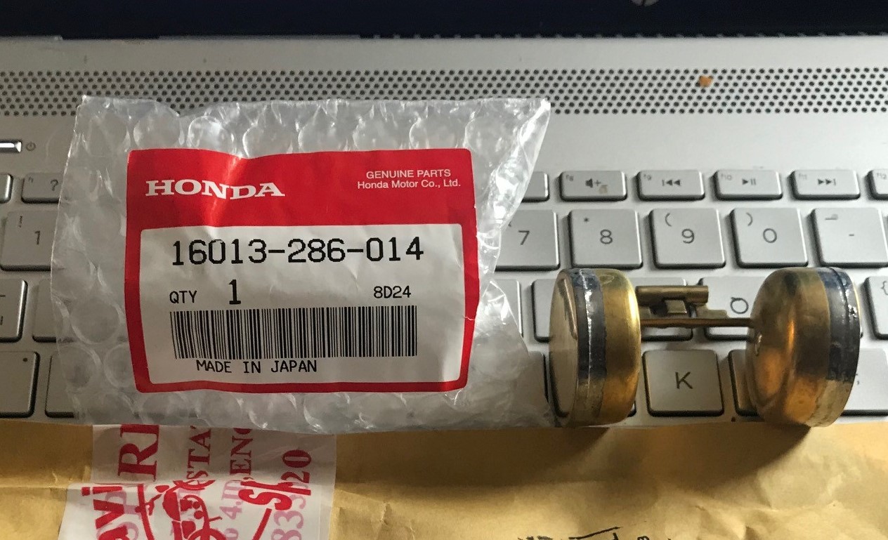

well, the drain screws in the float bowls were facing the wrong way, and the o rings around the main jets and float valve bodies were all focced. So, he'd dropped the float bowls in situ, then forced the new jets etc in blind with no o ring grease, guillotining the outer edge off so bady it looks like it has two o rings in some cases. The carb kits he got were cheapies, so Im going to get new o rings and refit the original Keihin stuff...bike only has 11,000 on it so they should be fine

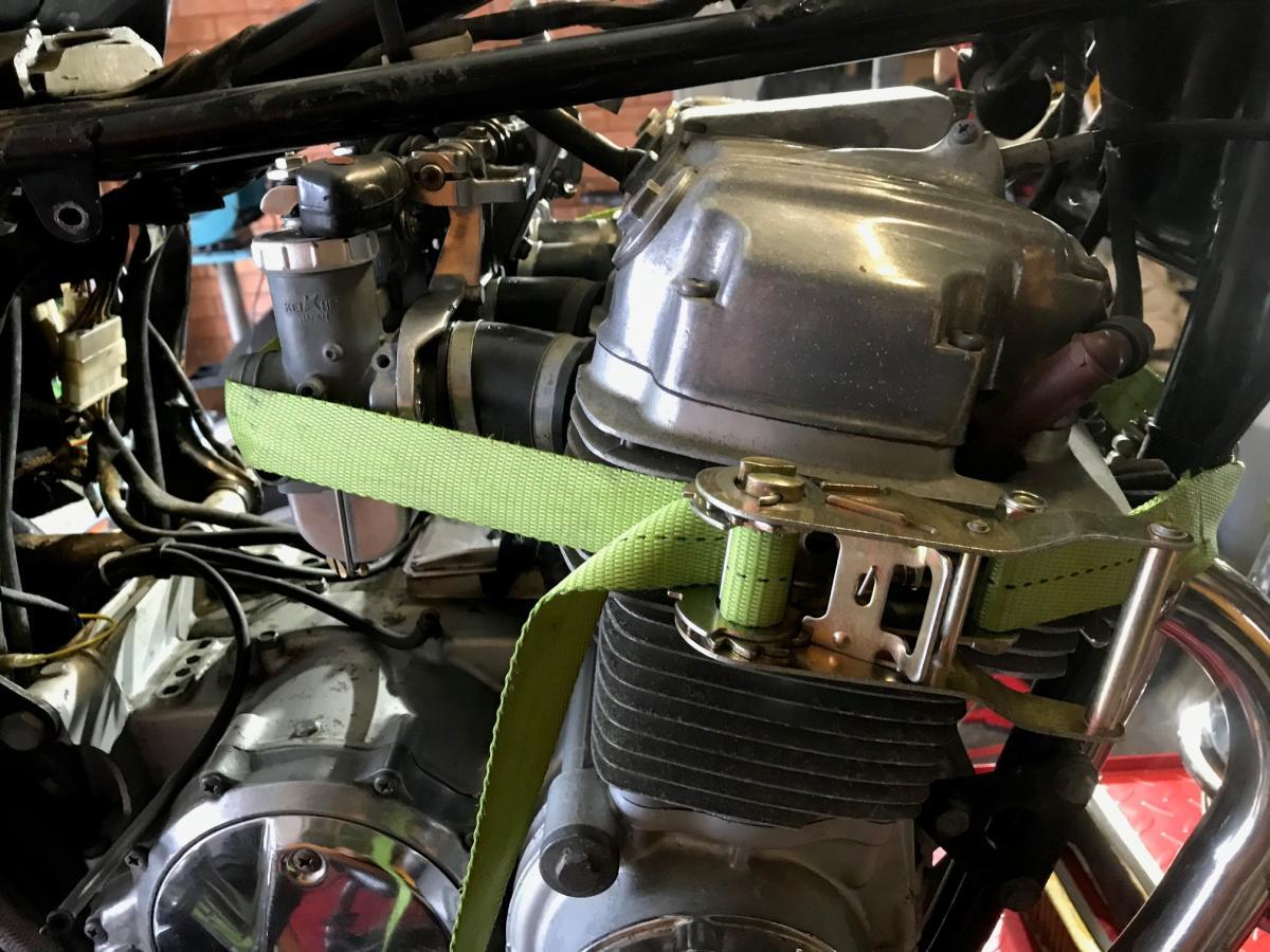

btw im thinking of going on 'dragons den' with the 'speshul tool' i've invented, developed after years and years of R and D, to 'gently and carefully' ease a four bank back into the stubs... Smile :lol Wink
I pulled me bloody back struggling to get me fazer thou ones in the last time I had em out, bugger that... Wink
Ogri, do you not use WD40 on the inlet manifolds and carb mouths to push the carbs back on. It has always worked for me, bottom in a little bit and then tilt top in then push them on. since WD40 is inflammable it will burn off when bike is started and helps seal the joints.
Are you happy with the Davidas?
Nice work dude :thumbup
Cheers VNA Smile
unfazed the davidas are the mutts right enough mate, ive always struggled with carb balancers, but these make it laughably easy. theres a second hand set on the  bay now, ive put a bid in coz if they go cheap enough ill have em as spares.
