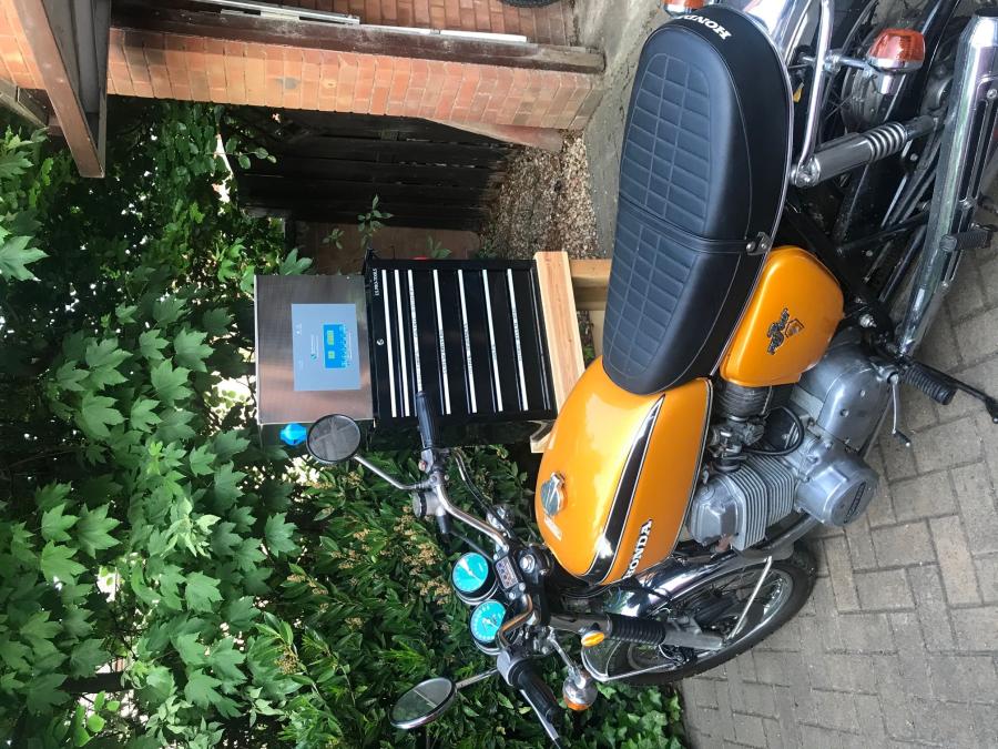

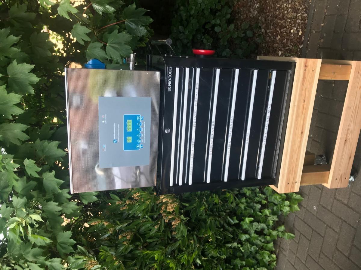

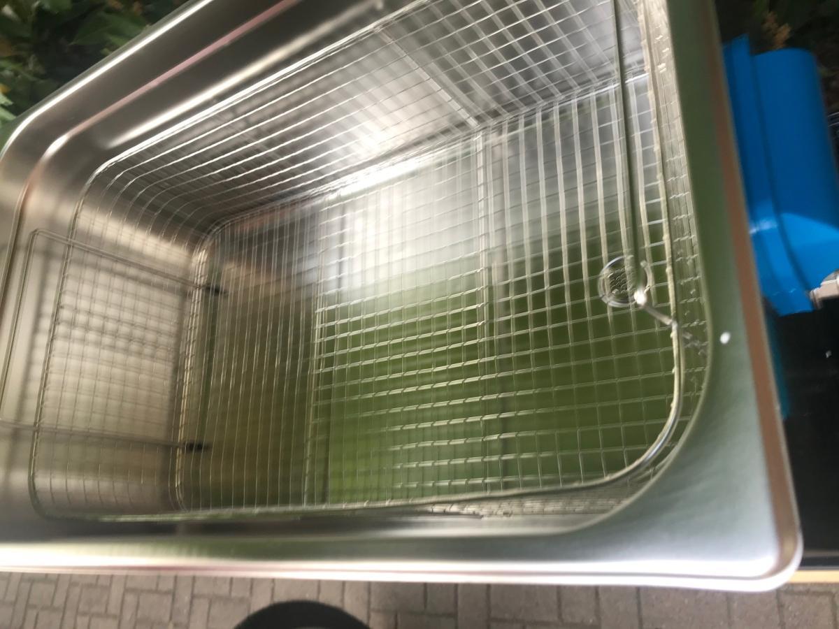

me mate kelv now has 38 seventies bikes, following his latest acquisition, a '74 gt750. Another mate has a lowly ten. I do bits for both of them, generally carbs and electrics to get them running half right. As such, and bearing in mind two of my own bikes have a four-bank of carbs, Ive bought an utrasonic cleaner. 27 litre, with fluid de gassing. The best part of 600 sovs with extra concentrate. But it makes sense. And six hundred quid compared to the the 90k kelv has spent on a shed full of, well, sheds, seems pretty good value. With the bits I do for Kelv and Chris alone it should hopefully pay for itself before the end of summer

Brilliant bit of kit to have. My carbs were cleaned in one of those when a couple of the pilot jets got bunged up. Ran as sweet as afterwards
21-05-20, 02:39 PM
Pretty much the only way to thoroughly clean carbs these days. I’ve got a smaller one that needs a double dip with doing half a bank of four at a time.

just waiting on fifty litres of demineralised de ionised water and the first patient goes under the spanners on sunday. Bike hasnt run since i picked it up for kelv eight years ago and he promptly stuck it in a shed. Going to clean the carbs, fit gen nos service kits and balance. hopefully he'll have a sweet running bike by the end of next week. ill detail the process on here, as Im gonna be offering a fifty quid service(including postage back out) to forum members, subject to the following.
1) carbs stripped by yourselves to whatever degree you want. Obviously thats float bowls off as a minumum. The cleaner is the best I could buy, and with the appropriate water, concentrate and degassing cycle should get into pilots, emulsion tubes etc if still fitted to the carb body. 2)carbs to be degreased by yourselves. The fluid makeup costs me thirty quid a tankfull, and as long as carbs are deshitted of crud etc, i should get between 10-20 half hour cycles. bear in mind im going to give each bank two full cycles, so i want to get at least ten banks of carbs cleaned before i havta drain off and change. 3) FOC-U members carbs only. im not running a business fellers, just wanting to give something back to the forum and those of you that frequent it lol. Even the foccing lefties and BMW riders :lol . Despite all the political bollox thats gets thrown about on here nowadays, we are all still mates with a common bond. Obviously the only doing it for you lot thingy has to be a me trusting you issue, but we are all fucking grown ups so i got no problem with that. I'll help any of you lot out, but not your foccing mates... :lol btw If required, ill send them back with sixteen a2 stainless carb bowl screws at whatever they cost me (ill buy some in bulk) so should be peanuts, but bear in mind they will be cap heads and will want greasing to prevent corrosive weld with the alu bodies

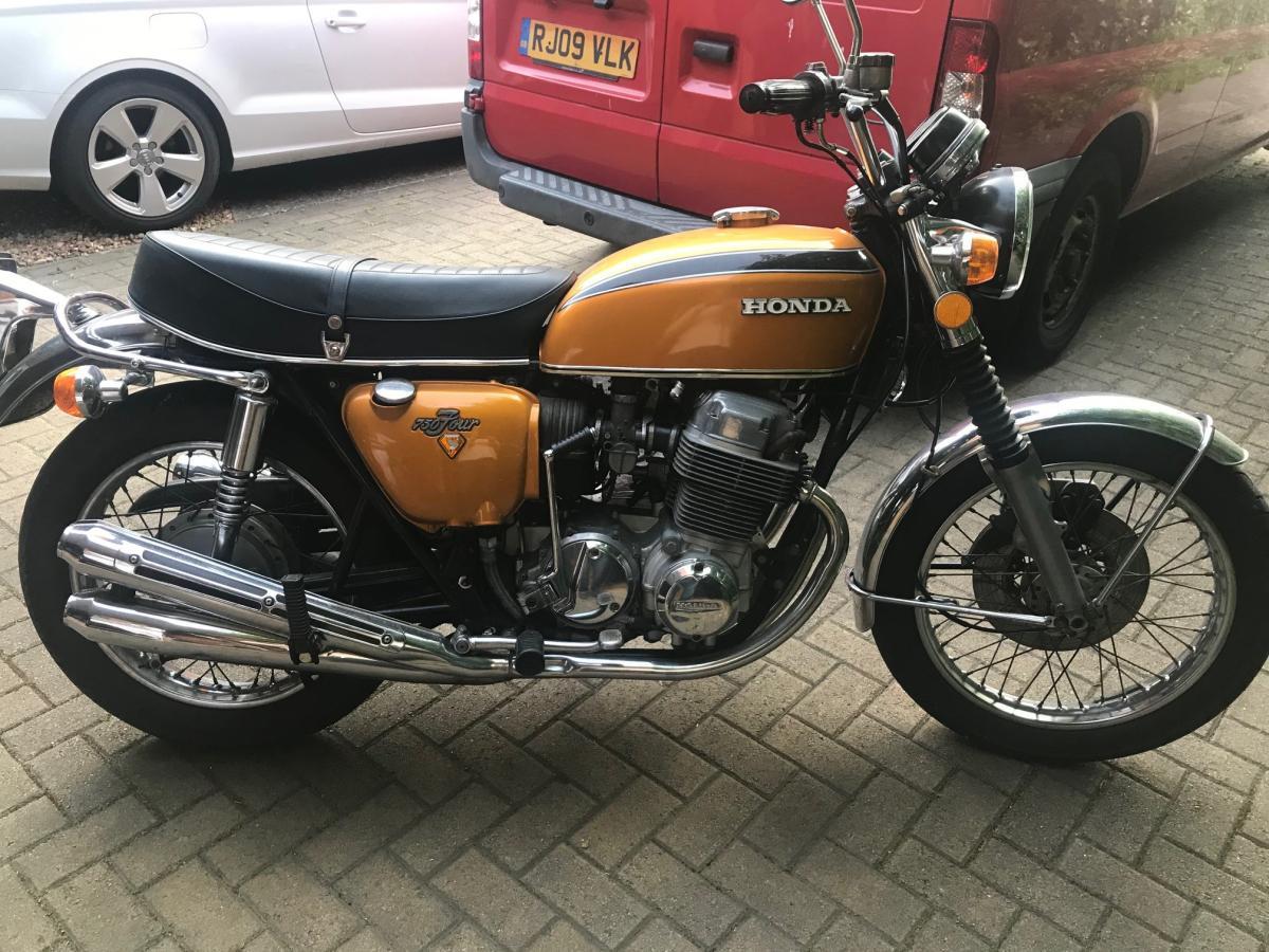

ill detail the work on this old bruiser. be nice to bring it back to life really...
27-05-20, 01:25 PM
That CB750 is beautiful, bought a second hand one of a mate when I was 22 , loved it, and even a crap rider like me could get those exhausts scraping.
27-05-20, 01:28 PM
kelv has three of them (the other two are a red and a blue), and hasnt ridden one yet. Criminal really :'( :'( :'(
and yeah id like one. I mean the '72 z1 is the one with the ultimate kudos, but to me the cb was the grandad, and i had far more mates on them and cb400fours back in the day. It always seems the original everyman bike. be interesting to see how it feels riding it now :rolleyes :lol :lol

The ultrasonic cleaners worked wonders. I had a project XJR400 that hadn’t been on the road for over 10 years and ran awful. A dunk for a few hours got the pilot jets completely clean and ran like a Swiss watch with a rebuild kit. Unfortunately my idea of running a 400 didn’t really work out as found it a bit too small so sold it on. Since then had mower carbs and it’s never failed.
27-05-20, 02:19 PM
Oh, forgot to say that coffee machine filter papers can be used to get some life out of your solution ?
