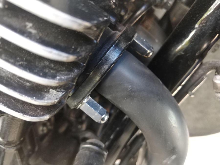

Oops! I'd already bought them. No worries if they're crap I'll buy something else but I thought for the sake of 3 quid, they were worth a look.
Finally arrived today. They don't look too bad on.
