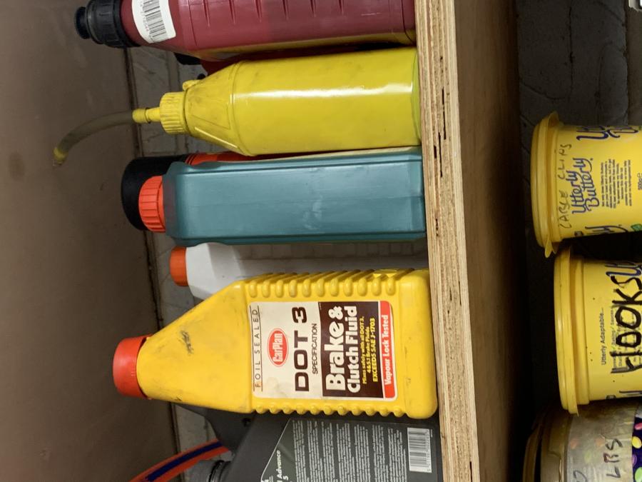

Only the good stuff for me lads ?
(01-04-20, 07:48 PM)Trebus link Wrote: Only the good stuff for me lads ?
Exp April 1973  :lol
It actually came from a garage clearance from my a deceased family member. Unopened tub, no water and therefore perfectly fit for purpose. No boiling so far. DOT 4 and 5.1 can be saved for the next century ?
