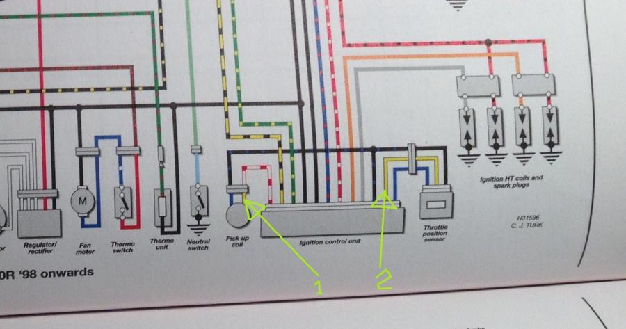

I've wired the pick up wire to the yellow as pic do you think this is correct ?
Thanks
Andy.
I don’t think that’s right, the TPS won’t be involved. The gear indicator has to do some arithmetic using the speed of the bike and engine revs, so it’ll be the Red/White one from the pickup coil and either the White or Blue/Yellow from the front wheel speedo sensor (not sure which of those has the pulses).

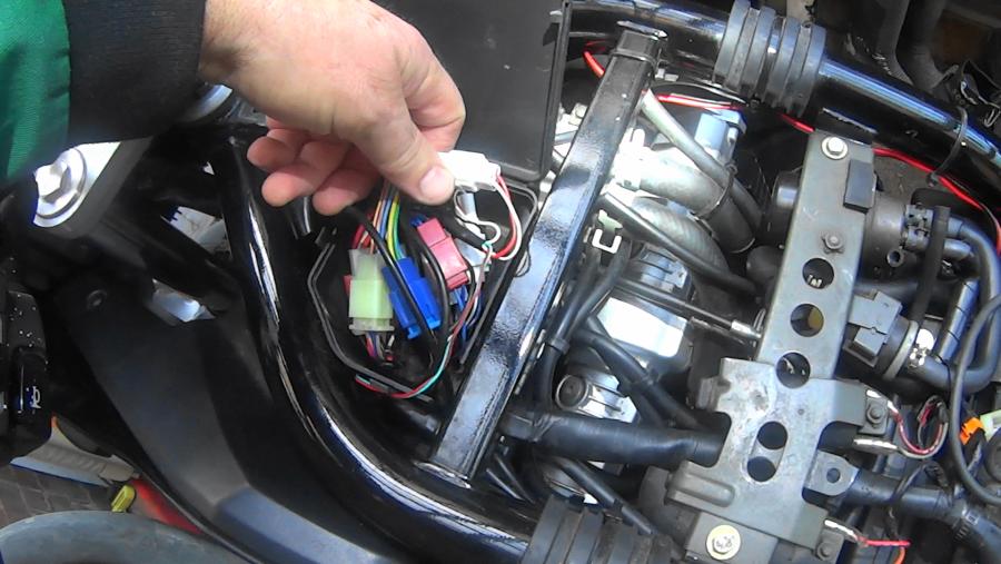

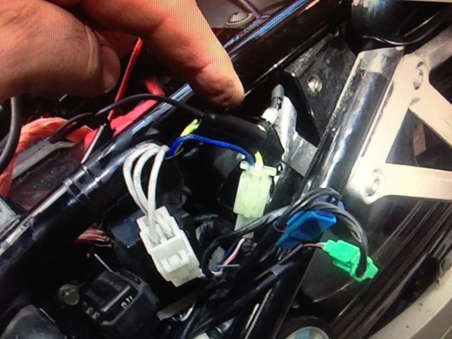

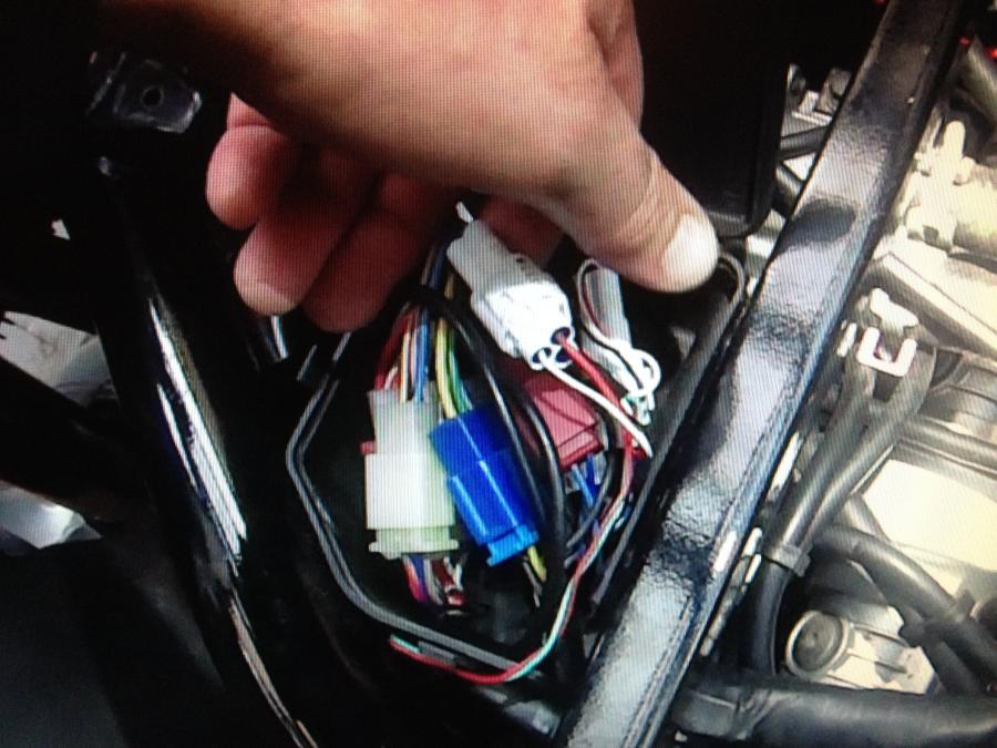

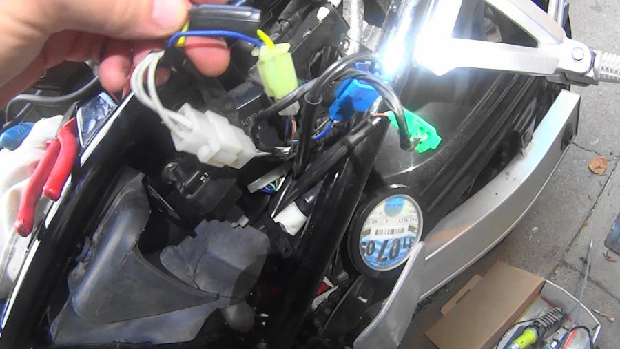

These pics are where I joined in as the wire changes from red/white to yellow at the connector block from the pick up coil
and the other end under the tank has the white connectors plugging in between the original  white connectors. Do you think that's correct ?Cheers.
Can’t quite make out enough detail in those photos, there’s weird patterning over them almost like they’ve been photographed off another screen.
I think the engine pickup one is correct and the second shot looks as if the triangular connector has the right colours to be the speedo sensor. Oddly, the Yamaha diagram shows White, Blue, Black going to White, Blue/Yellow, Black/Blue… looking at an old sensor I have it actually has Red, White, Black wires coming from it which looks (I think) like what you have there. I’d expect the white wire to be the one with the wanted pulses, but maybe someone else can confirm.

[color=rgb(51, 51, 51)]Yes sorry about the quality of the pics they were from pc screen so did 2 more a bit clearer hopefully.[/color]
