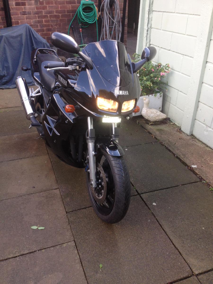

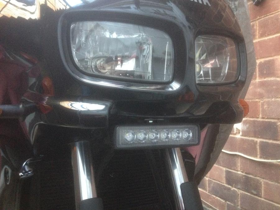

Have you thought of a sidelight upgrade?
Before: [Image: 76907131_10162810912140551_6088529038761...e=5E78AE42]
After :
[Image: 78166493_10162810912485551_8977705228988...e=5E3FC5EE]
And a linky https://www.ebay.co.uk/itm/273961011231?ul_noapp=true
