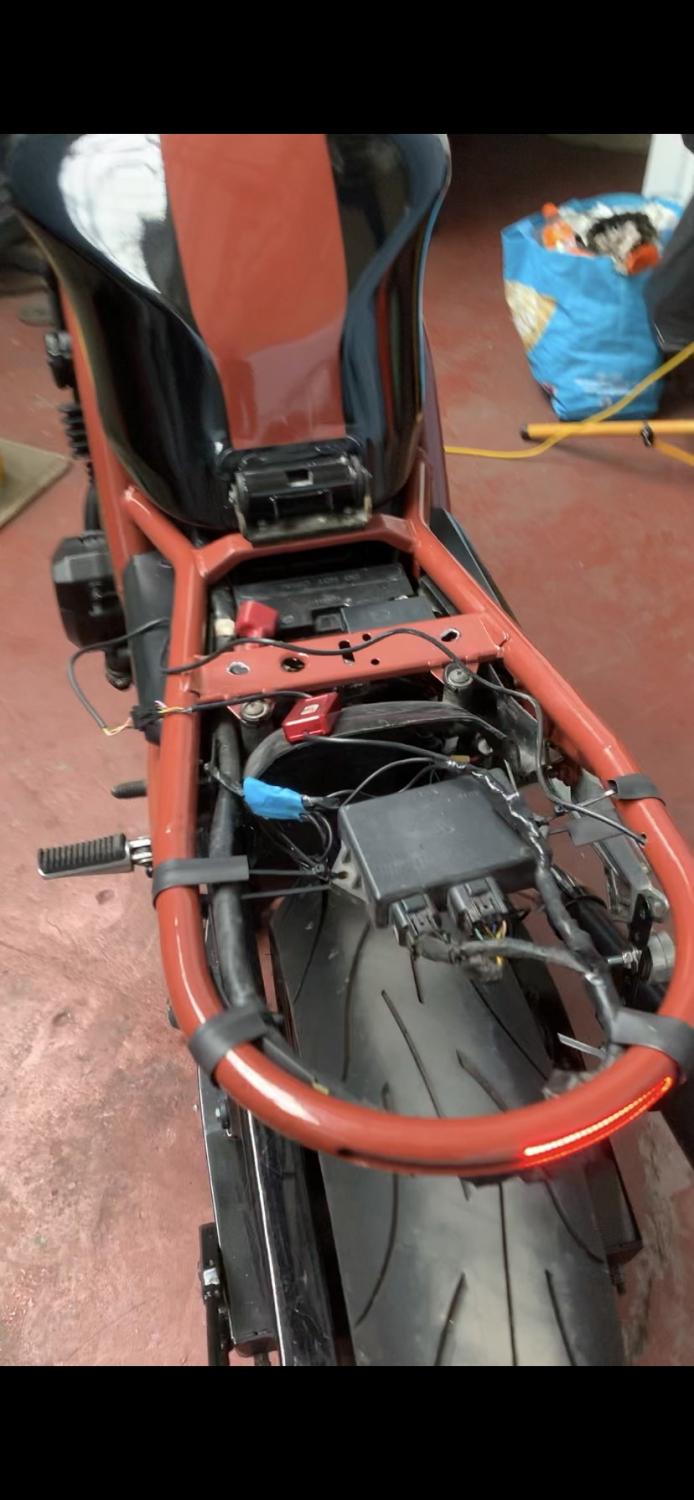

Next issue I have as the bike rear end is custom there effectively is no location for the ECU CDI to sit without being open to the elements under the seat pan (flat plate seat) has anybody relocated the ECU CDI to another position without having to open the loom to maximise length?
See attached image of where it could be positioned and create a tray; issue is then wheel clearance and tray attachment to the bike? (yes this should all have been factored in earlier however seat pan sits flush to the frame tube which wasn't planned)  :'(
You need the wiring to be reliable so I'd be more inclined leave it alone and change the seat to accommodate it.
You could cut into the seat hump from underneath seal the internal of the hump and put it in there with a flap for access or seat removal.
