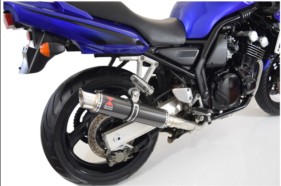

The wishlist : I like the look of it, perhaps a little stubby at 320mm but they don't have a longer one. Again, I'm not about announcing my presence to the whole neighbouhood.

I have a Black Widow silencer, which has been on for about a year now. A stubby 230mm (carbon fibre/titanium), so not the noise/look you are wanting.
BUT... it still looks like new, build quality is superb, plus they have great customer service.
Has a removable baffle (same for the other size Cans), which offers 3 noise levels. IN = most noise reduction, OUT = loudest option least restrictive, or you cut off the end piece of the baffle, for an intermediate sound level. So you can decide what sound/noise level you like most. Remember IN for the MOT!  Big Grin
